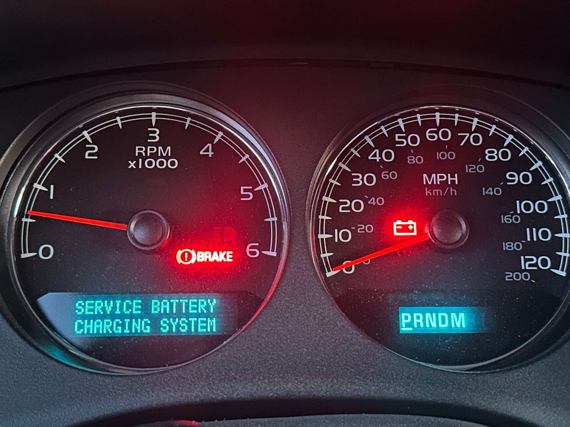

I had an issue where the service battery charging system would come on intermittently. I have a good battery, alternator is good, replaces the BMS and checked and cleaned all the ground cables.
I finally located the draw down to fuse #42 in the engine bay of my 2009 Chevy Suburban LTZ which turns out to be a 15A fuse for the RDO (radio).
I need assistance to locate the wiring diagram from the fuse block to the radio so I can locate the issue. Does anyone have information on where I can locate the schematic?
TIA

Update, it’s not the fuse for the battery.
while moving wires around I must have moved a wire away from a short possible at the dash fuse box for a while but the battery warning message came back and continues to come back intermittently.
Any help on a schematic for wire would be helpful.
