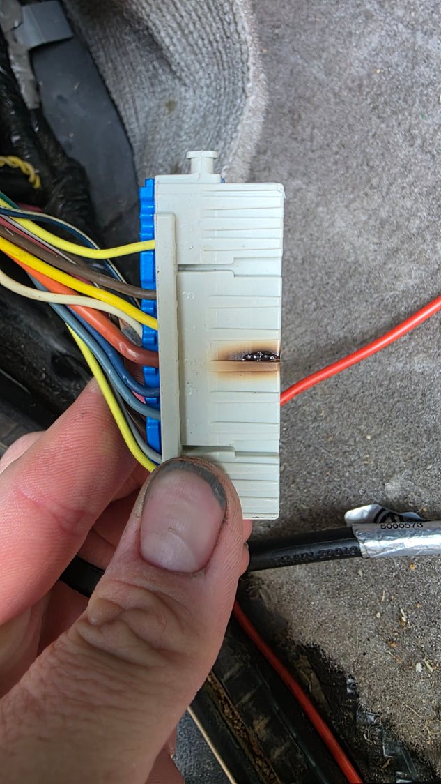

Wanted to update this in case someone ran into the same problem. Turns out I had multiple issues. 1. The rear ac module failed, replaced it with the updated one. Part number 15185966. 2. The blend door actuator failed as well. Tried replacing with a murray brand. It failed within minutes. Take my advice and just buy the ac delco brand. That was an additional hour of trouble shooting that wasnt needed. 3. I swapped in 3 different blower motor resistors and could not get the blower motor to turn on. I could hot wire it with a lawn mower battery and it would work. Turns out there was a short in the connector at the drivers side kick panel that tried to catch the truck on fire. This was causing a massive drop in voltage to the blower. Sometimes it was fine and sometimes it only had 5v. I decided to just bypass it. BTW RU631 is the correct part number for the resistor if you have the auto climate control. You do have to splice in a new harness. Hope this helps someone in the future.
