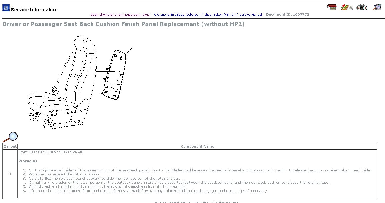

Hello All,
New guy here. Just picked up a 08 Subruban LTZ. Overall good shape but it looks like the kids had their way with it in some area's...LOL
The pocket behind the passenger seat needs to be reattached behind the plastic cover. I have been poking around looking for instructions on how to remove the cover but I haven't had any luck.
Is anyone aware of a post with PICS or a how to?
Many thanks in advance,
Mike
Last edited by in2pro; Dec 17, 2011 at 12:52 PM. Reason: thread moved by moderator to Tahoe and Suburban area for more exposure
Old Dec 17, 2011 | 1:00 PM
Likes: 48
Welcome to the forum...
see if this helps any...

That attached thumbnail just about covers it. It just doesn't tell you how hard the bottom clips are to get loose. Do a search on installing front headrest DVD players which is available as a sticky some where that has a lot of pictures and will be a big help.

Thanks guys I will give it a shot
Old Dec 18, 2011 | 7:36 PM
mikeatl's Avatar
Joined: Dec 2011
Posts: 11
All set, thanks again.
