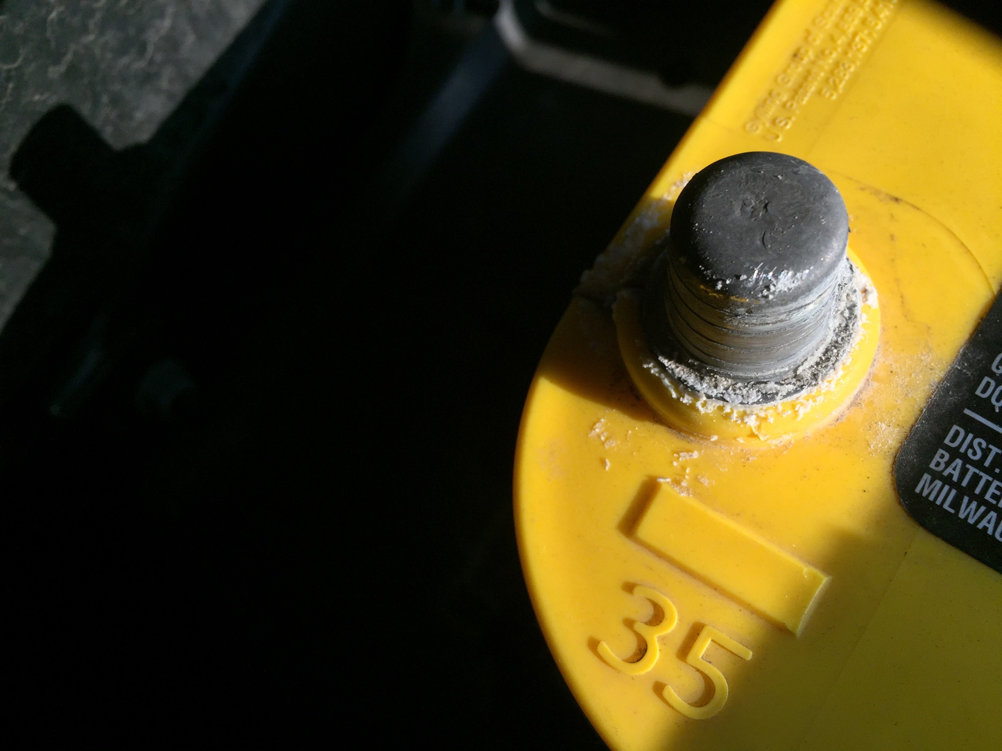

So today I was working on my 07 Tahoe LTZ, I replaced the front impact airbag sensor. I disconnected my neg. battery cables. I have dual batteries. Then I notice there seems be to a crack in the battery case leading to the neg. battery terminal. And I can see acid or electrolyte(?) that has seeped out and dried up. I also notice that there is some subtle bulging on top of the battery but not sure if that has been there ever since I installed it 6 years ago (which I doubt, lol) or if this battery is on a slow pace to expand out of its case.
I installed these dual batts back in December of 2010, and have had no issue at all. I know popular opinion will be to replace it! lol! But that means I have to replace the other battery as well. Both batts are Optima yellow tops, D35 is the model number.
So what do you guys think?

I have dual bats also and I learned my lesson but good, when one goes bad you must replace both at the same time. Mt hellish nightmare never ended until I replaced both. Would I replace the one you posted? If it is leaking OR vented yes it will die

Save yourself from unexpected breakdown, replace the batteries. Good luck

I knew it! LOL! jk! I plan on buying a set of Odyssey 48-720's. I google searched the cracked cased in my optima and see that a few other people have had this same issue. But I may check Costco first, to see if they have and AGM batts. Last I saw Costco had Interstate batts but were not AGM.
