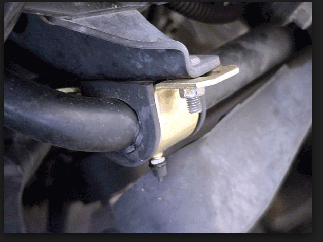

Sledgehammer hits all the spots, however the squeak you may be hearing could be the front sway bar/anti-roll bar bushings... they are rubber and when cold will creak and squeak... hit them with some spray silicone lube...
Some have lube points( aftermarket) but most factory ones do not... the attached picture is an example, it does have a lube fitting on it...
