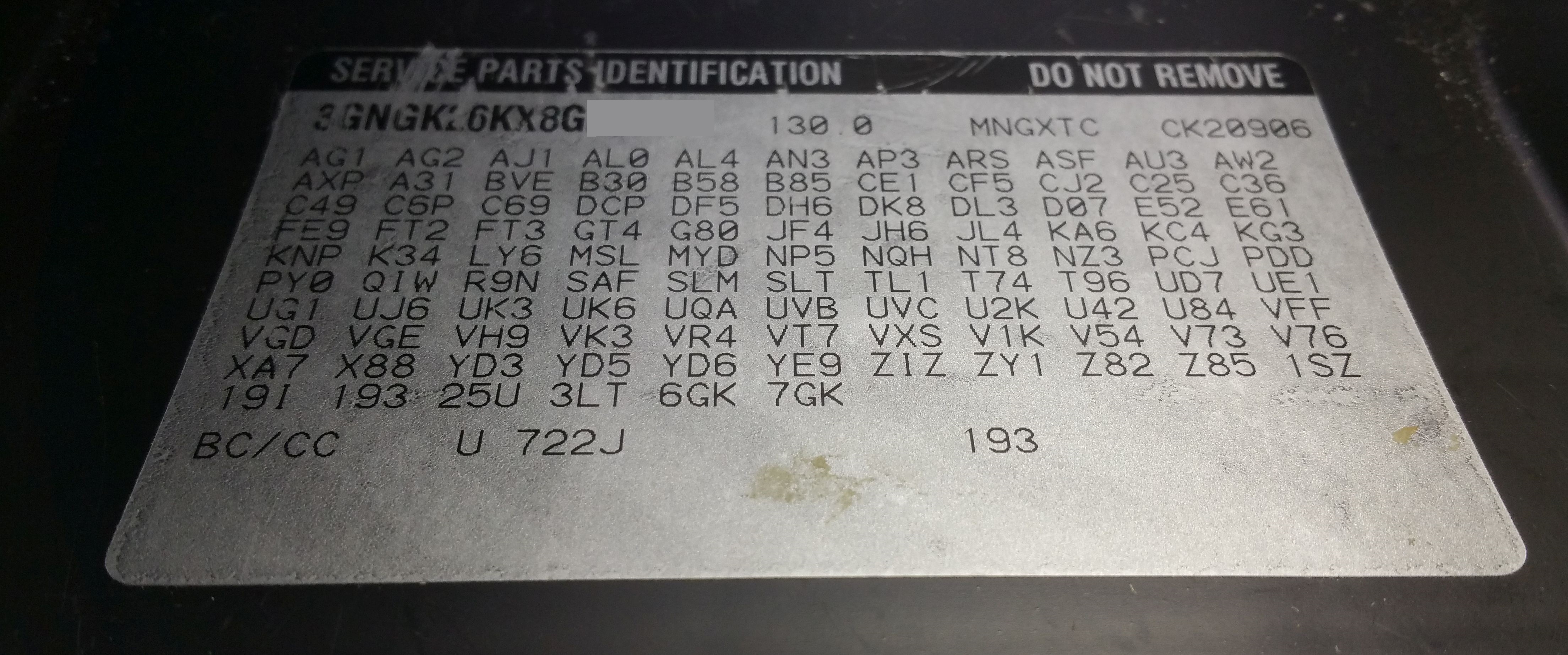

Yes, these things can easily go over 200k miles, but once you're over 150k, you're starting to get into "money pit" territory. Fuel pump, wheel hubs/bearings, costly repairs in general can become more frequent. It all depends on the maintenance history. I'd rather buy a truck with lower mileage and take good care of it, than buy a higher-mileage truck and "hope" that the previous owner did the proper maintenance. I bought my Suburban at 100k, and it's now at 192k six years later and is flawlessly reliable and has only cost me about $300 in repairs during those six years.
Regards to towing rating - according to page 4-53 of the 2009 Suburban owners manual, the specs are:
1500 Series 4WD Long Wheel Base
5.3L V8 3.42 5,400 lbs (2 449 kg)
5.3L V8 K5L HD Cooling Pkg 3.42 7,900 lbs (3 583 kg)
So look in the glove box for the RPO sticker (labeled "Service Parts Identification"), and see if it has code K5L on it.
Here's what it will look like - this is the sticker for my truck...
Thanks, that's exactly what I needed.
