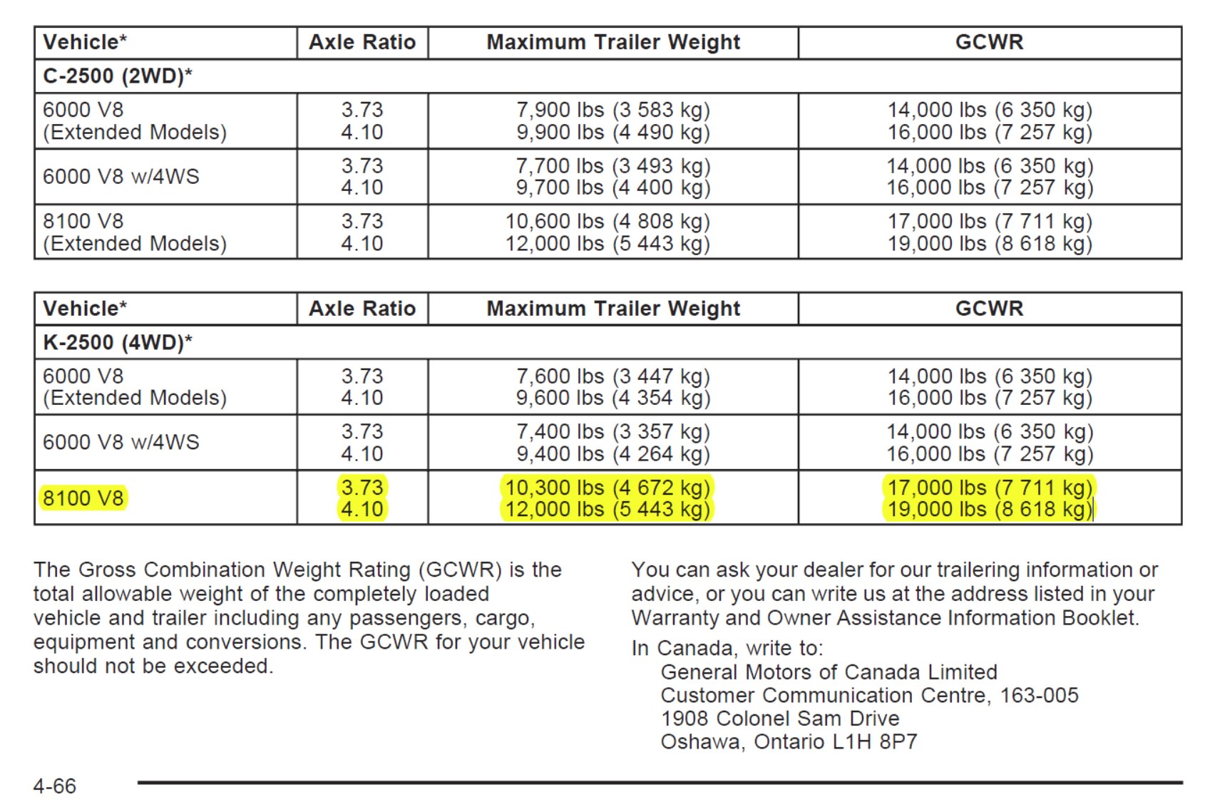

It's not just a monster towing vehicle. You own the undisputed, king of the hill, most capable towing SUV ever made by any company. Wanna sell it?
I probably wouldn't max it out completely, since the lift and bigger tires will increase stresses on the suspension and drivetrain, but depending on your axle ratio, your GCWR is either 17k or 19k. A 10k gvw trailer should be no problem at all.

From your owners manual:
A strong tow vehicle indeed. I have a 2004 Suburban, 8.1/4.10 with 33 inch tires. I can tell you though, those 35 inch tall tires are really going to hurt your towing performance, particularly if you have the 3.73 axle. Since the factory tire size was 30.5 inches, your 35s will effectively reduce a 3.73 ratio to 3.25, and a 4.10 to 3.57. Not to mention the fact that the tires and wheels are heavier which hurts acceleration and braking.
With factory tires and 3.73s the tow rating was 10,300lbs. This is with a full tank of gas and 150lb driver. Any additional payload you carry in the suburban reduces the tow rating accordingly. IMO, if you want to keep the 35s, you would need to change to 4.56 or 4.88 gears to get back close to the factory ratings.
Bottom line, a 10,400 GVWR trailer is too heavy for your truck with 35s and 3.73s, and probably marginal with the 35s and 4.10.
