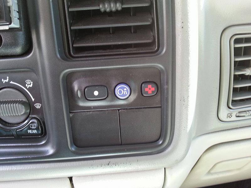

Hi in my 2000 chevy suburban have installed aftermarket radio.
My problem is in the car have some kind of emergency button sepaprately form the radio.
when i start the car the radio is working but a couple seconds later just silence. if I push the Red cross button, sometime the sound come back and I can listening the radio for the next stop.
But sometime I try to push the button but nothing happen. just silence. like I can listening music when the car want me to listen.
I tried to disconnect these buttons because I do not use them but just silence.
The radio is brand new and it was tested with one another car and the radio is work perfect.
I was checking the owners book but there is nothing about this buttons.
Anyone some idea how to disable these buttons or how to solve my problem?
Or some explanations what is exactly these buttons?
Thanks a lot.
Thanks a lot

the radio is wired in wrong.
the buttons are for the onstar system. a normally working system should mute the radio when the onstar button is pressed.

Thanks the answer.
the connector sold is connector for chevy trucks/suv. the connector is perfect fit to the car connector.
The connector wire colored originaly by the manufacutrer.
the radio connector wires is the same colors like the car connector.
All the wires connected to the same color wire.
all the wires soldered and connected as well .
if I push the button once a time evrithing works perfect like it should, the next time it is not.
There are 3 other connectors behind the radio what i not using it. / I guess is the casette player and the back seat contorl panel but there is no place to connect on aftermarket radio.
4 wire for the power the others is for the speakers
only one orange wire hanging by itself.
