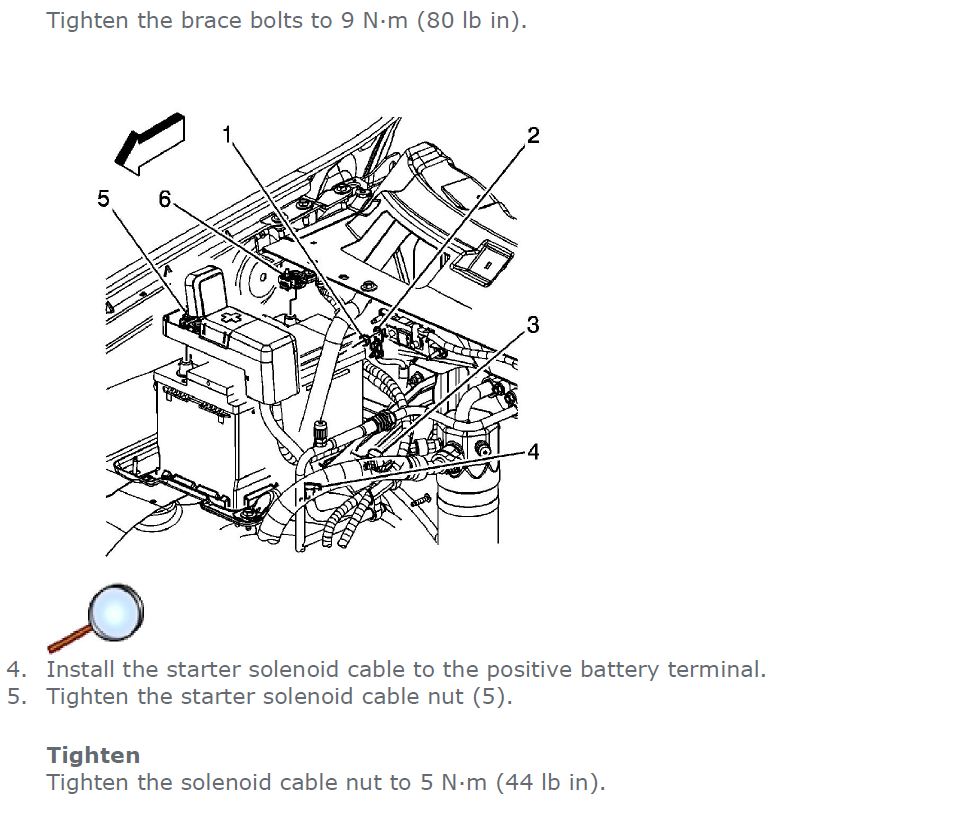

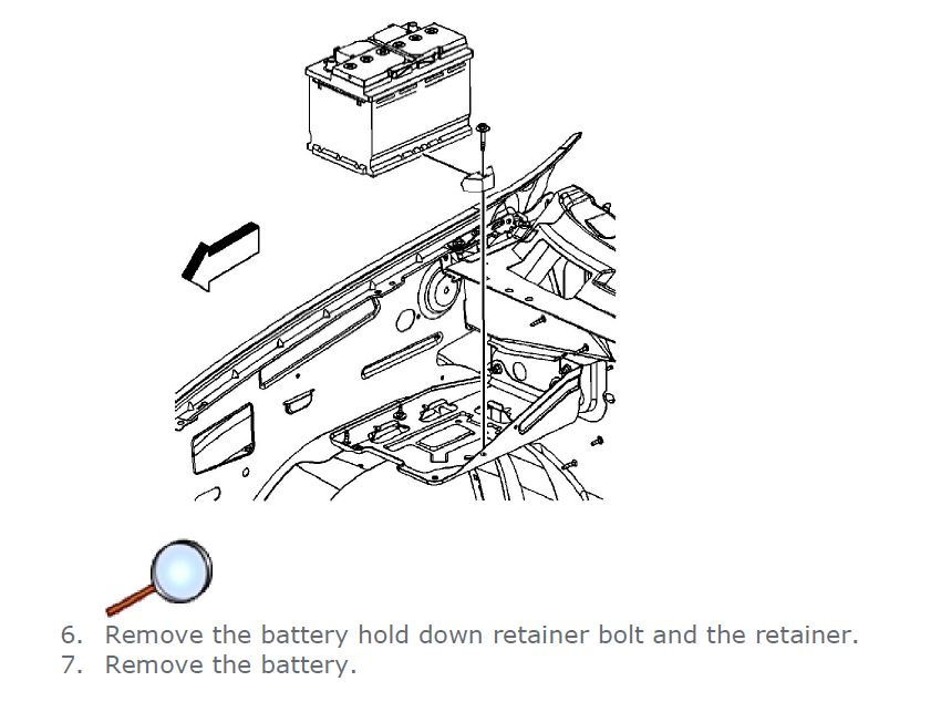

I'm going to have to get a new battery in my 2008 Tahoe. Looks like it's in a tight location. Any advice on changing it? And a good replacement battery? Thanks
Old Mar 1, 2013 | 9:34 AM
Likes: 48
You will need to remove the curved brace that is above the battery, you could try to wiggle it out but risk damage and shorting if you do...
You are going to hear plenty about going to an AGM battery... that is up to you and how much you want to spend...
I would go with the a name brand i.e. Interstate, AC Delco... I am not a fan of the Duralast just my opinion...
You will be limited to what will fit...
After you install the new battery and BEFORE you start:
Turn the key to start but do not crank for 1 minute...
The HVAC will go through a "learn" procedure, do not adj any AC settings while it is in learn... if you do you may find that the temp is inaccurate or that one side is hot while the other is cold...
Your throttle body may also go through a brief learn period also, so your idle may be higher after installing the new battery... drive normally preferably with some stop and go traffic...
Attached Thumbnails Battery Installing?-capture1.jpg   Battery Installing?-capture2.jpg   Battery Installing?-capture3.jpg
