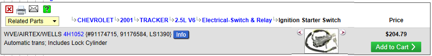

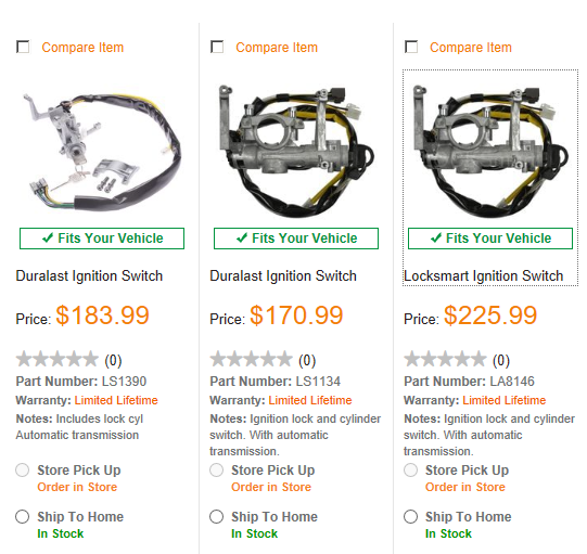

Good catch on the ignition switch. RockAuto replacements are about $200.
The switch and lock are one unit. New keys are included.

O'Reilly's did not have an ignition switch listed online but AutoZone did so that's another option.
