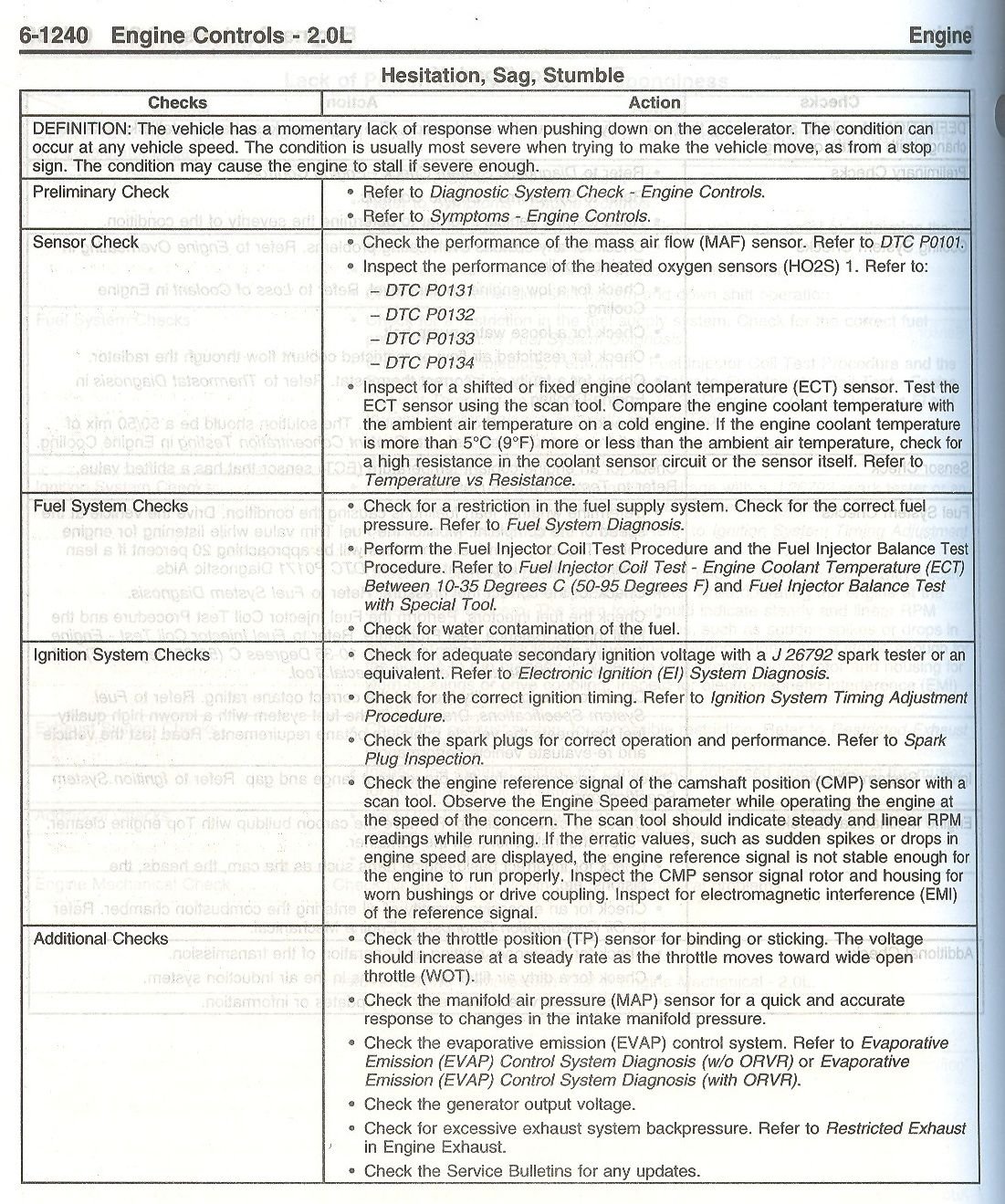

>> Tracker is stalling out in 2nd/3rd gear but running fine at idle.
Does this sound like your issue?

>> it is not running fine at idle. It runs rough
Maybe this one?
These are troubleshooting flowcharts from the Tracker factory service manual (purchased from the dealer in 2001)

That seems closer to my issue. Does the manual say anything about a P0303 code specifically? That's the only code I'm getting
Looking at this though, I've gone through the ignition system and fuel system checks.. and compression. Must be something else from the engine mechanics list. Thank you!
