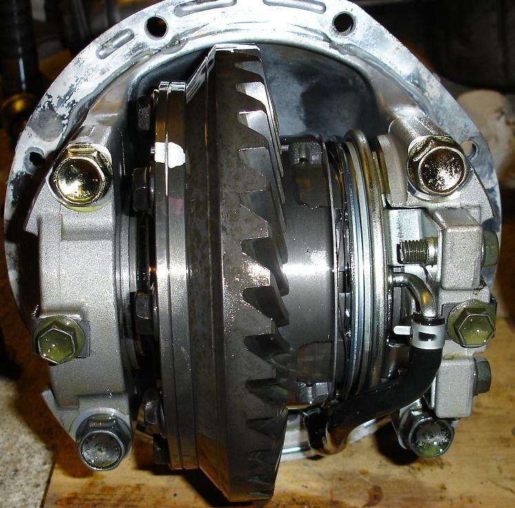

It's probably a ruptured actuator.
But even if it's just a bad air hose the diff still has to come out of the car. Sorry.

The part is still available but it's the labor cost that will be expensive.

So is the Suzuki actuators the same as the tracker ones mounting wise because the pictures don't look the same

> is the Suzuki actuators the same as the tracker....
The Tracker is made by Suzuki so if the model year is the same the parts are interchangable.
