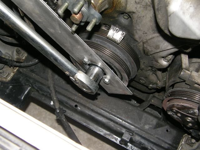

The pulley bolt is removed by turning it counter-clockwise but the crankshaft must not be allowed to rotate.
Chevy calls out a special tool for this.
You can make the tool out of a flat steel bar.
But on the 2.0L you can just jamb a screwdriver into the flywheel.
Tighten bolt (clockwise) to 150 Nm.
