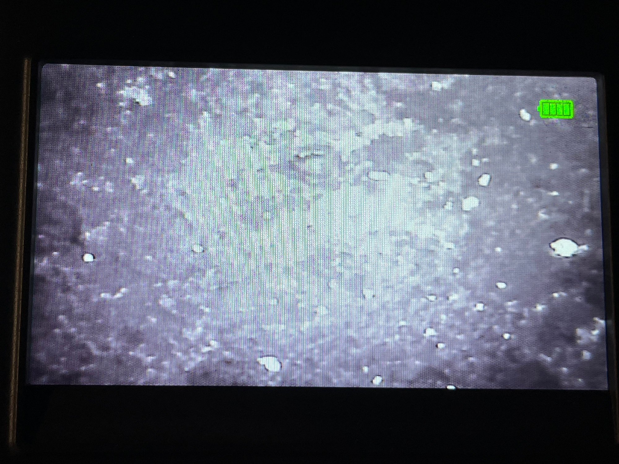

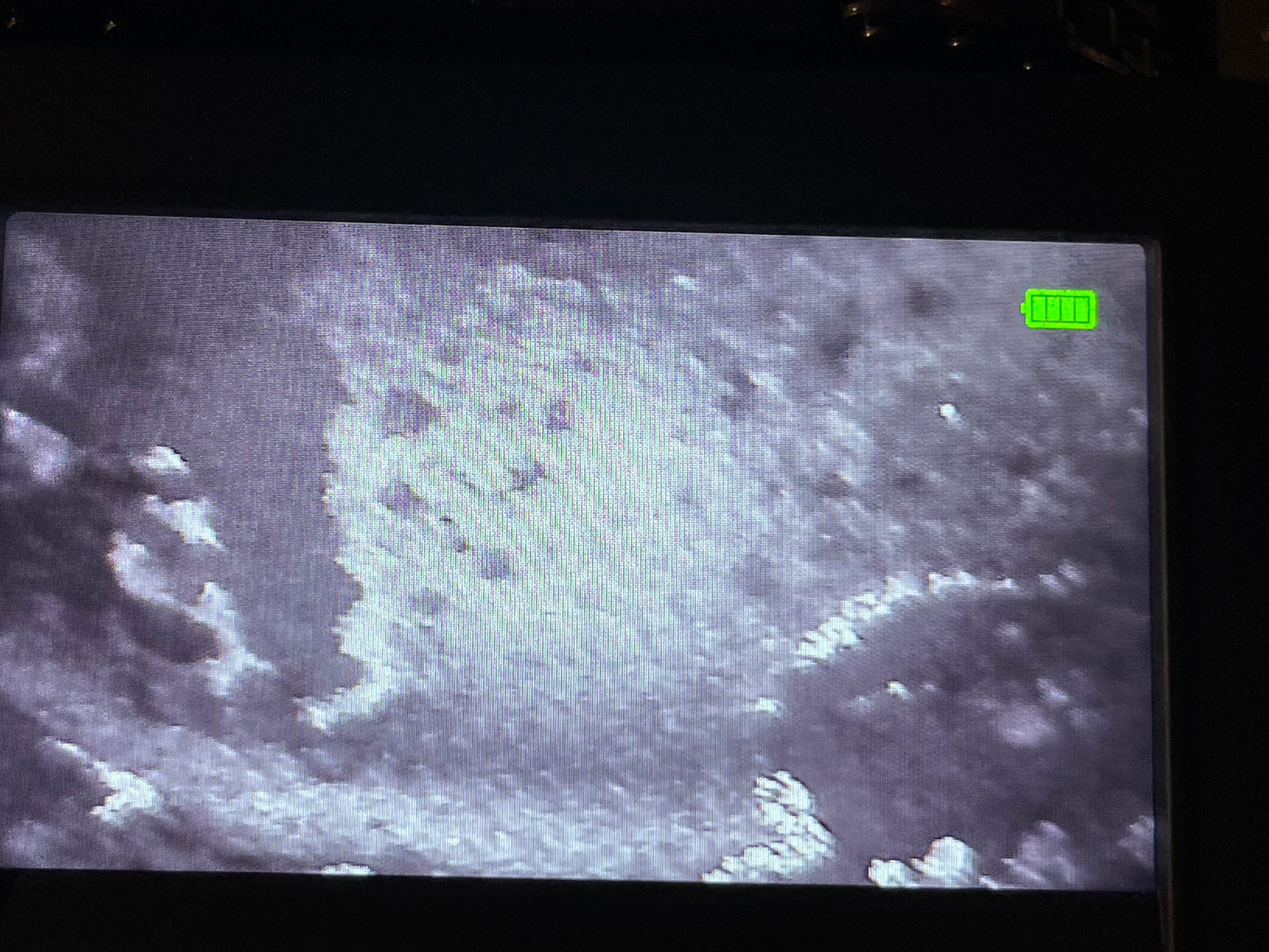

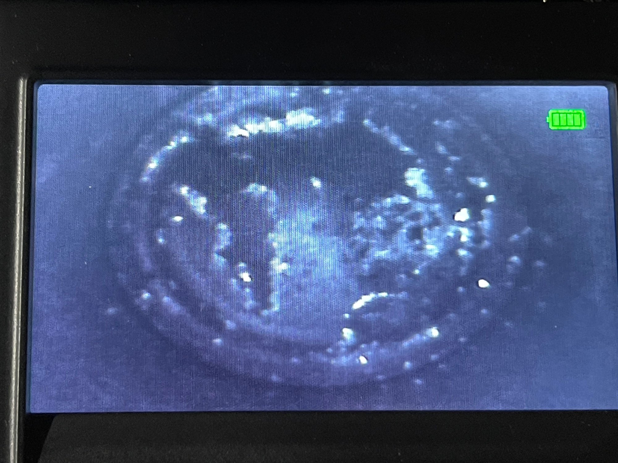

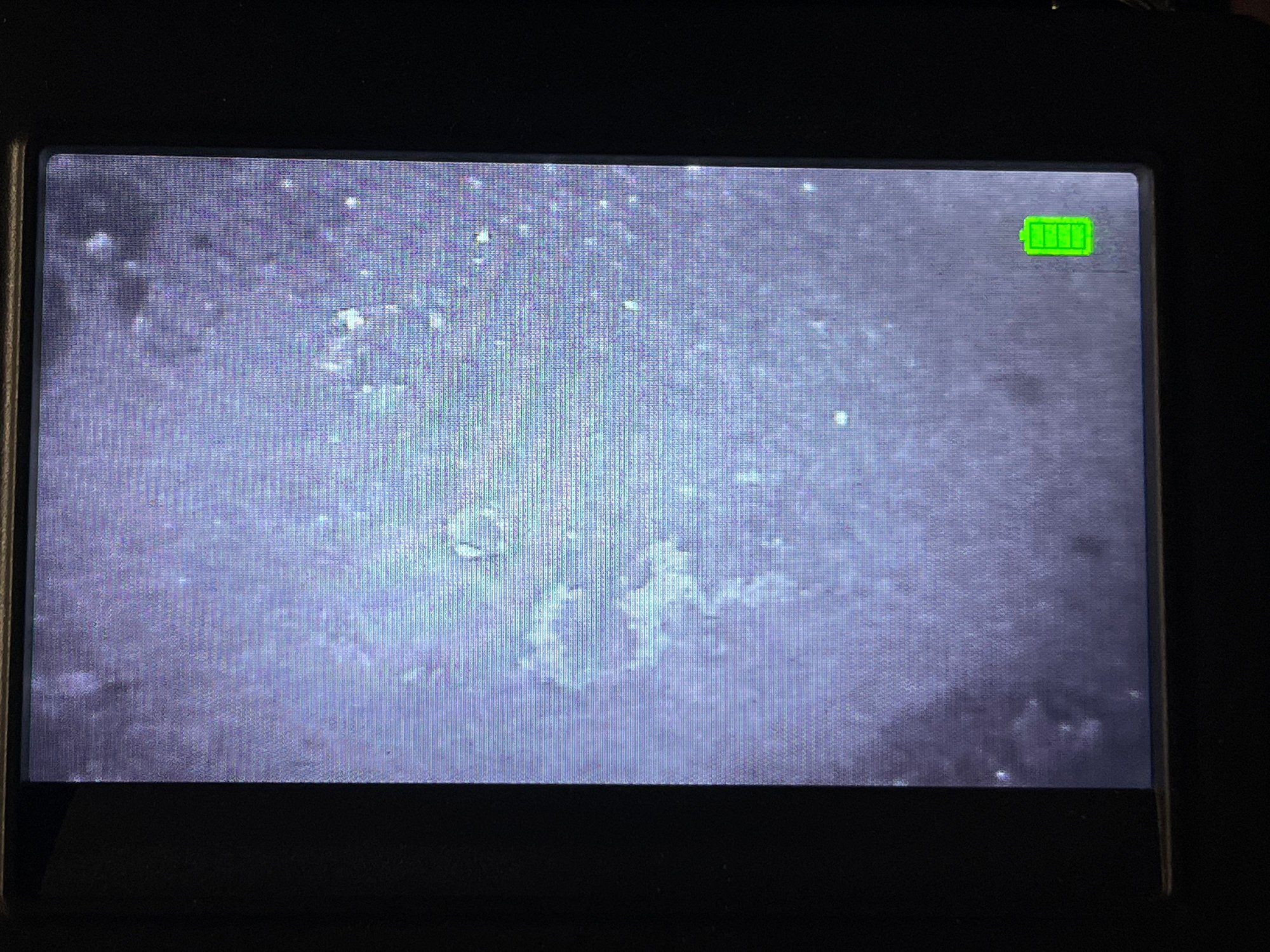

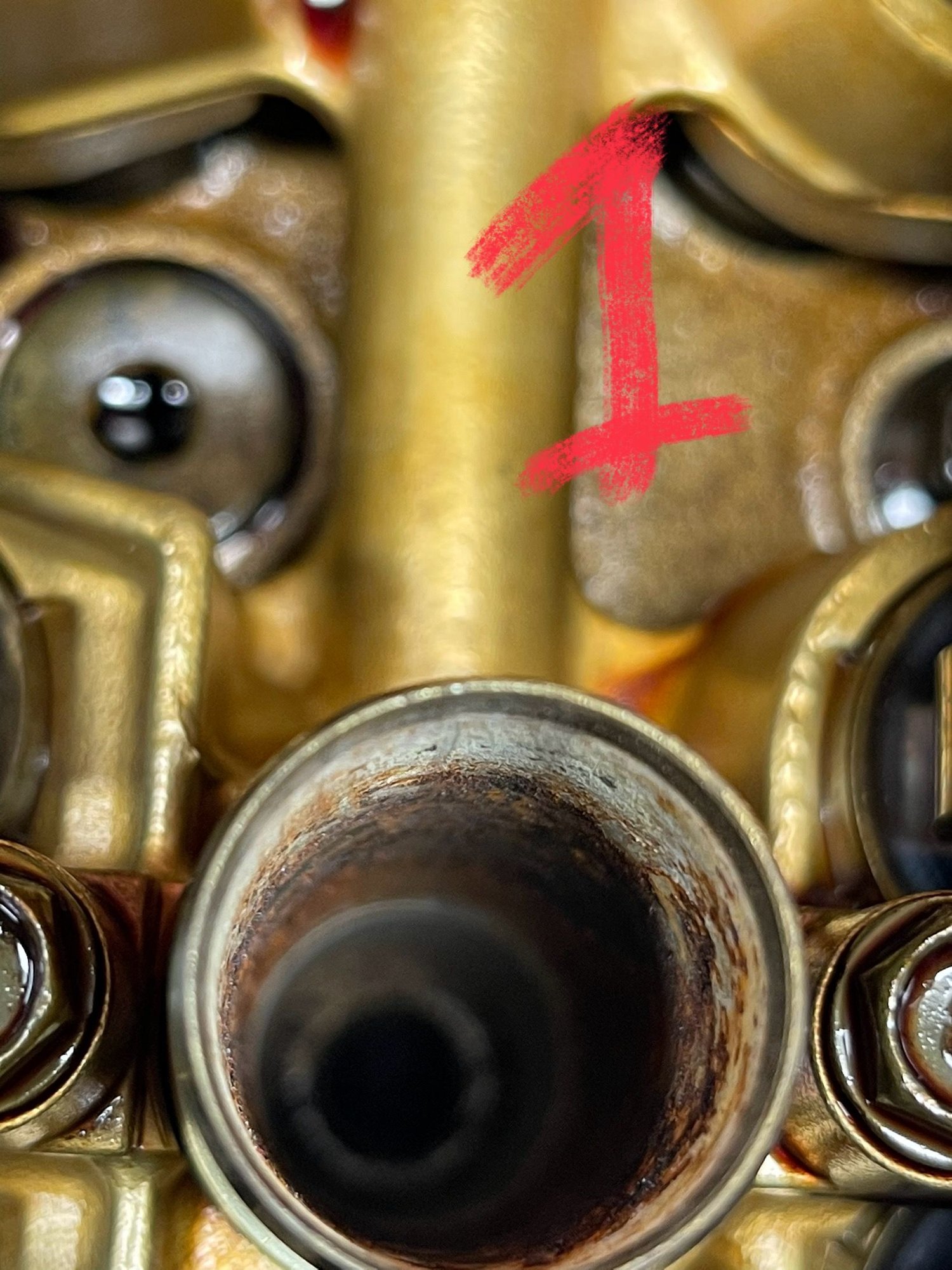

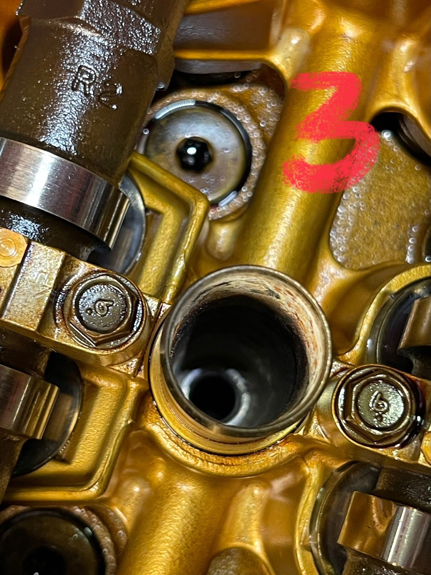

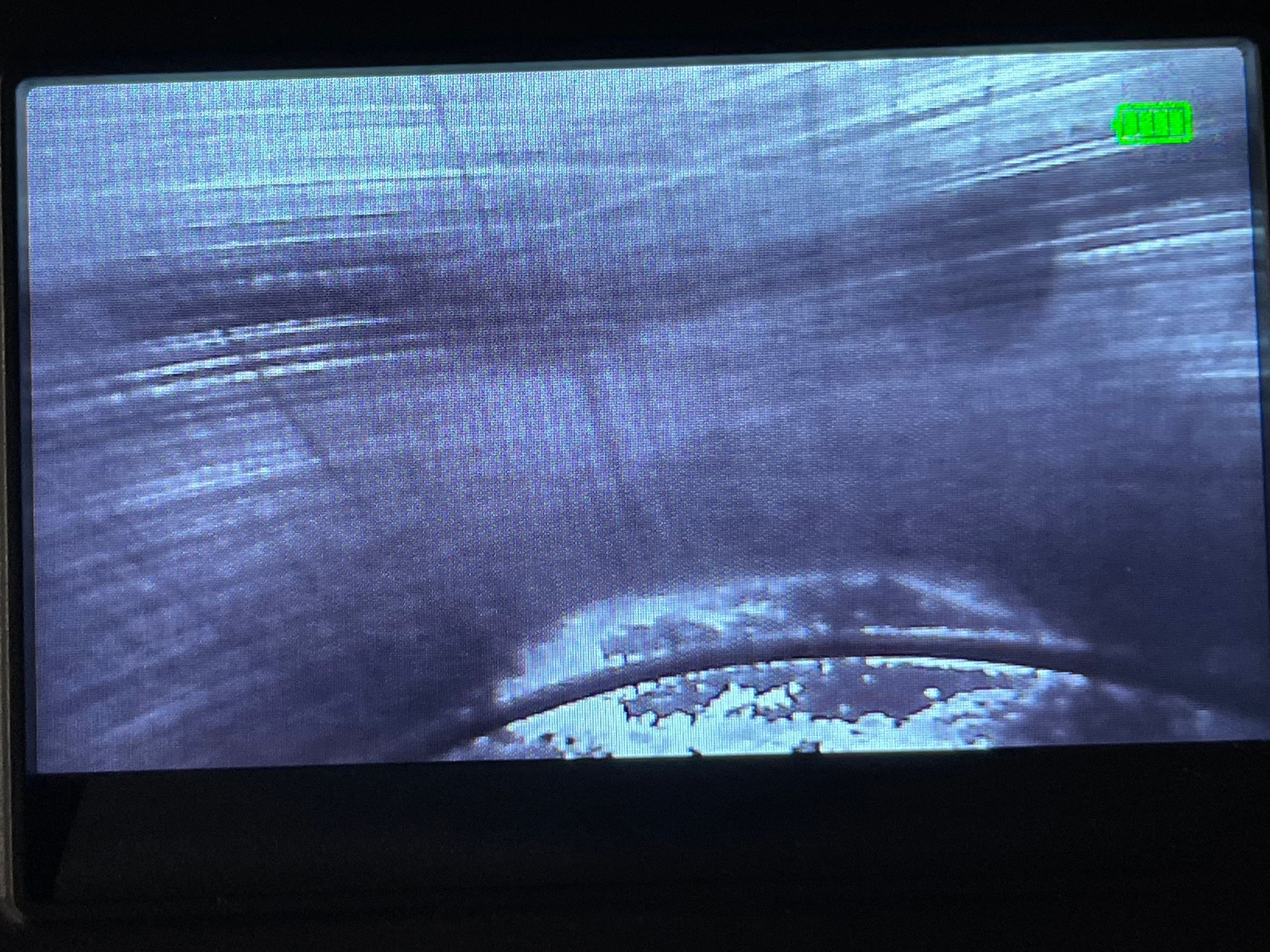

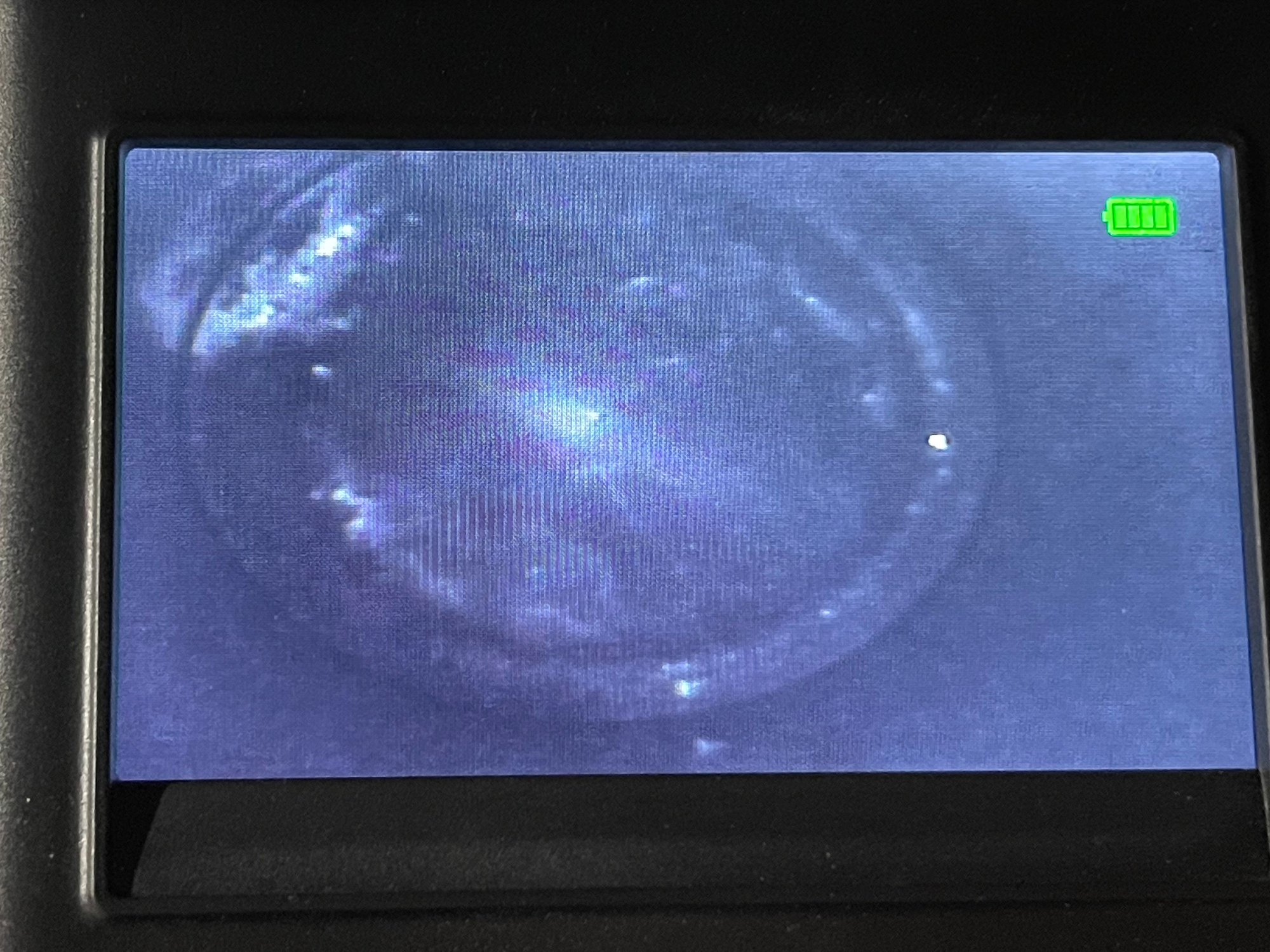

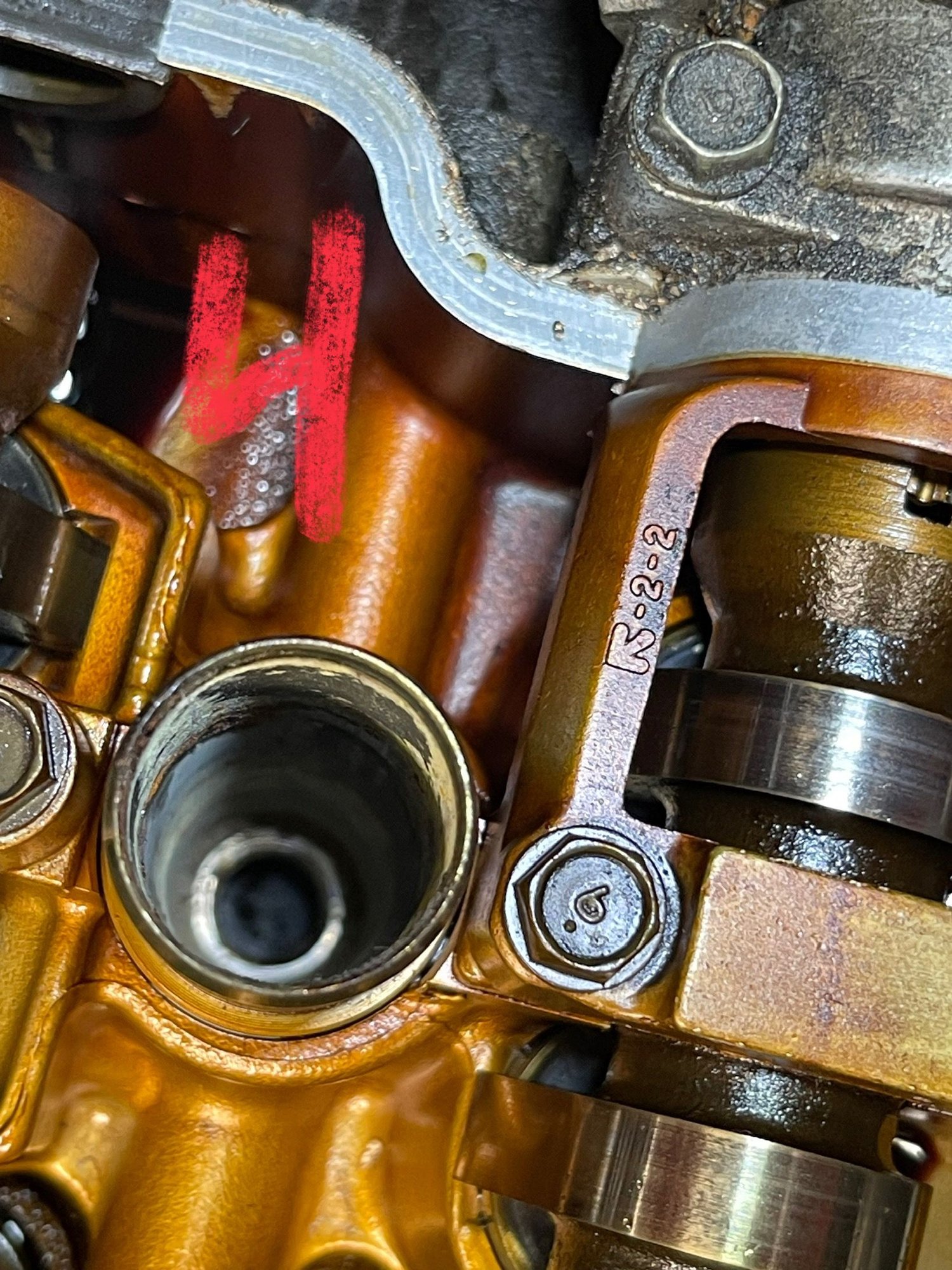

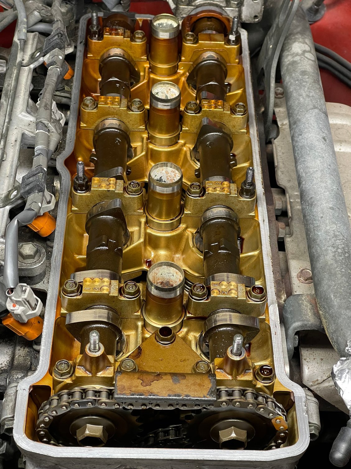

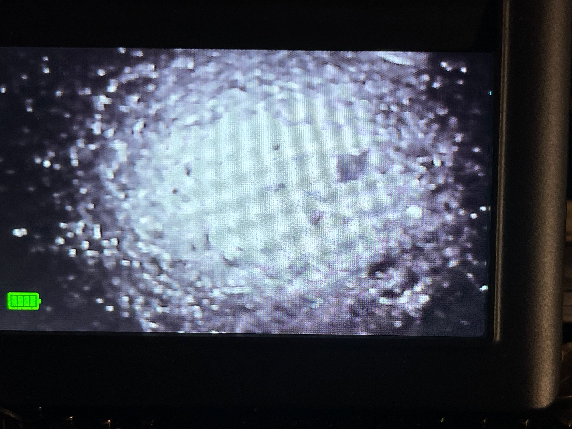

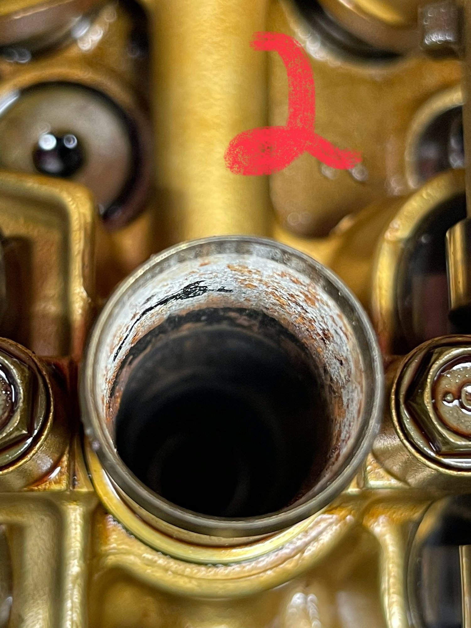

Hello, I have a 2000 Chevy Tracker that my daughter loves and I’m in the process of replacing a lot of worn parts including the timing chain components. Since the valve cover comes off as part of that, I went ahead and took a look at the pistons via a borescope. I’m not really sure what to look for and whether I should consider getting the head and block machined and rebuilt. It’s got 130k miles and I’d like it to go 200k.
Thoughts on these photos? Piston 4 looks oily and the PVC was definitely clogged when I pulled it.
The rest look like they’re covered in quite a bit of carbon. I could walnut blast those as I do that for my BMW intake ports and valves every 30k miles. I could also run Seafoam through it.
The cylinder walls still show good signs of cross hatching but I can see vertical wear marks too. But could be normal for this mileage, I just don’t know.
Thoughts from any mechanics with experience in this area?
Spark plug port cylinder 1
Cams
Cams
Piston 1 at TDC.
Piston 1 at TDC.
Piston 2 at bottom. Shiny part on the top left looks like carbon removed??
Closeup of 2 center.
Closeup of shiny part on piston 2 with cylinder wall. You can see the cross hatching and vertical scoring.
Different angle on 2
Piston 3
Piston 3
Closeup of 3
Closeup of 3
Edge and wall of 3
Edge and wall of 3
4 is TDC as well and pretty greasy too.
A borescope won't tell you much about the condition of the engine. At a minimum you should do a compression check and then a "wet" compression check. If you have a compressor, Harbor Freight has an $85 leak-down tester. If you're worried about the condition of the head gasket, Harbor Freight also has a $34 products of combustion detection kit. These are all non-invasive tests and will tell you much more about the engine internals than a borescope.
