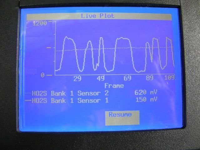

This is a plot of Sensor 1 and Sensor 2 on the Bank 1 PUP of my Tracker. The straight line
of Sensor 2 indicates the cat is operating normally. The high and low peaks of Sensor 1 are
caused by small changes to the pulse width of the fuel injector signal. If the the O2 sensor
detects a "rich" condition, the PCM reduces the injector pulse width producing a "lean"
condition. When the O2 sensor detects the lean condition, the PCM responds by increasing
injector pulse with a little. By constantly bouncing between "rich" and "lean" the PCM is able
to maintain an air/fuel ratio right around 14.7:1.
