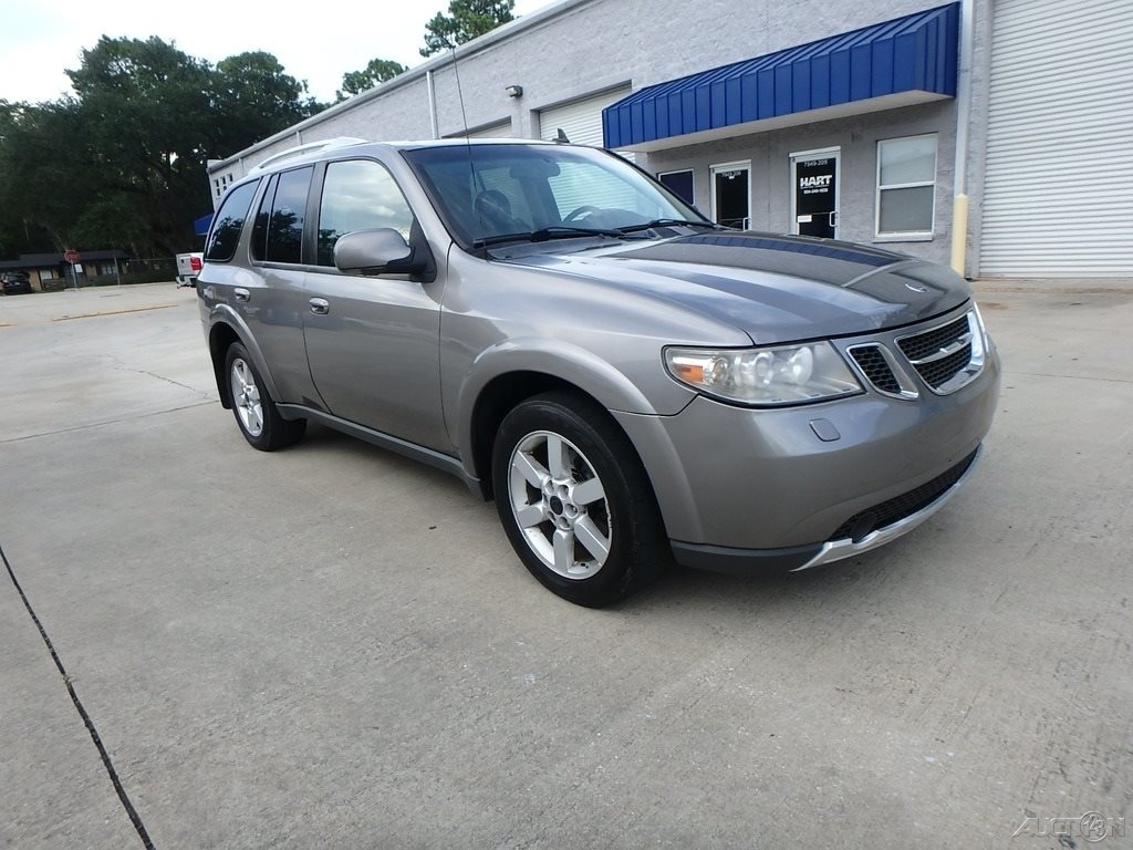

Default planning a AFM delete on my 07 Saab 5.3 same as trailblazer.
I am planning a AFM delete on my 07 Saab 5.3 same as trailblazer.

Like If another set of AFMs last 150K or even 100K I would be satisfied. However I need a reliable long distance vehical
This isn’t a racing car but mainly a tow vehical for my 3K LB boat.
