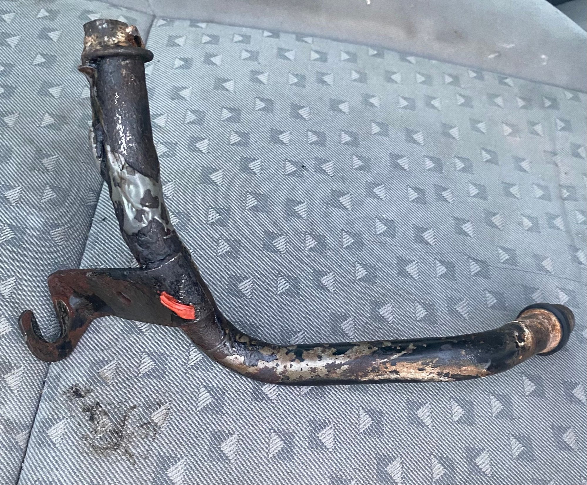

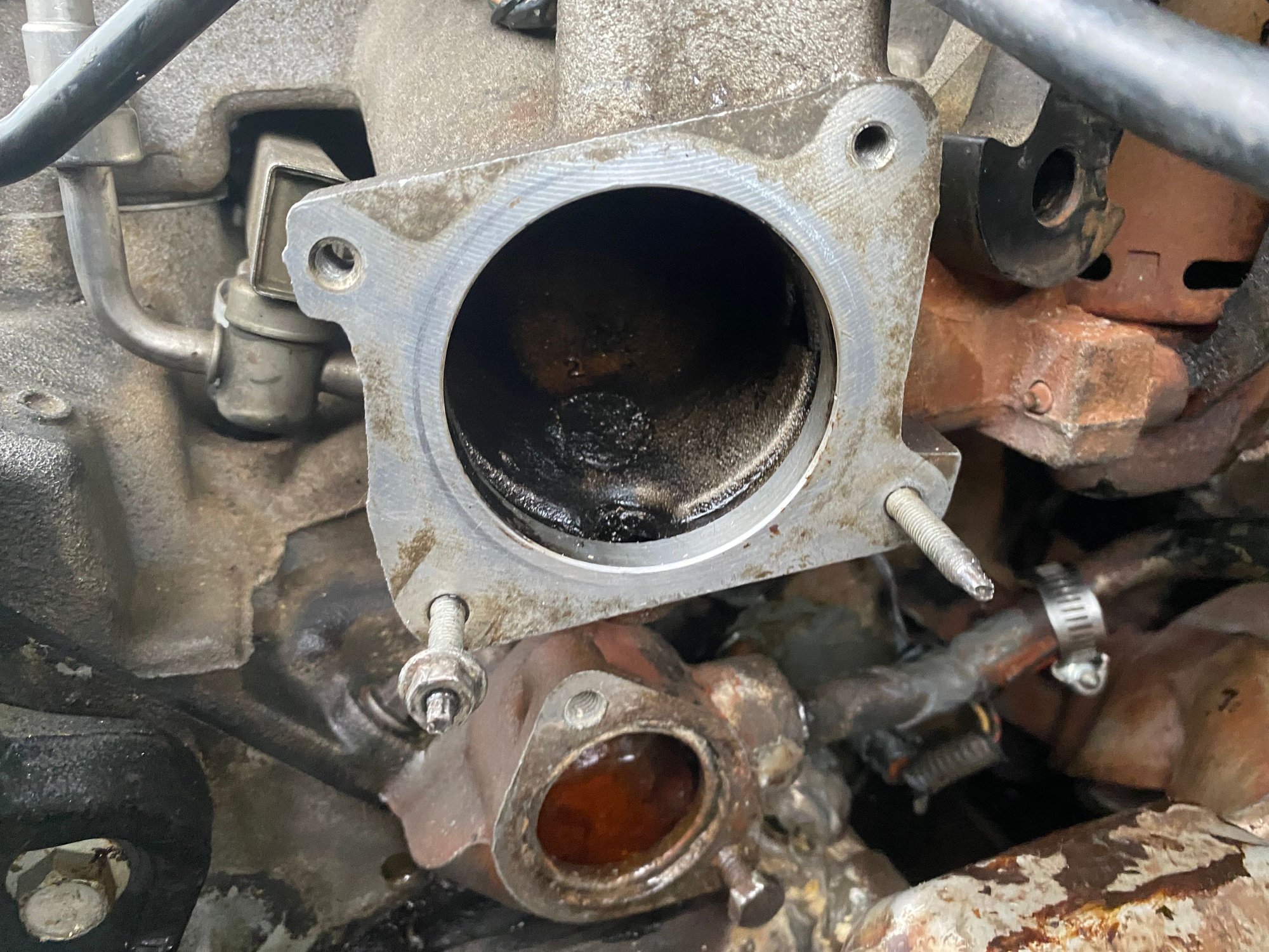

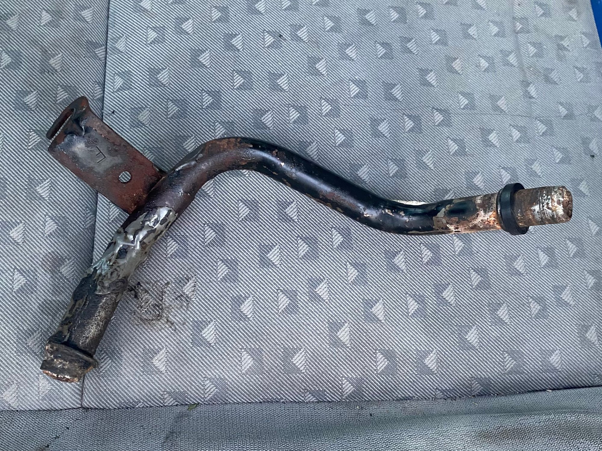

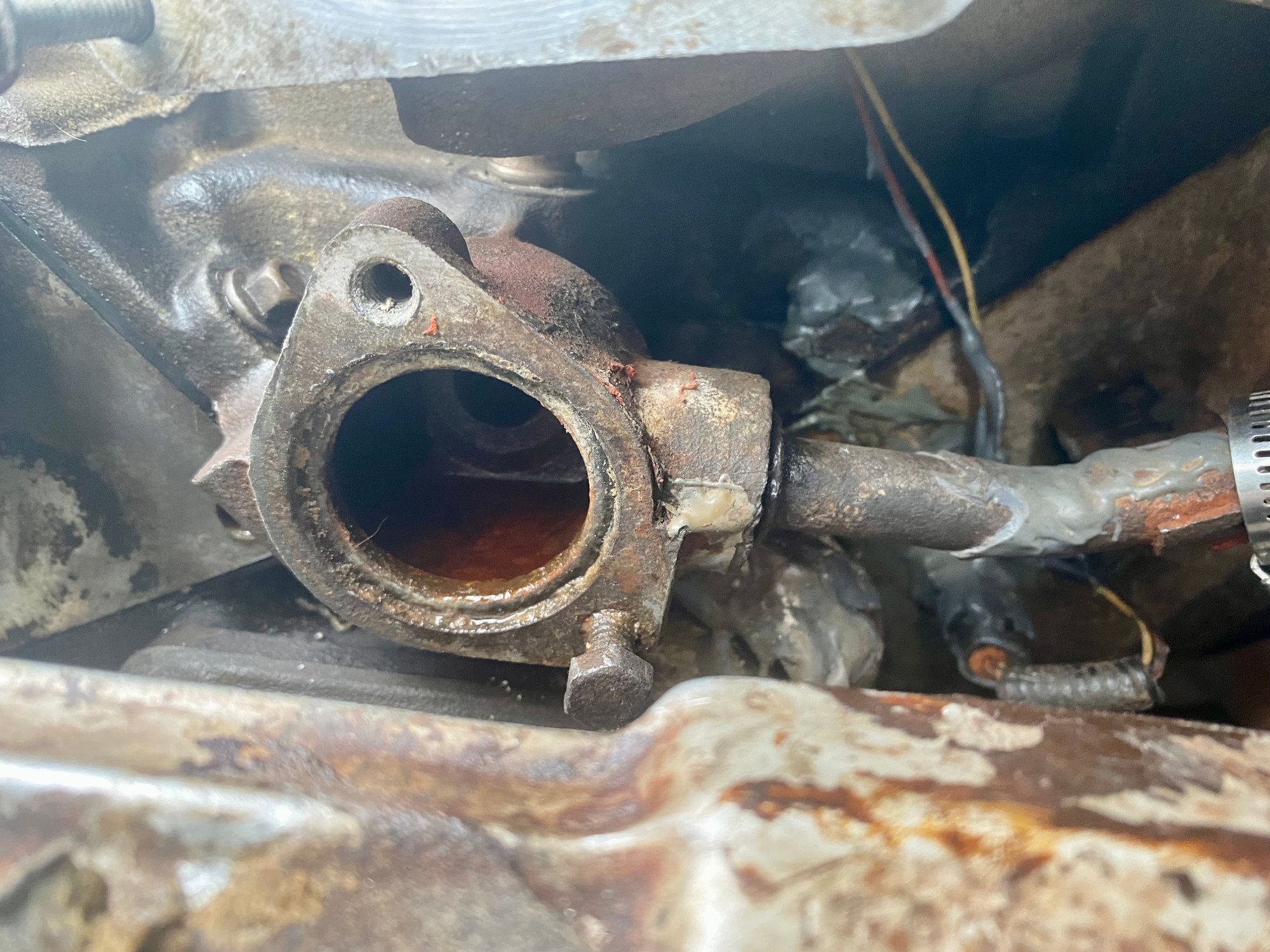

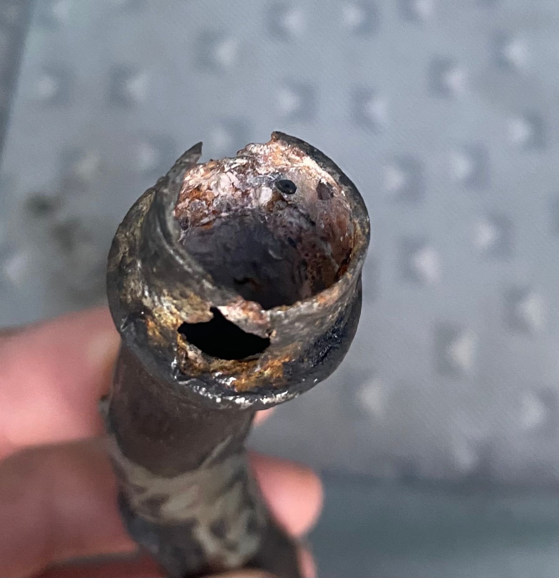

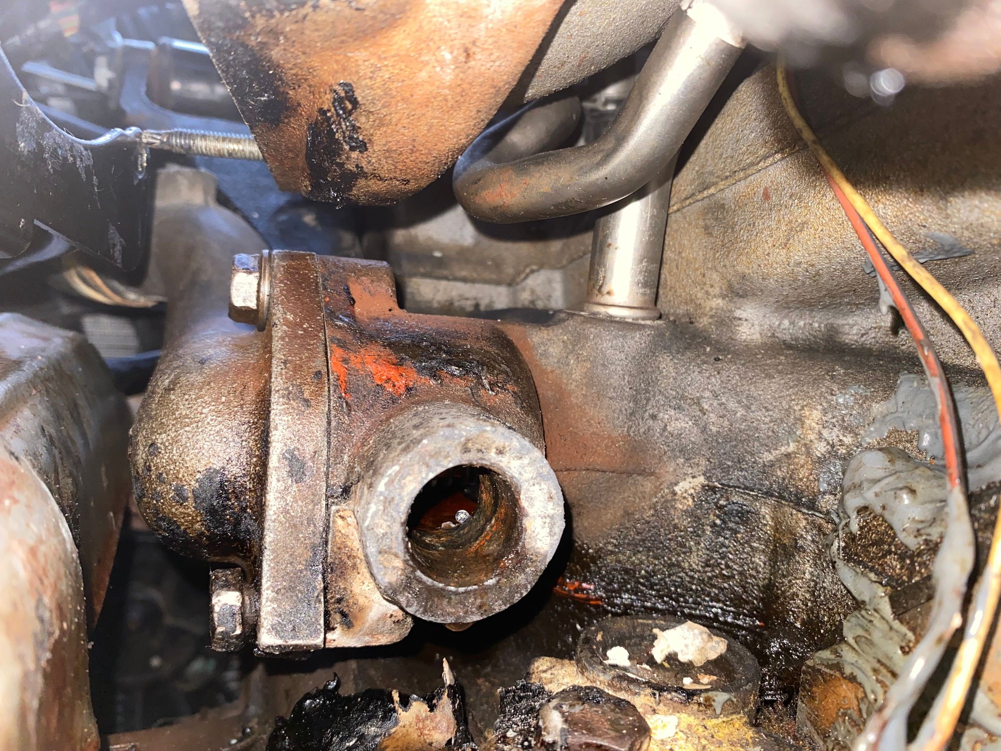

I have a coolant leak on my 2006 Chevy Uplander LS 3.5L. I found the source of the leak and I can’t seem to figure out if I have found the right replacement pipe. The thermostat housing bolts onto the water outlet at the block. Just to the right is a pipe connecting the water outlet to heater hose outlet. The pipe is secured by an o ring and it’s also bolted to the block. That pipe corroded and broke in 2 where it sits in the block. I found an AC Delco heater pipe- part 12570811 that shows it’s the replacement. It doesn’t look the same though. And it’s $68.99! I found that its parts are interchangeable with the Pontiac Montana SV6 and that pipe looks much more like mine. Plus it’s $36. I’ve attached photos of my pipe as well as photos of what I’ve found. Can anyone please tell me if u know which is the correct one? No one at auto stores around here seem to know much or care to help. I’ve got myself this far, so I’m def not paying someone to do anything else on my van. I know someone on here is much more knowledgeable. This forum has gotten me thru the last few months.
After removing throttle body from the top and the thermostat housing from the bottom, I was able to see the leak clearly when I noticed the play in the pipe.
Better view of the pipe and the space created between.
After removing the pipe. In this photo the thermostat housing has been bolted back onto the block.
The corroded tip I discovered after pulling it out.
This is the pipe.
This is the pipe.
From a different angle.

Is it just me or does that pipe look like it’s been welded together? Maybe a previous owner found the part to be discontinued and resorted to welding it back together. That pipe didn’t come off of the assembly line looking like that. Van most likely ran hot at some point and rusted the line into.
