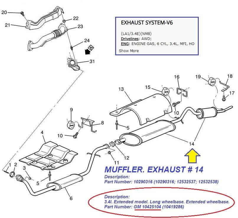

the muffler on my wife's awd venture is rotting away and getting quite loud, so I have been shopping for a replacement. problem is, I can't find one for the awd version, they all specify either fwd or don't say. will any muffler for the long wheelbase version work?

Hi! Hope this helps you.

Awesome, I kind of assumed it was the long wheelbase because all of the awd vans were extended (at least as far as I know) I have one ordered and on the way here now. Thanks for confirming my suspicions.
