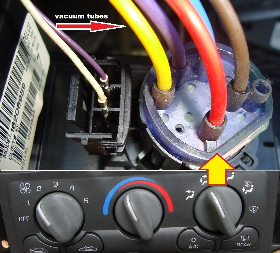

Hi !
Check the vacuum tube. Check the operation of the vacuum actuator
(See picture)
