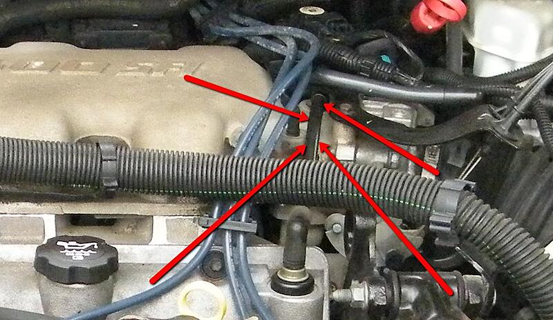

Hello,
Does anybody knows where does line from PCV goes (more interested in thin line that starts after intake manifold (?!) and goes to back of the engine? Maybe you have diagram?
Thank you!

I guess found the answer - It goes to back of engine where purge valve is located.

Default but whe is that
underneath the bracket witht he spark plug wires?

Default Found it and fixed it
When your hose becomes brittle...and breaks... if you want to replace it the end towards the fire wall is not easy to find. I think i got my new hose at advance with 30 percent off around 6 bucks. Reviews were not good with folks saying it didnt fit good but it fits perfect if you use your mind. The plastic becomes more bendable / workable if you warm it up with a hair dryer on high for a bit.. dont hold too close.. after about 3 minutes they pushed in and sat perfectly. I finally found the end which is easier to access with your left hand and arm as there is more room going in from the left while leaning over the engine. basically that bracket wtih the spark plugs .. the pcv valve connects in the middle of a smaller box that mounts to the backside of that bracket that holds the plugs. you cannot see it but you have to feel for it. the old line that had broken had pulled off the boot so i just had to feel for the boot and then push the new one on which it did with a little effort... So in the last two weeks i have changed:
