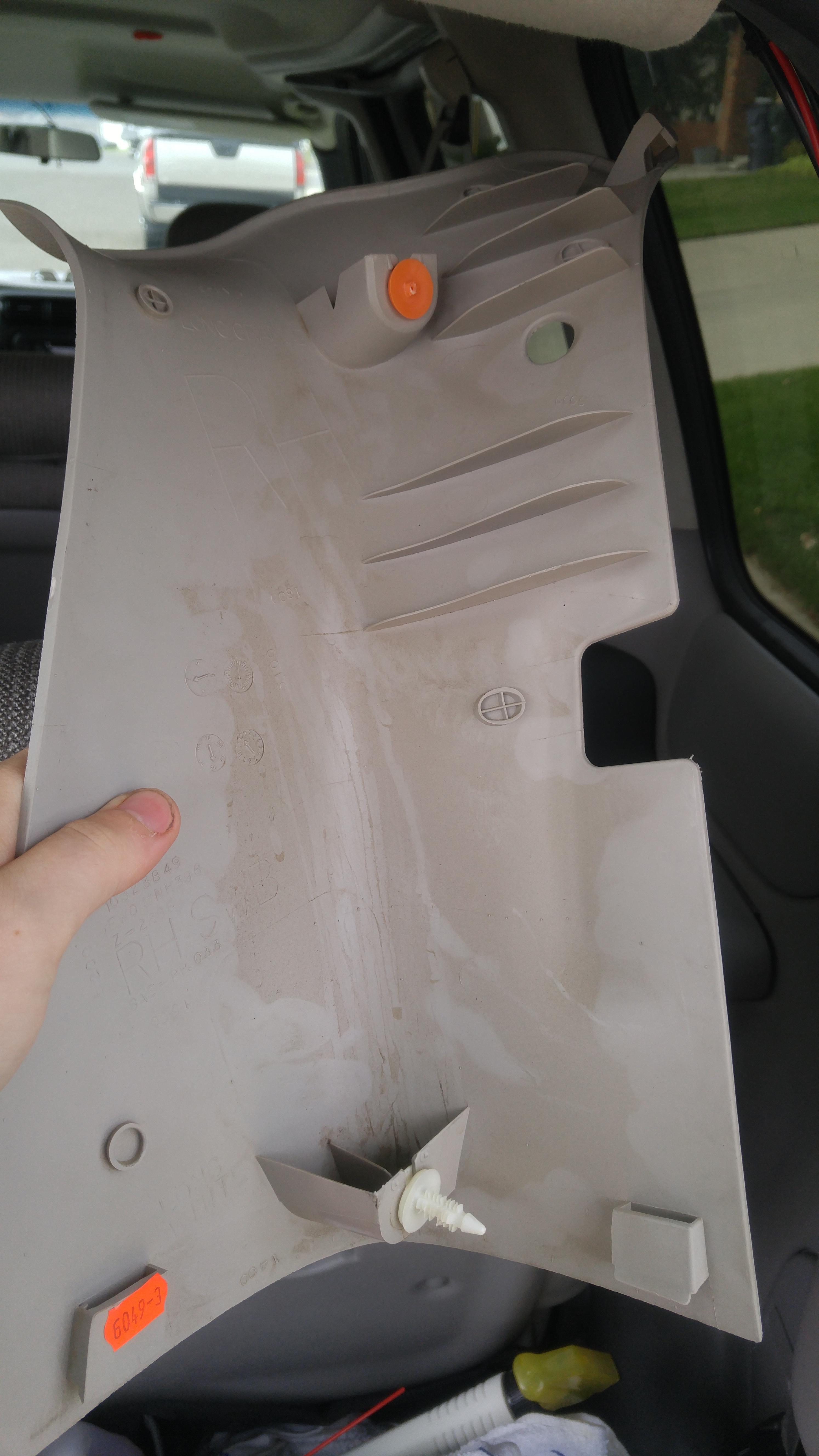

and here is the cover itself if you want a better look at where stuff goes that secure it in place:

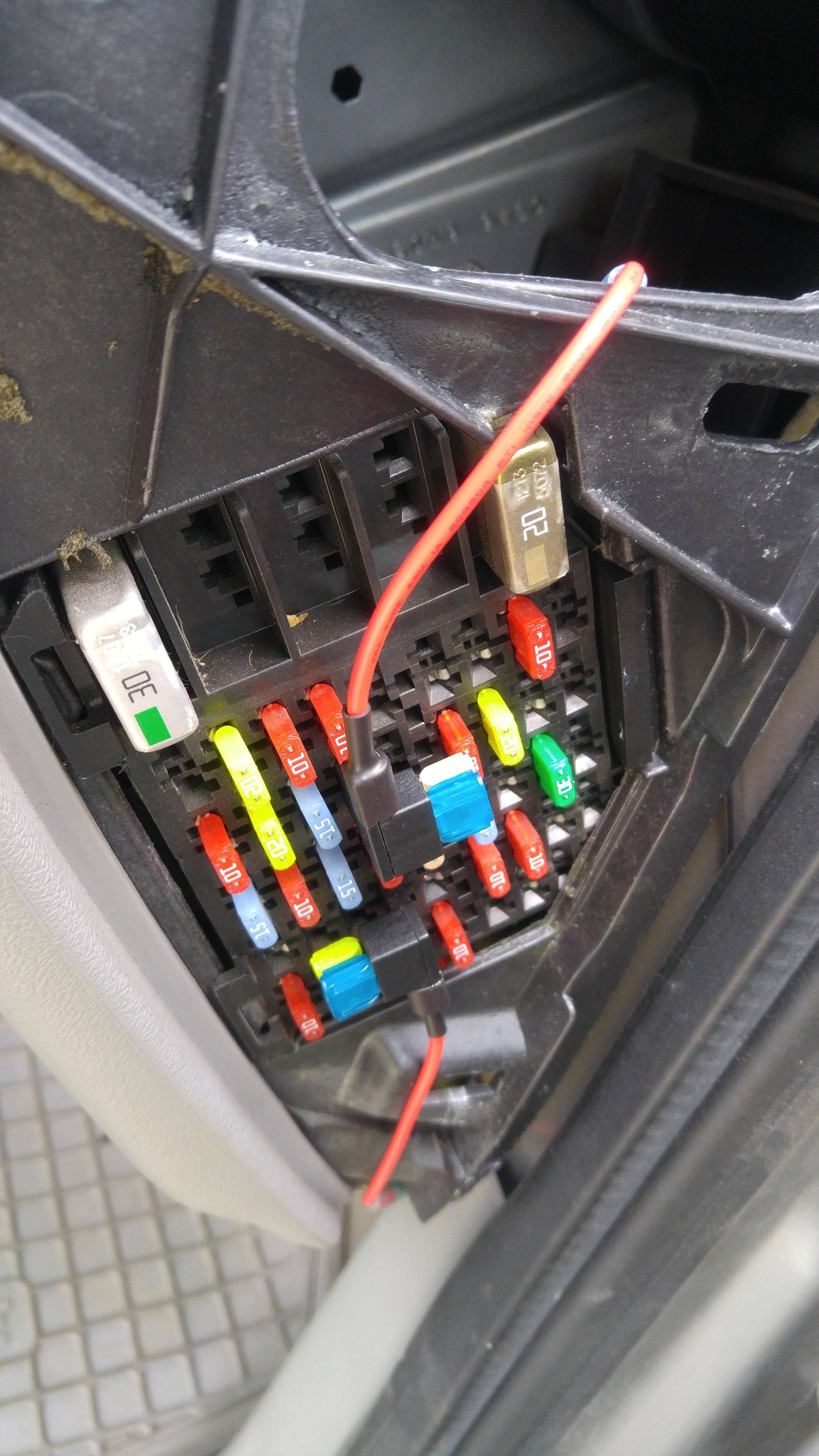

And then I taped a fuse (The other tap is for my cigarette lighter so that it shuts off the power when the van is off)

Thanks! I am hoping to make the wiring in the fuse box OEM but I might need to buy a spare to just learn the ins and outs of it.

Buy a spare from your local junk yard it will be cheaper that way and it probably still works so you would have an extra one floatin around. Just my thoughts anyway.
