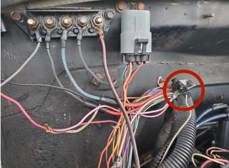

Here’s a pic of the spark control circuit connector location (courtesy of a previous thread). As long as this is disconnected the spark timing is only adjustable by rotating the distributor.
ECM spark control circuit connector circled in red
oh yes, that’s unplugged
