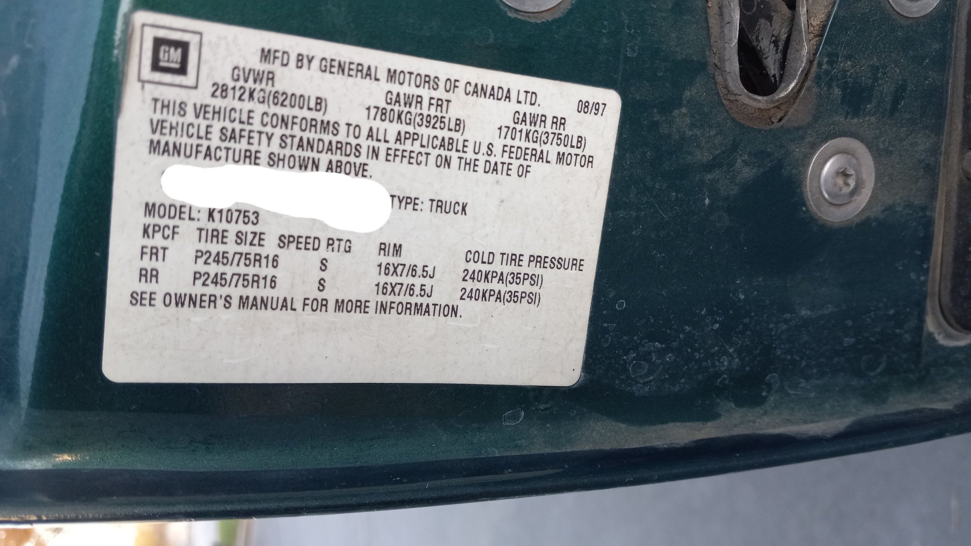

Here is the sticker in my door jamb. And their is also typically a very usefull sticker in the glove compartment with RPO codes. You can find RPO code lists online and decipher the build of your truck.
