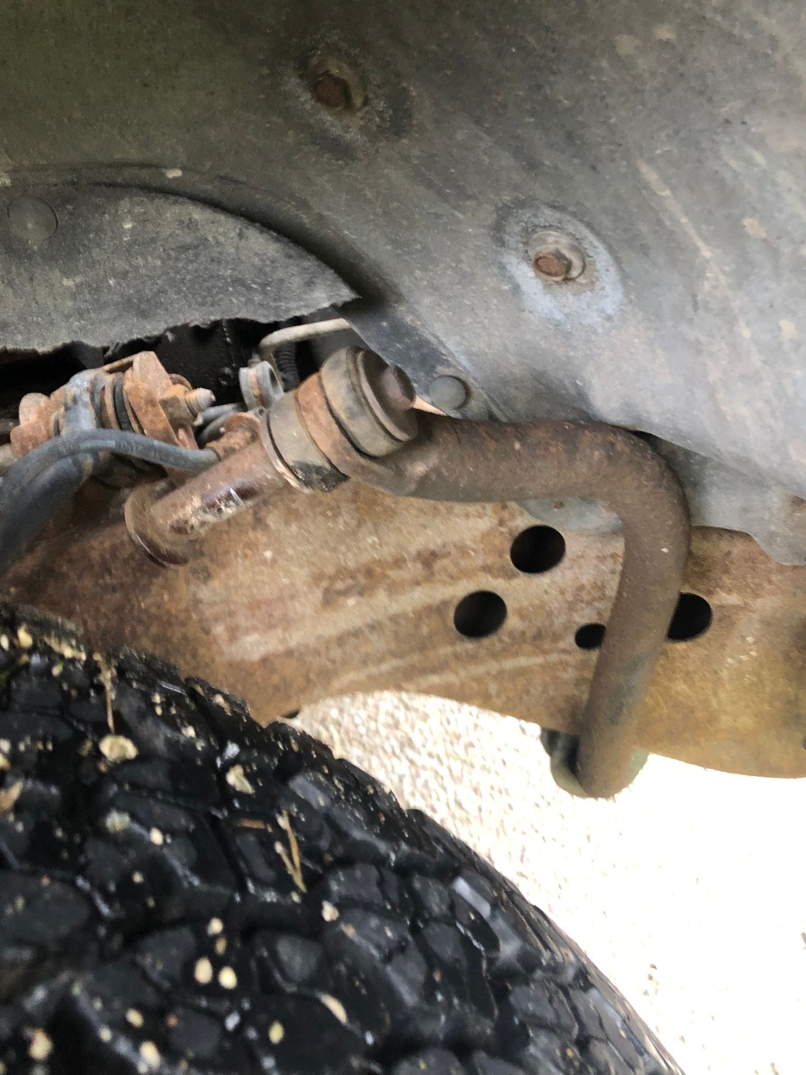

I hit a pothole, now when I make a sharp turn either way there’s a terrible grinding noise and vibration on front right, the sharper I turn the worse the noise gets, I haven’t noticed any unusual noises in any other situations only when I turn sharp, I am lost as to what it could be any help would be great,

jacked it up today, both tires had a lot of play side to side and nothing up and down, also heard clunking up in the truck and seen a bar twisting in rhythm with the wheels and that was where the clunk was coming from, not sure what that is called I’m no mechanic, the steering wheel also moved in rhythm with the wheels, the bar that was twisting was located up in truck any idea what that is?
Old Apr 30, 2019 | 4:37 PM
Posts: 6,233
The bar is probably the stabilizer or sway bar. Check the bushing in this bar as this will cause a clunk when the bushings are worn out. Can you post a picture of it.

This first picture is the picture of the bar I’m guessing a steering shaft or something I’m not sure

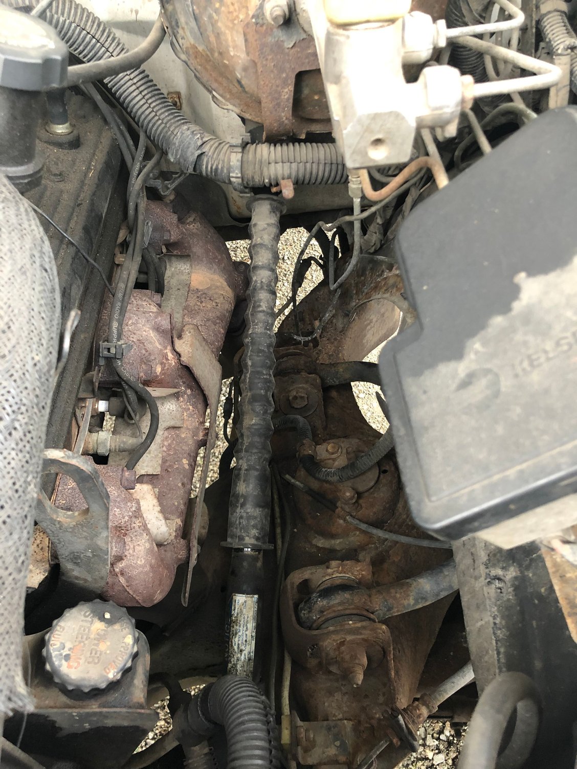

Second picture is I just noticed that the tires rub on that curved bar

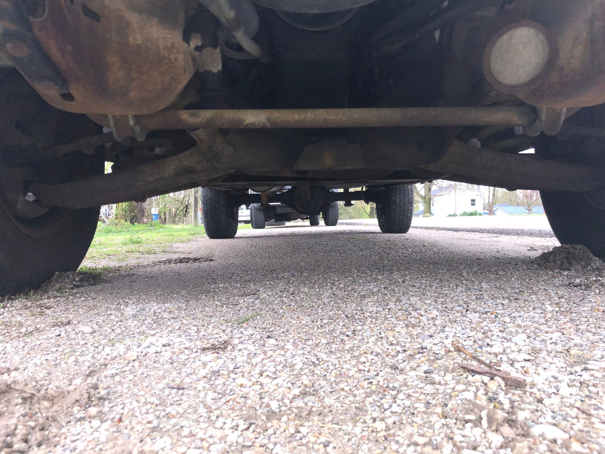

Third picture it looks to me as if the control arm is sagging on the left side as you look at the picture but can’t quite tell

It was the sway bar, took it off and no more sound, should I be concerned about putting a new sway bar on or could I get by for awhile without one

yeah I’m still doing some investigating, but the sway bar was completely twisted up to where the part that connects to the axle was sticking up and the tire was rubbing on that but I’m still looking at all components to make sure, thank you for the help
