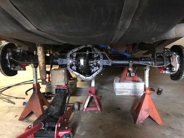

DRUM TO DISC REAR AXLE SWAP UPDATE:
Things you need to know when swapping 2005 K2500 HD disc brake rear axle into a 1999 OBS K2500 drum brake Burb...

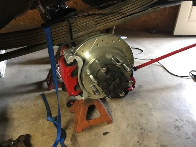

The later model HD 14-bolt has some differences from the axle that came in my Burb. First, the U-joint is larger and I chose to get a new driveshaft made but, you could probably use an adapter joint. Second, the HD axle seems to have slightly taller spring perches, so this will require new u-bolts and also add about an inch of lift to your rear suspension. Additionally, the perch spacing is narrower by about an inch...so I used a ratchet strap to pull them into position and tighten the u-bolts. The e-brake system is totally different, and I used the rear cables from the 2005 and mated them to the single front cable from the 1999. This required me to use some $.89 cable clamps from Rural King...works great.
Immediately after the axle swap, I had an issue with the right rear caliper sticking, so I had to replace it. I had ordered a 2001-up K2500 Suburban master cylinder but, it did not show up in time to get it installed. I had a 700 mile road trip planned from Indy to DC, and I had no choice except to go for it. The stock pre-2000 K2500 drum brake hydroboost master cylinder DOES work with the post-2000 K2500 rear discs. However I think it could work better with the correct master cylinder. There seems to be a lot of pedal travel but, it does stop well. E-brake works well, and overall I'm very happy with the swap. I will be upgrading the master cylinder in the next month or two...
New HD disc brake axle is a very close bolt-in. Forgive the nasty shocks...those are temporary.
This came from a very rusty 2005 HD, so it needed new brake lines and a new cover (Dorman). Taller perches required new u-bolts.
Finally...the rear discs this truck has always needed!
