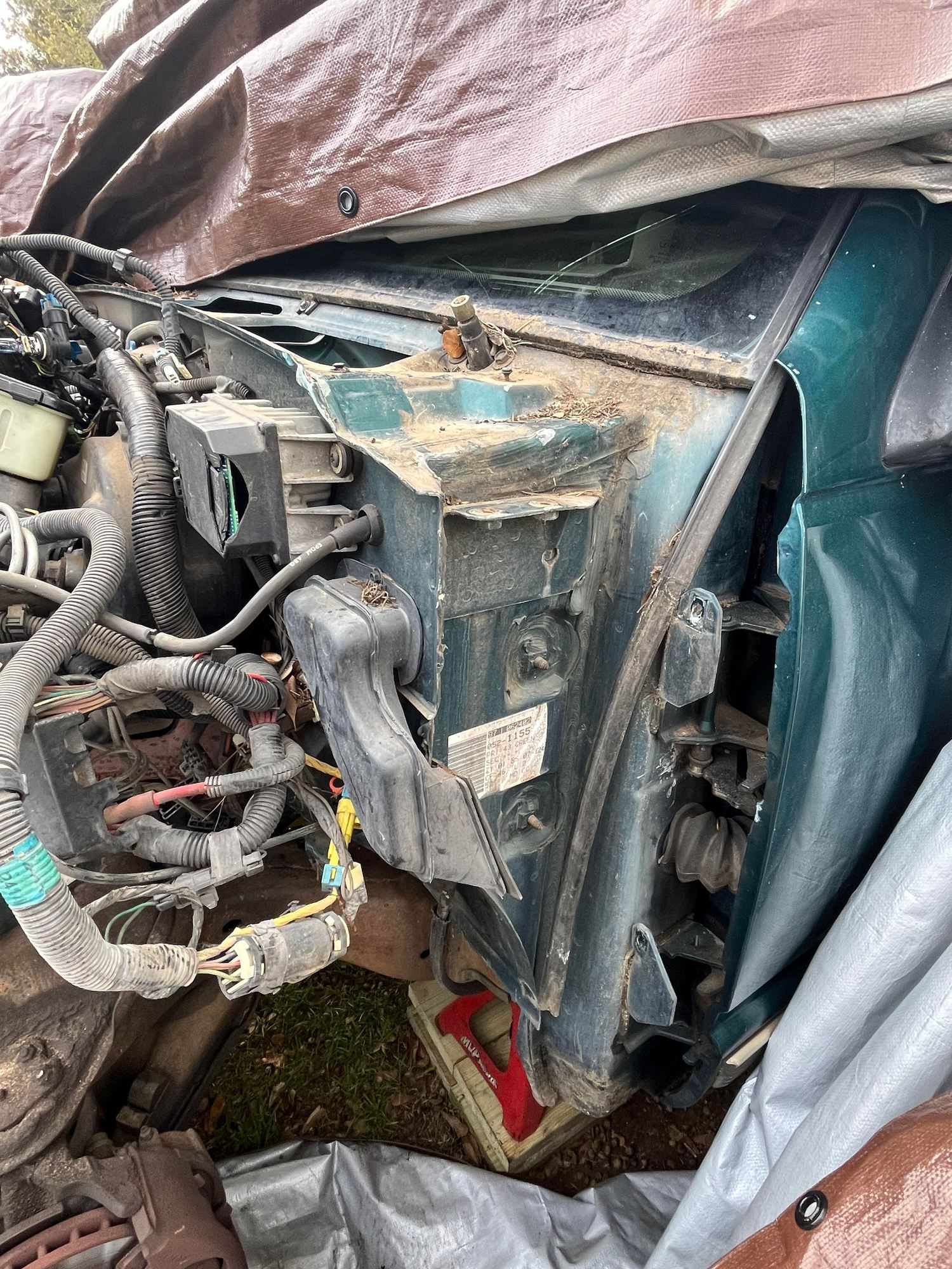

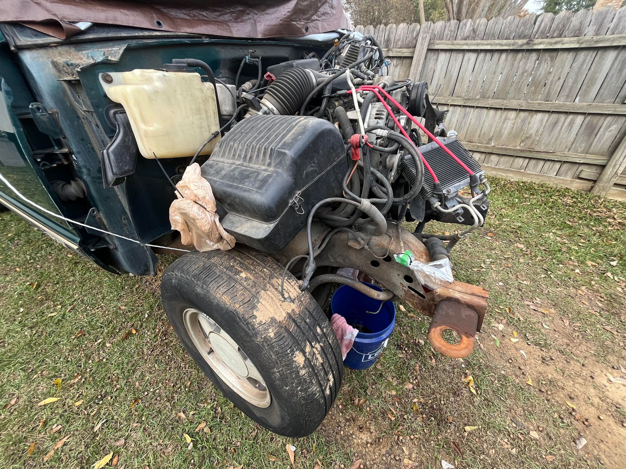

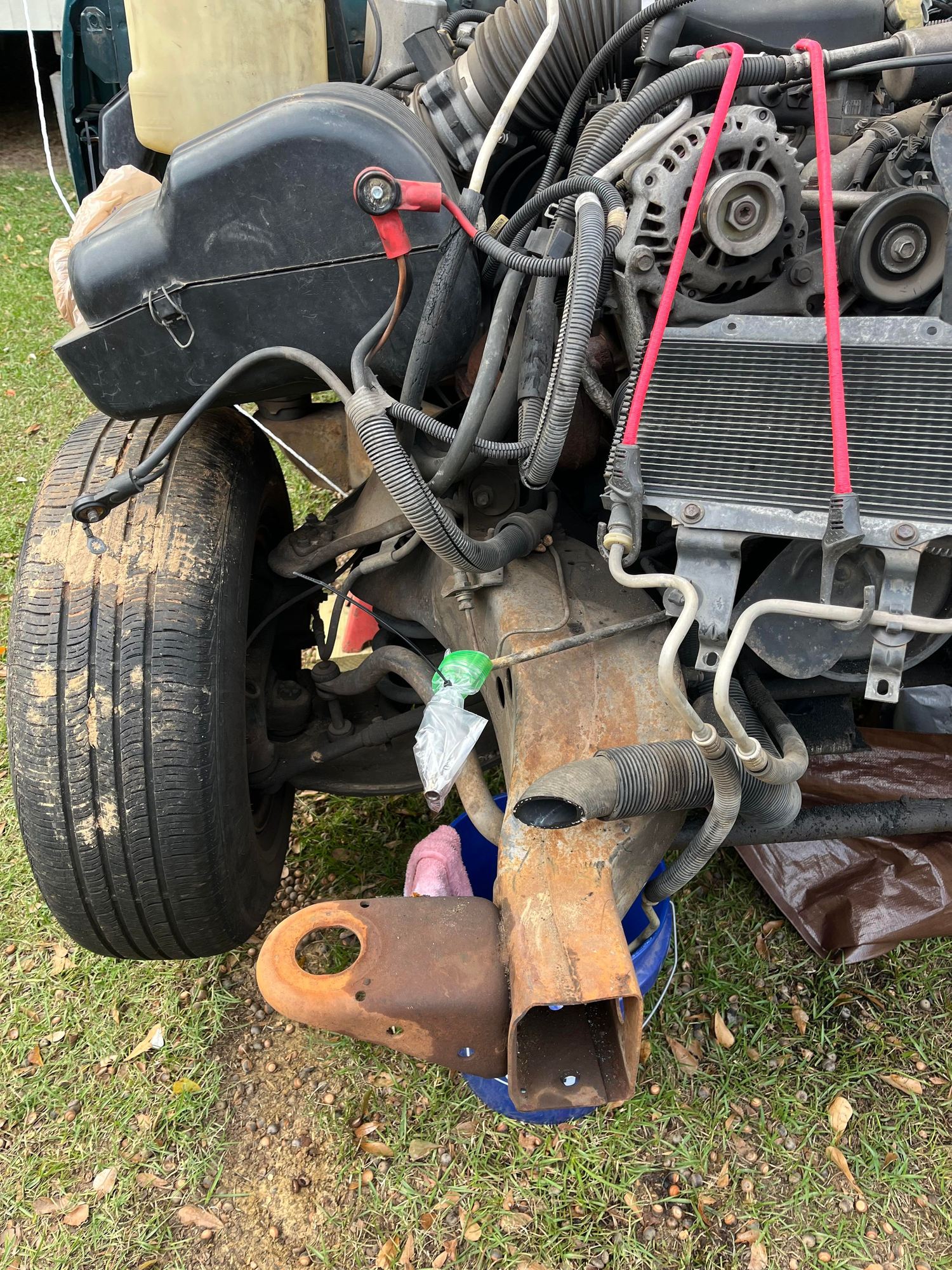

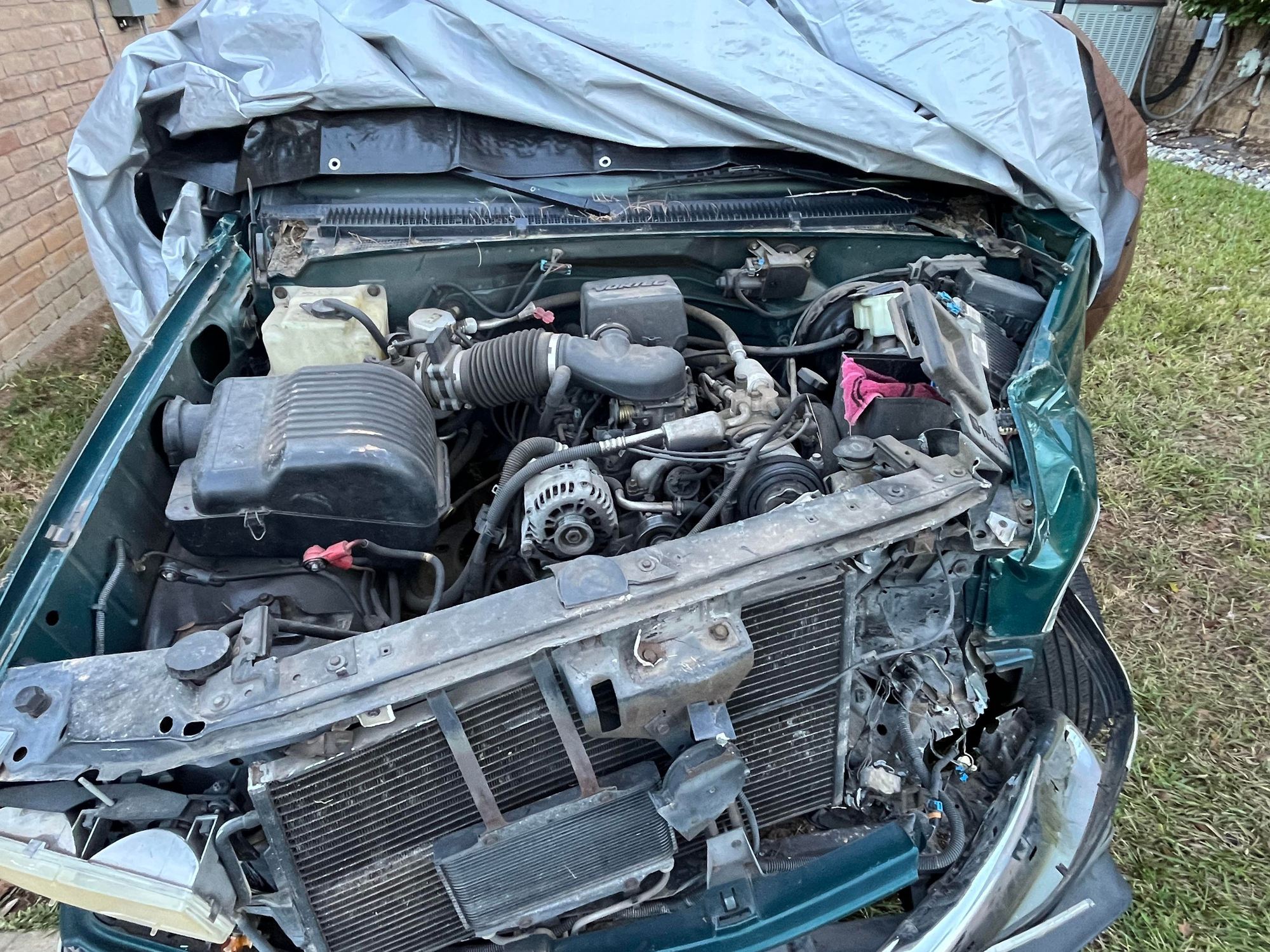

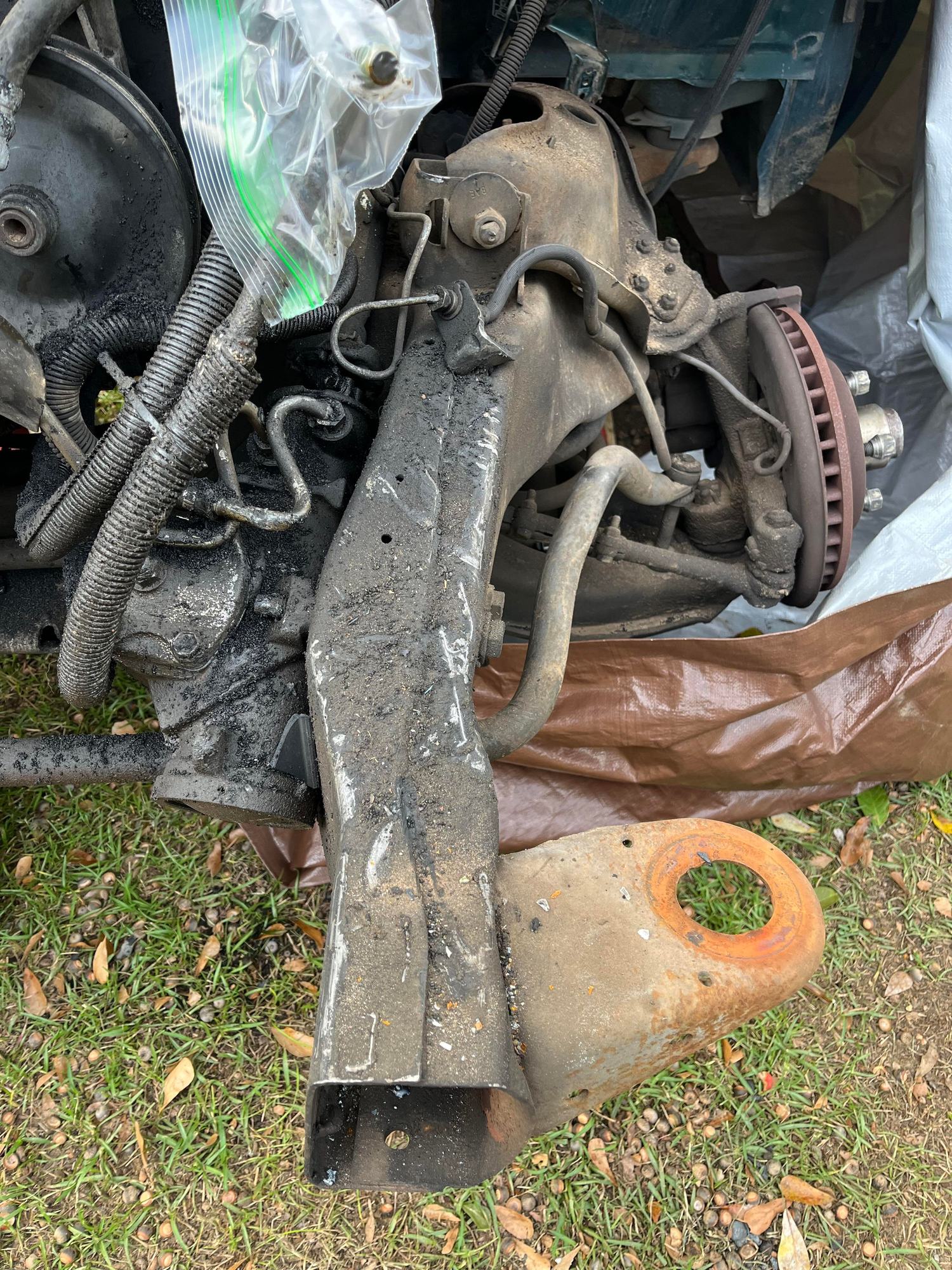

In 2017, dad passed away suddenly without warning and the truck sat until my mother let my nephew have it. She didn’t want me to have it for some unknown to me reason knowing how much I loved the truck but that’s for another day/time. Since 2018ish, my nephew has been driving it and 2 weeks ago, a guy ran a redlight and plowed him in the driver’s front wheel and front wheel forward. It pushed the entire front clip to the passenger side. So, he gave me the truck and I am going to restore it back the best I can. I have removed all the damaged sheet metal and consulted with a local frame repair shop who told me these trucks are very difficult to pull back straight and especially from the firewall forward. I was hoping to get it pulled back but now I’m not sure that is going to be an option.
· Have any of you ever had a truck of this year’s model that needed the frame straightened and if so, was it as problematic as I am being told?
My other option is I have found a clean frame locally that I can get for $80 to do a frame swap. I have been a mechanic my entire life so there is no problem with me doing frame swaps as I have done other vehicles previously. However, I have never done one this year, make and model truck. Are there any pitfalls or issues I should know about before diving into this?
· As far as sheet metal, what all year models should be looking at for junkyard replacement parts? I know these trucks run from 88-98 but I have seen some differences under the hood. The firewall and door jams so not appear to be damaged. I am not seeing any cracked paint and both doors still open and close fine.

I have no experience in this area, but I understand where you are coming from here and agree that the frame swap is probably the way to go. Having been in wrecks that totaled at least 3 cars over the years, and having tried to straighten metal myself, I agree that it would be very hard to properly straighten a frame damaged in this way.
You would have to strip things down anyway to have any hope of straightening the frame, so why not just do the swap? If you can weld, I suppose one option would be to cut the frame back under the cab area and weld in the undamaged part from the donor frame. Either way, you will need to retitle the truck as being salvaged I think.

Another question to ask - is the firewall itself damaged or pushed in? That would also be a hard thing to fix...
Thanks for your input. I have looked best I can and I am not able to find any evidence the firewall has moved. I have searched for cracked/broken paint chips, etc. and cannot see anything like that.
Also, does anyone know if the engines in these trucks are factory installed off center towards the pass side? I know some of the older Ford trucks the driveline was offset to allow for more room for the steering box. I am seeing about a 3/4"-1" offset on this truck but not sure if that was intentional or a result of the accident as shown below.

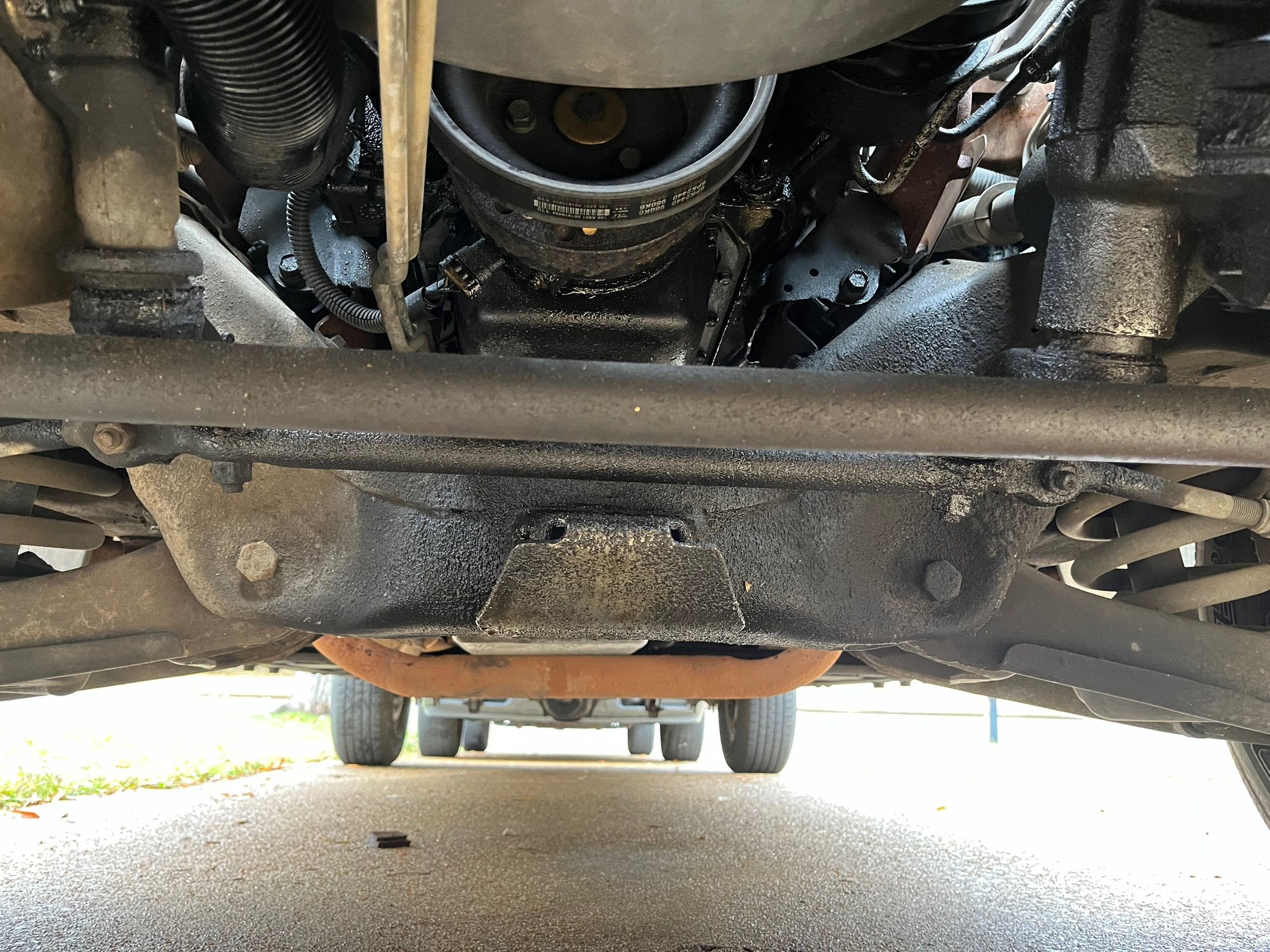

I will snap a picture under the front of my 1996 shortly and post, so you can see if the main pulley is off center from the frame.

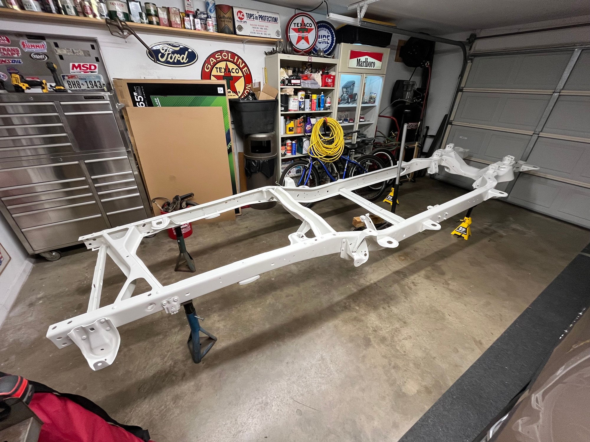

Does anyone have a frame measurement drawing to share? I picked up a frame yesterday and I would like to check it to make sure it is good before moving it on to blast and paint. Thanks

Glad you bumped this thread. I never sent that picture. Here's what I see on my 1996 C1500. It appears that the crankshaft pully is off center from the frame about 2 inches. I see this too looking at the bow-tie logo on the front grill - the fan that is mounted on the water pump pulley as well as the crank shaft pulley appear about 2 inches to left of center of the bow-tie Chevy logo on the grill and what I presume to be the center line of the truck. I centered the lens of my iPhone with the center of the bumper and the Chevy logo on the grill for this picture.
I've got some nice oil seepage on the engine there! But... it's got 203,800 miles on it and has had no major engine work done beyond replacing the intake manifold gasket twice over the years.
Unfortunately I do not have any frame measurements for you. I've got a lot going on this week, and was under the other truck (2006) on my lunch hour to make measurements of modifying my receiver hitch to fit after installing a Tommy Gate.

No worries, this is big help in knowing the offset was indeed intentional. I picked up a good rolling frame so I will be building everything up new and painted from here forward. Thanks again

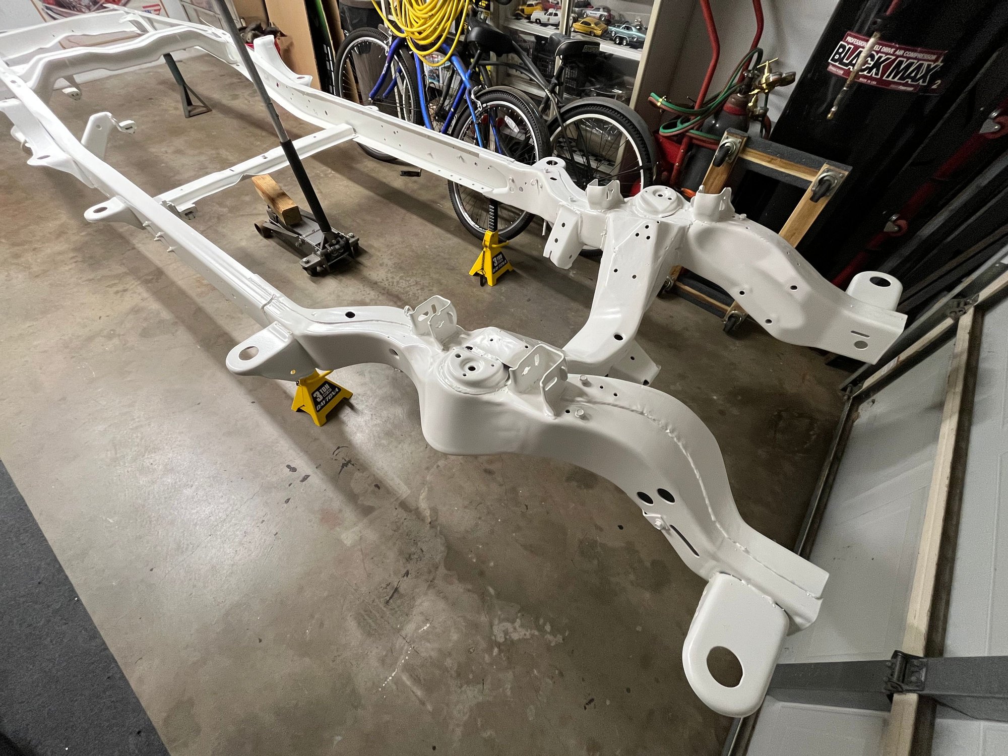

Old Feb 4, 2025 | 9:05 PM
GZM1997's Avatar
Joined: Nov 2024
Posts: 15
Likes: 5
Well, finally got a frame, had it blasted and epoxy coated. Now going to paint it black and start building everything ground up new. A lot of work but will be worth it in the long run.
