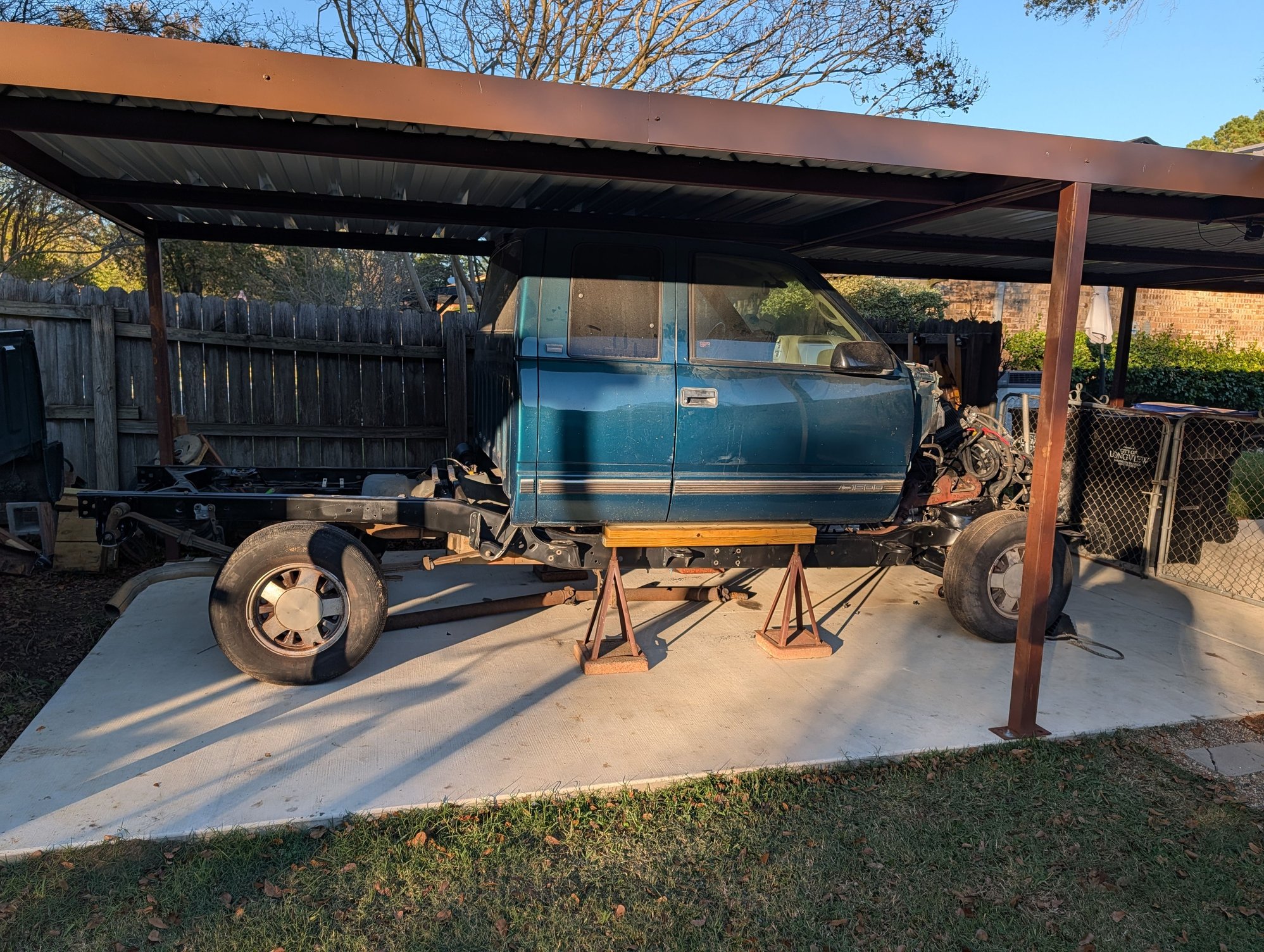

Hey guys. It has been a while since I have posted an updates. I wish I could say my health was better but between my severe arthritis in my knees, plantar facetious in my feet and a bad back, I can only work on the truck as my body permits. So, over the last few months, this is how far I have come and I must say, I am very happy with where I am right here before the weather turns colder. As you can see, I am working under a carport so when it gets too cold, I will not be doing too much to it.
I ordered a new distributor cap & rotor so when they arrive, I will install them and then set the cab on the frame. I also bought all new OEM style cab bushings from LMC. All the suspension & steering components are also new so I am hoping this truck will ride almost like when it was new. It is not a show truck so painting/detailing every piece is not practical for me since it will be semi weekly driver. Outside of repainting the front clip to match, I will probably change the wheels/tires but that will be about all I will do to it. Living in East Texas, I will also be rebuilding the entire AC system since everything is much easier to access at this point. I am so grateful to be over the hump with this project. Now if I can just get all the electrical plugs all routed and plugged back in correctly, I will be VERY happy, LOL.
On a side note, the guy I got the replacement frame from said it was a 96/97, WRONG. Turns out it is a 89. How did I find this out? Well the idler arm for a 97 does not work for this 89 frame. Also, all the exhaust hangars on this 89 frame do not work with my 97 exhaust. No big deal, just added a little more work but I have already swapped those items over so it's all good.
