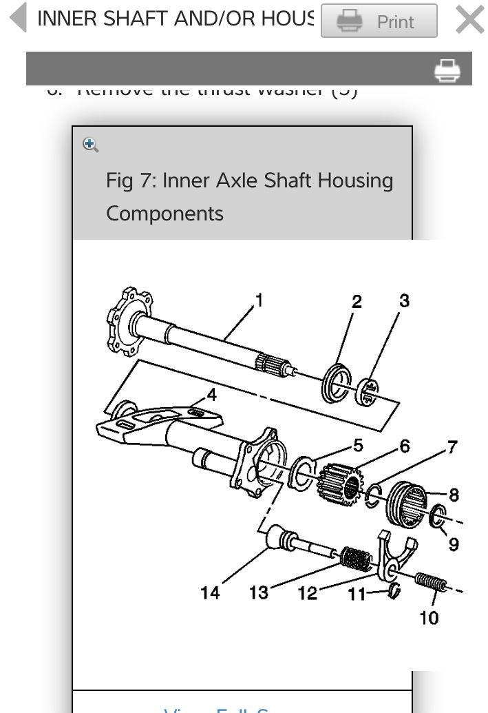

There shouldn’t be any additional parts needed unless you see damage when you have it apart.
It’s easy for some of the components to fall out of the housing, especially once the axle is removed. Here’s an exploded view in case you need it.
Right side axle assembly.
