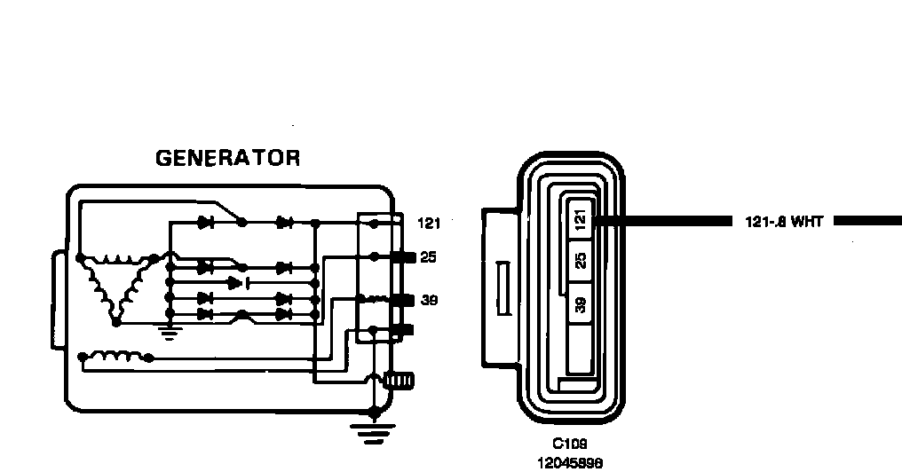

Well the fact that it works when stuff under the hood is wet to ME says it's not an issue with the cluster. He needs to trace that white wire from the alternator all the way back to where it goes through the firewall. Heck - it could be the plug on the alternator itself that is the issue. In the diagrams I saw, it is in a 4 pin connector that plugs into the alternator/generator. I am sure it goes through some other connectors before it goes through the grommet in the firewall and to the instrument cluster.
I never would have thought of the alternator being used to measure engine RPM, but I guess it makes sense, since the speed it rotates depends on engine speed. And maybe it is just a diesel thing too, since that white wire is just in the diesel wiring diagram.

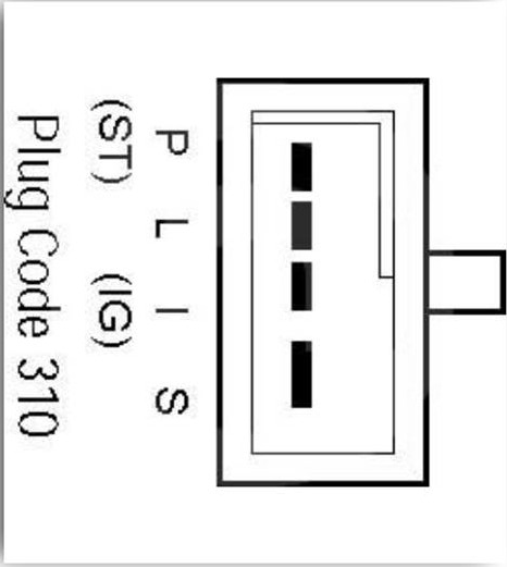

In looking at some information gathered from the folks who make the alternator, it included a few diagrams I received from them with a couple in the form of tech bulletins. The pictures received included this (turned to show true orientation when viewed from side of alternator):
Please note the way that the alternator’s connector plug is laid out. We can clearly see that the plug has four pin locations. They are labeled as in the order of P, L, I and S, top to bottom. The P can also be ST, and the I can also be IG. It is important to know what the first three do. Once I focused upon that, everything became clear.
In our research we learn that the tach is not driven by any mechanical connection, as would best and most accurately be done. Instead, it is driven by pulses it receives. Being counter-intuitive to how things aught to be, the stator of the alternator gives off pulses and in this vehicle the stator is the source of tachometer signal. It is a somewhat silly design and is counter-intuitive to what you and I might expect to see; not being directly driven. (This sad fact even mislead another mechanic early on to look at another part of the engine.)
Note that the P stands for pulse and the ST stands for stator, the L stands for lamp, the I or IG stands for ignition and the S stands for sense. This information is key.

The solution included staring at the pin-outs of the pigtail, looking in the socket of the alternator and seeing the four pins clearly existing there, and finally grasping what they were for and how it should be connected together. The existing setup was misleading, and I needed to realize that there were only two wires from the truck harness which needed to be used.
(Special mention to @jfmorris for his insight.)
Taking the cobbled-together wire connections apart, and wedging the tach wire under the plug so as to make connection with the pin in the first position, immediately got the tach working.
My friend stopped me from ordering an expensive replacement pigtail by pointing out that plug assemblies can be taken apart and metal wire inserts can be move to the correct pin locations in the plug. I started looking at that and he showed up from his home down the road from me with his fancy set of connector tools. The foam-looking filler at the outside of the plug turned out to be a solid material that was poured into the plug to seal it and looked like something a mud-dauber insect would have made. It had to be dug out, the wire connector released from its position and plugged into the other position instead. (It can be sealed with some silicone later.) No replacement pigtail needed!
The S pin is evidently not used, and there appears to be no wire from the harness for it. I have no idea what the original looked like. (Please add photo to this post if you have one of your turbo diesel setup with tach.)

What you finally figured out fits with what I saw on the wiring diagrams. They show the first 3 pins in use, but not the 4th pin, with the 1st pin being the one that ultimately drives the tach. This is from the gauge wiring diagram section of the manual on the charm.li website:
I guess you backed into that information.
I think that water must have been getting into the plug and shorting things between pin 1 and 2, when you sprayed water under the hood.

Yes, you are quite right. You found a connection between the 'generator' (as they call it in the service manual) and pin 121. Mine doesn't even seem to use the second, or lamp, pin. But to confuse it even more, note how they have the plug's holddown clip on the wrong side! It is all so very bizarre and it was quite the journey.
