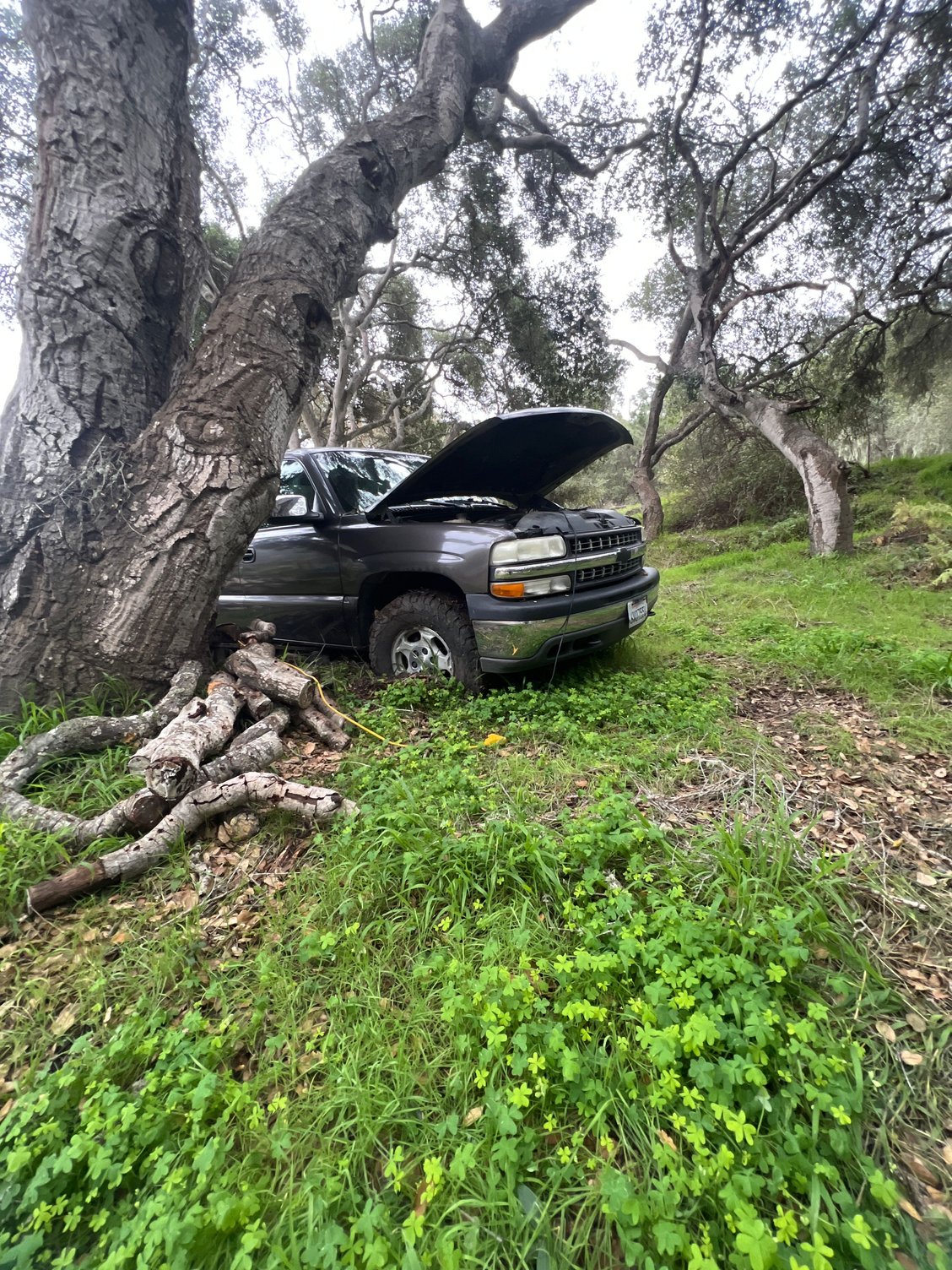

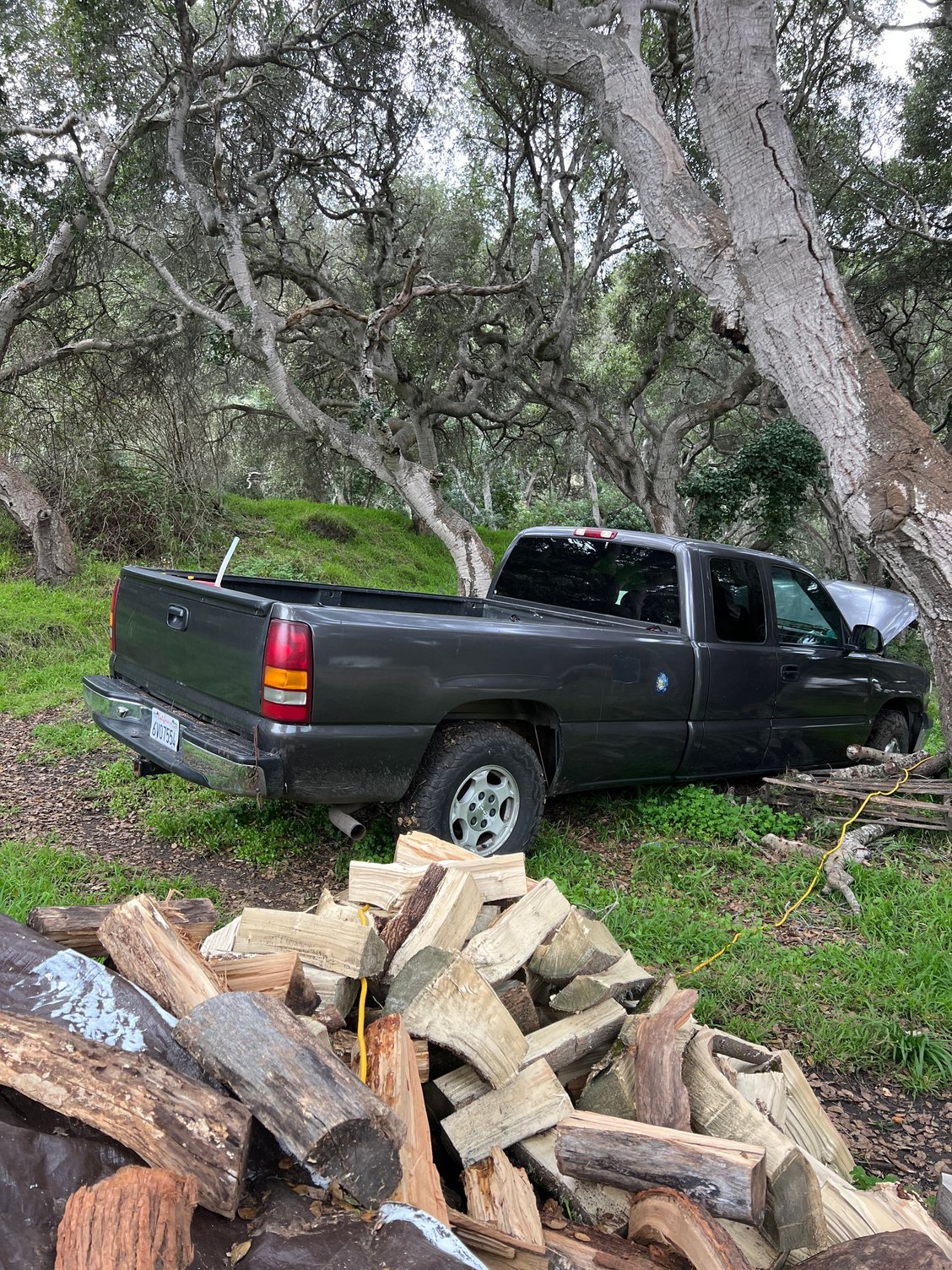

Hey guys I got a an 02 5.3 4x4 ex cab long bed. 261k, ran out of gas will idling and unloading firewood on the side of a mountain. Well, out come the Jerry cans, I added 5 gallons and gave it a crank. Motor tries to start; I’ve confirmed spark, air, and voltage are all where they should be.

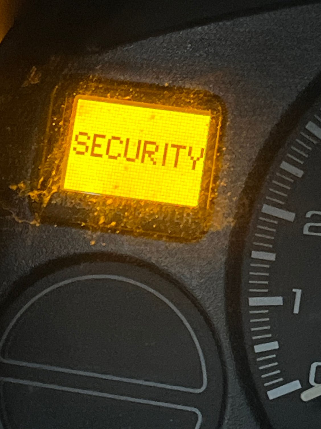

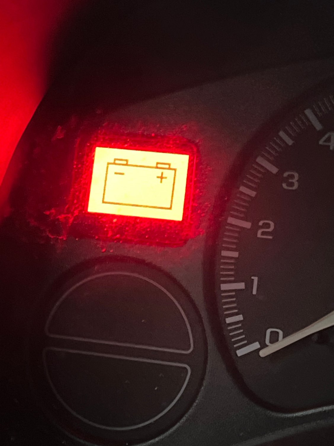

After some more observation, I have some weird stuff happening with my instrument panel. Transmission selector no longer indicates what drive mode I’m in. I also have three messages in the message center: Security, Low battery, and low fuel.

After some googling, I’ve tried a VATS reset, but my security light does not stop blinking after 10 minutes. I still tried starting at 10m intervals over the course of 30m, leaving the ignition in on, but no change in lights or function.
Other suggestions state the fuel pump or related component could be damaged/dead, but I’ve got other issues as well that lead me to think this might not be the case.
I can’t seem to pull any codes with my scan tool. This all feels like a security lock. My security light also blinks rapidly when the key is out. I replaced my battery about 3 months ago, but the truck operated fine until it died on the side of this mountain.

I’ve tried disconnecting the battery overnight. No change. I also disconnected positive and negative battery terminals and then touch them together to discharge capacitors. Also, no change. I’m about to purchase an alternator to install that, as I’ve read on another form that the error codes I’m seeing could sometimes be the result of a failed alternator
