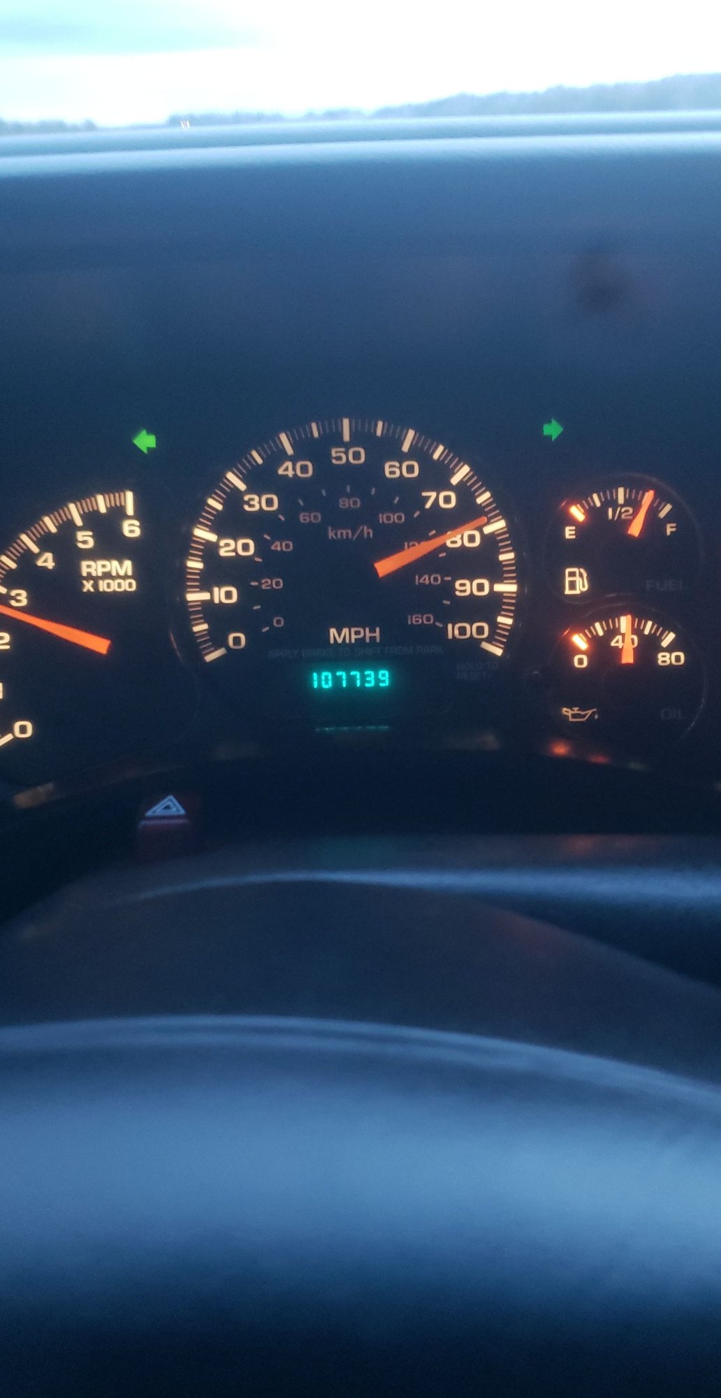

My tail lights are very Dim when i push the brake pedal it kills all the lights in the rear other than the cab light. Also with the lights on the blinker indicators are lit as shown in the picture. I just bought the pickup. 2001 silverado 2500 HD 8.1 6 speed manual 4x4. I suspect the junction box in the back. Any input?

a bad ground can cause feedback. is your speedo accurate? i mean 79 and deciding to take a pic. im kind of hoping yours is broken

My nephew took the picture while I was driving. All gauges work fine.
