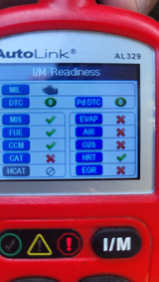

Thats a nay on that recycle drive, had my: headlights on, cargo, dome, both cabin, a/c & stereo full blast. Oh! no rear defrost on board.
on the ob2 reading? Three monitors came up incomplete: CAT, EVAP & AIR

Anyways, at the end of the driving cycle, all cleared out except (3): CAT, EVAP & AIR.
Thats were its at folks.

Update, im down to 3 IM codes
CAT
EVAP
AIR
