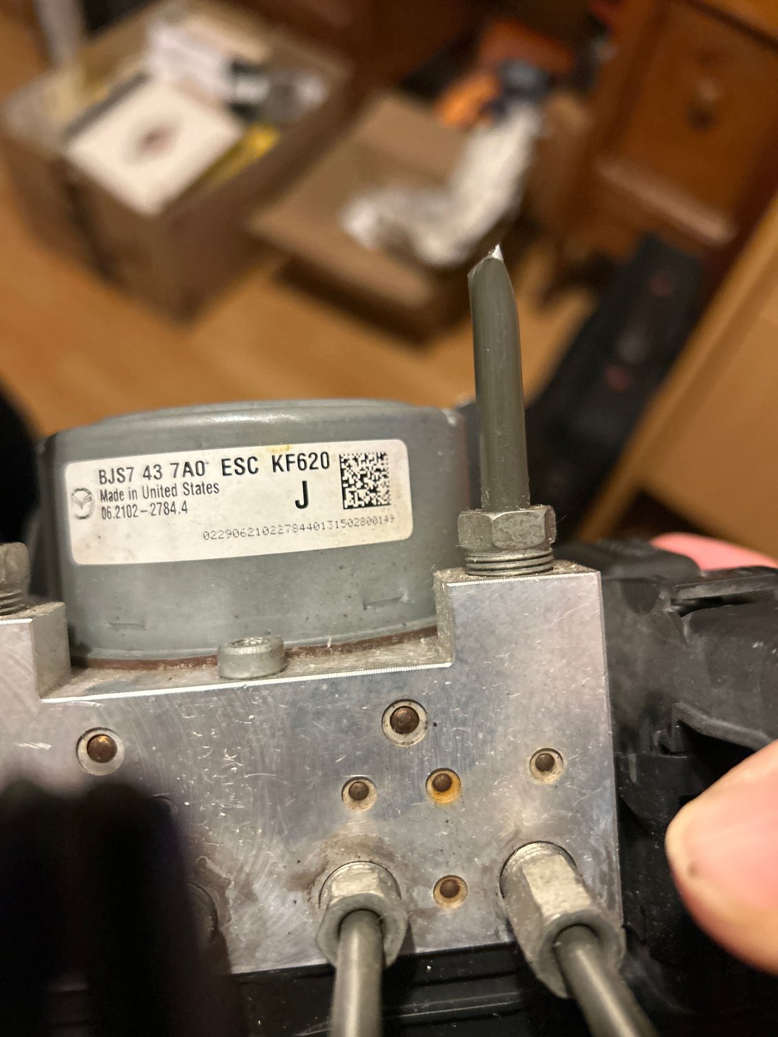

Default I have this if you think it will work
2005 Silvrado, getting the wrong module was part of my problem too. I was not able to re-program the module and ultimately called some online used parts stores and one of the places guaranteed it would fit so I bought it. Tomorrow I will look and see if I can find the parts stores I got mine from

Thanks for the store it was very helpful I order the part. They said I would have to get it programmed at the dealership. Is that the only way I have a buddy who has a real fancy snap on scanner is there any other way then the dealership?
Old Oct 28, 2025 | 8:45 AM
  #30
ycgoat's Avatar
Joined: Jul 2024
Posts: 15
From: Yorktown
I did not have to re-program mine. I expect if it was to need re-programming it would require a Tech2, but I don't think it will.
