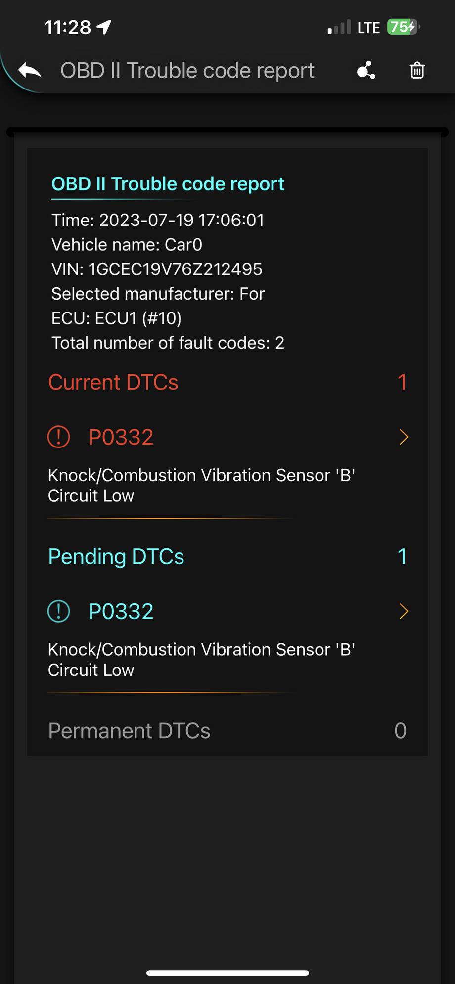

One. What OBDII codes are present? Please list them all. P0332 P0455

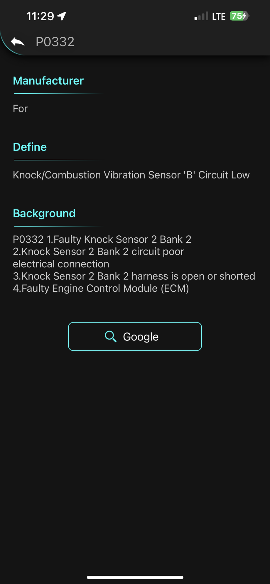

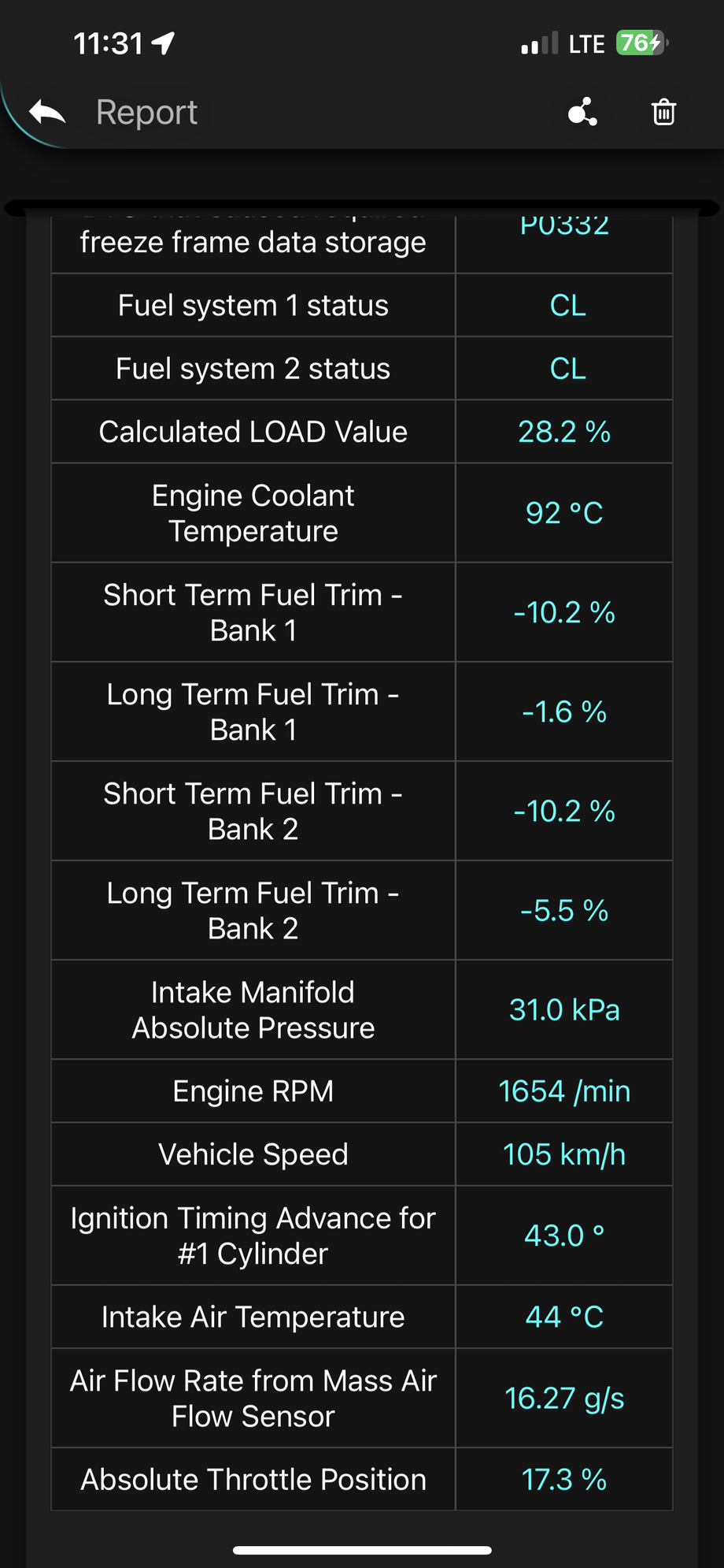

OBDll code
Freeze frame data storage
Awaiting your answers.
OBDll codes P0332 P0455

The P0332 is indicating that there is a problem with the Bank 2 (the one closest to the firewall) Knock Sensor Circuit. It could be a bad knock sensor, corroded electrical connection at the knock sensor, the engine running excessively lean due to a large vacuum leak, etc.)
The P0455 is letting you know that there is a large vacuum leak in the EVAP system.
