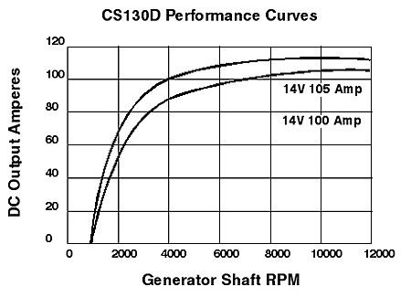

I can verify that the alternator puts out far more amperage at 2500+ RPM compared to idle, or even compared to 2000 RPM. I can do this in an interesting way I will describe below:

I believe there is something wrong with the alternator - which is a Delphi. Specifically, I believe there is something amiss in the voltage regulator inside of the alternator. All the wiring is clean, free of corrosion or debris and is not an odd length of run, it all looks just right - including the connectors, as far as I can see it. I am planning on replacing the alternator with a new 130 amp unit, but before I just go do that, I wanted to know if you had any thoughts.
