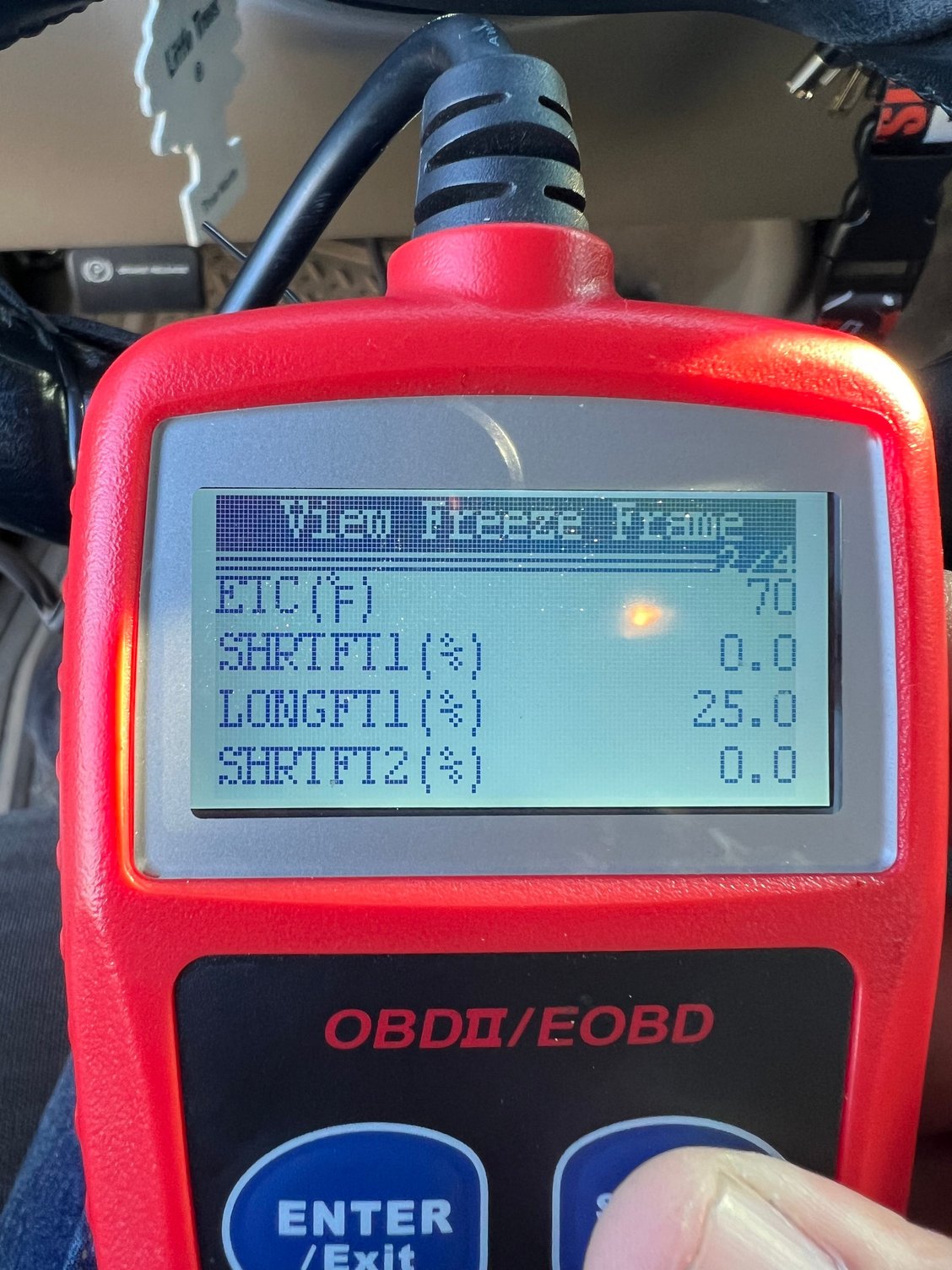

after all the work listed above it runs somewhat better but still have lean codes and misfire codes. Have just a code reader and freeze Frame shows longsft1&2 at 25% with engine at 200 degrees, spark advance is 5

I noticed a couple of things. One, Short Term Fuel Trims are not being reported, and Two, the engine temperature is showing up at 70 Deg F. Also, the engine/Fuel System is in Open Loop mode meaning that the Long Term Fuel Trim values are for all practical purposes meaningless.
What do you get when the engine is warmed up to normal operating temperature and the engine/Fuel System is in Closed Loop mode?

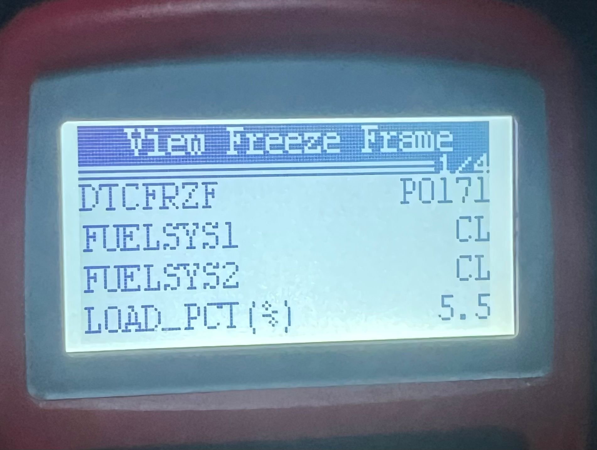

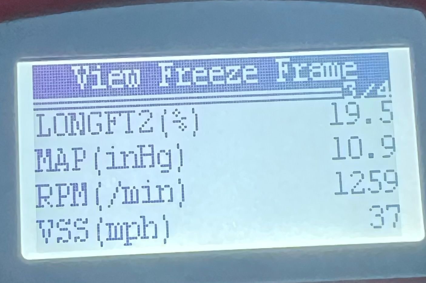

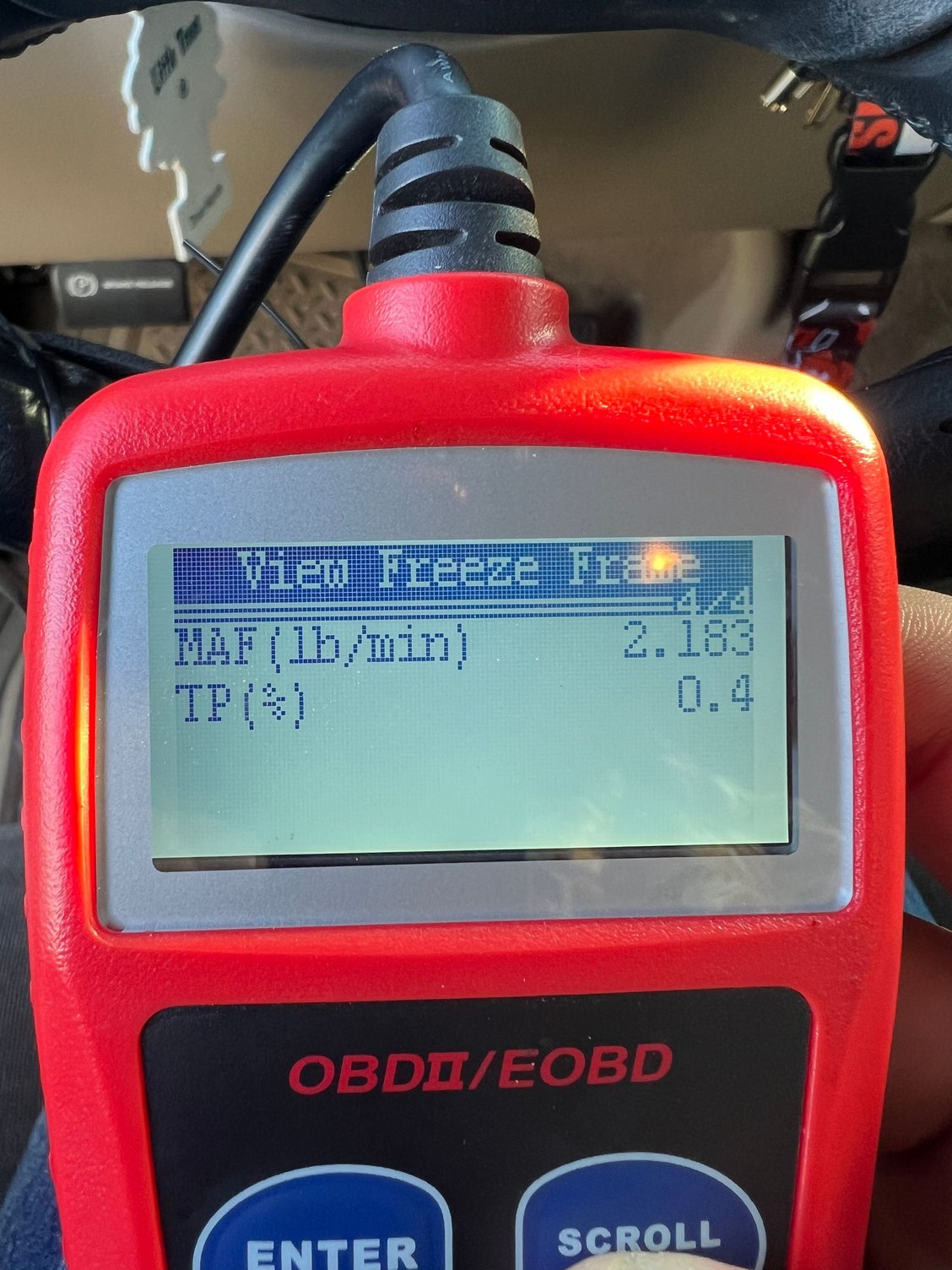

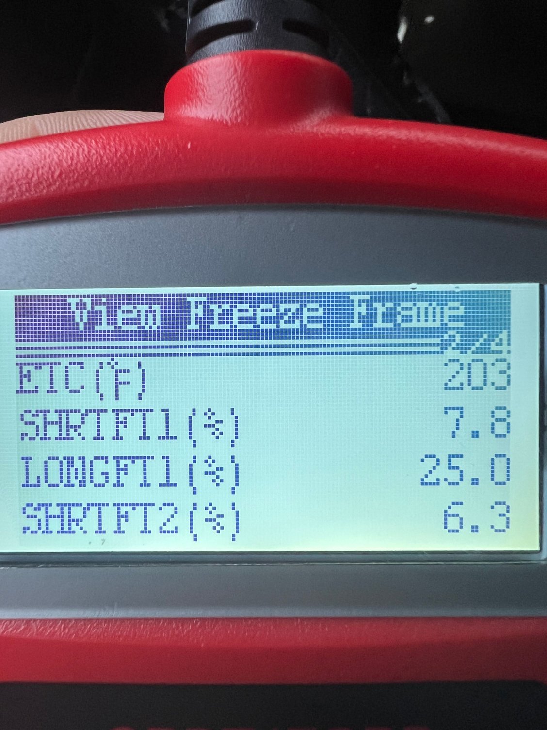

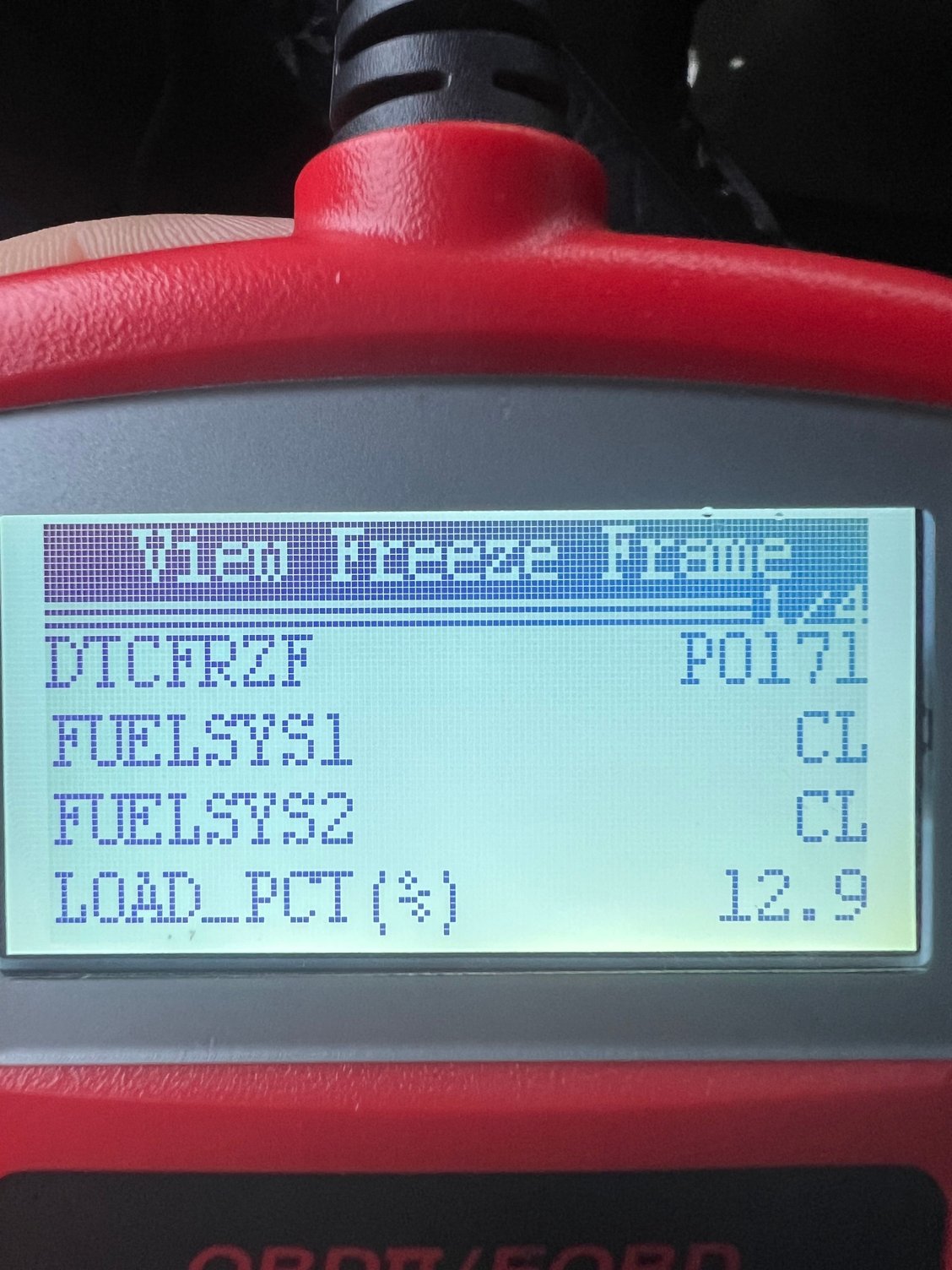

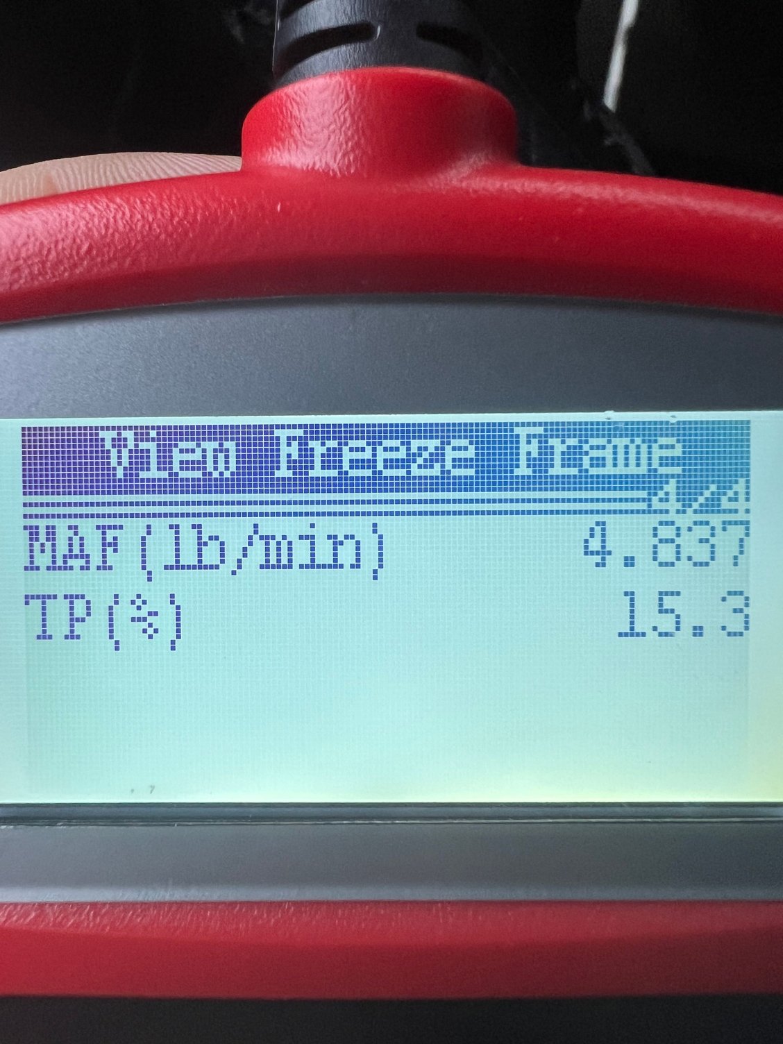

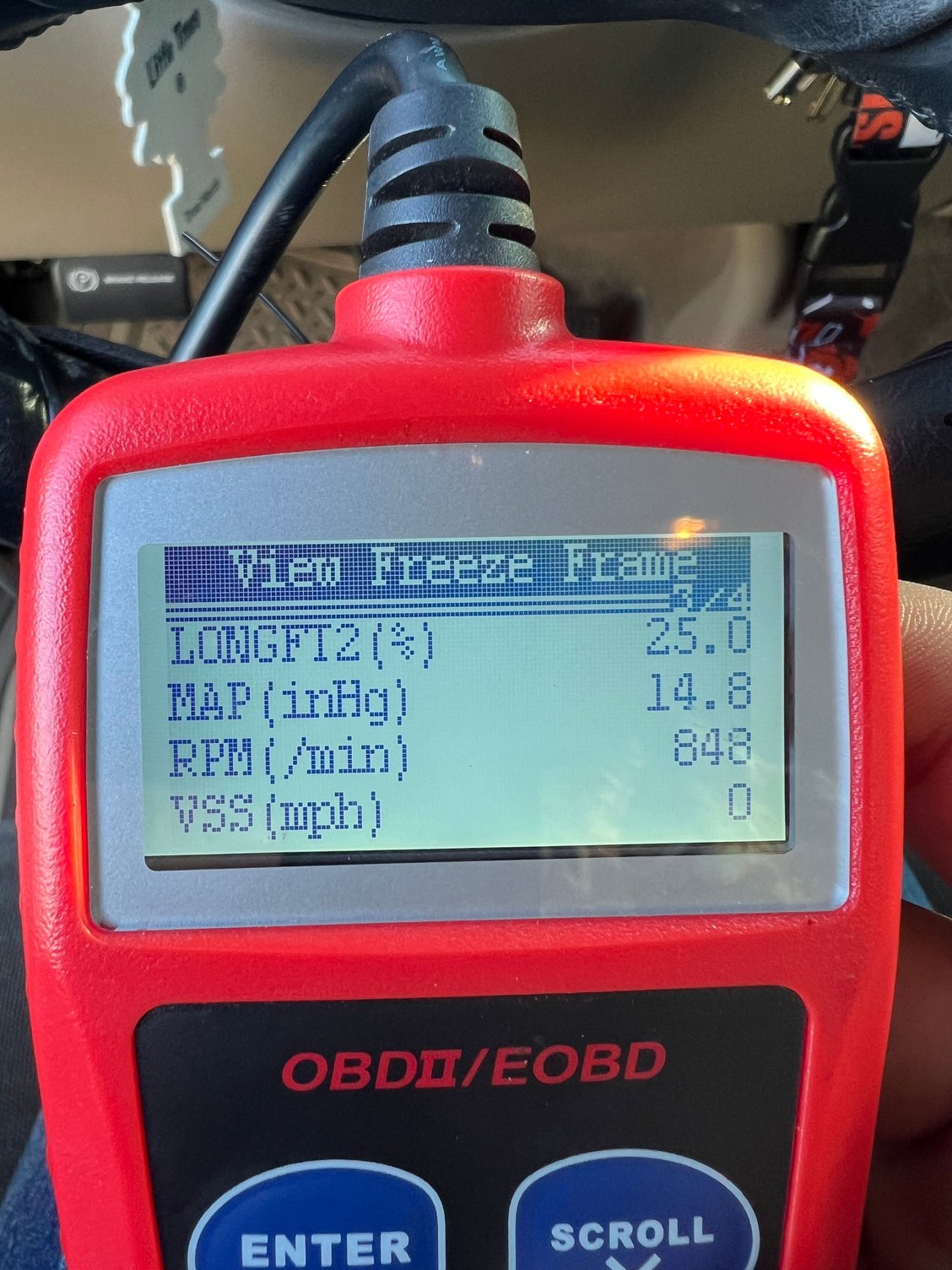

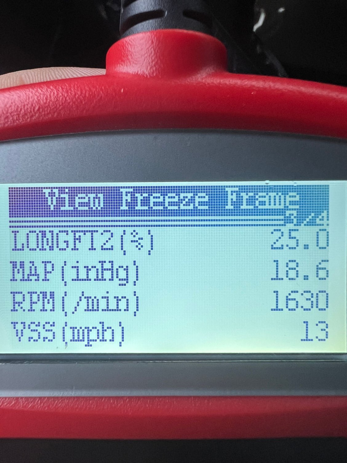

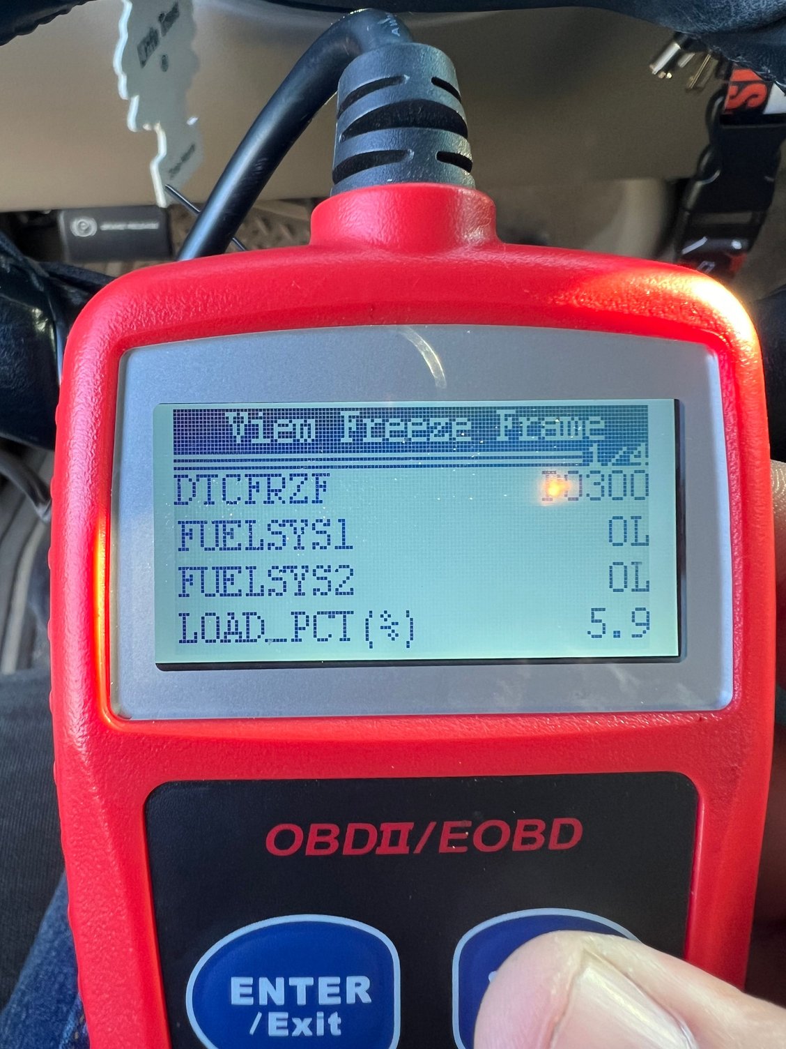

not a flex fuel engine I do have another fuel pump I pulled out of a wrecked truck I’ll throw in and see about psi change I was able to capture freeze frame at close enough to at temperature.
I was able to capture 2 sets of freeze frame data. The really zoomed in pictures at the bottom (1-3) are from at 06:30 this morning.
the first set where you can see more of the device and my finger at the top are from this afternoon at about 14:30.
I do live in the eastern shore of Maryland and has been raining today. Also since I’ve replaced the o2 sensors it seems that it may not be as sluggish and the check engine light definitely takes longer to come on today. Usually it comes on about 30 seconds from startup on a cold start but this Morning it took about 15 minutes of drive time to come on. Only showing the lean codes and misfire codes

OK on replacing the O2 sensors & being on the Eastern Shore - I'm on the other side of the Bay.
Well, according to the new pictures, you are headed in the right direction. You know have a proper engine temperature so the thermostat and Engine Coolant Temperature (ECT) Sensor are working properly. The engine is in closed loop so the ECM is using the information from the O2 sensors.
