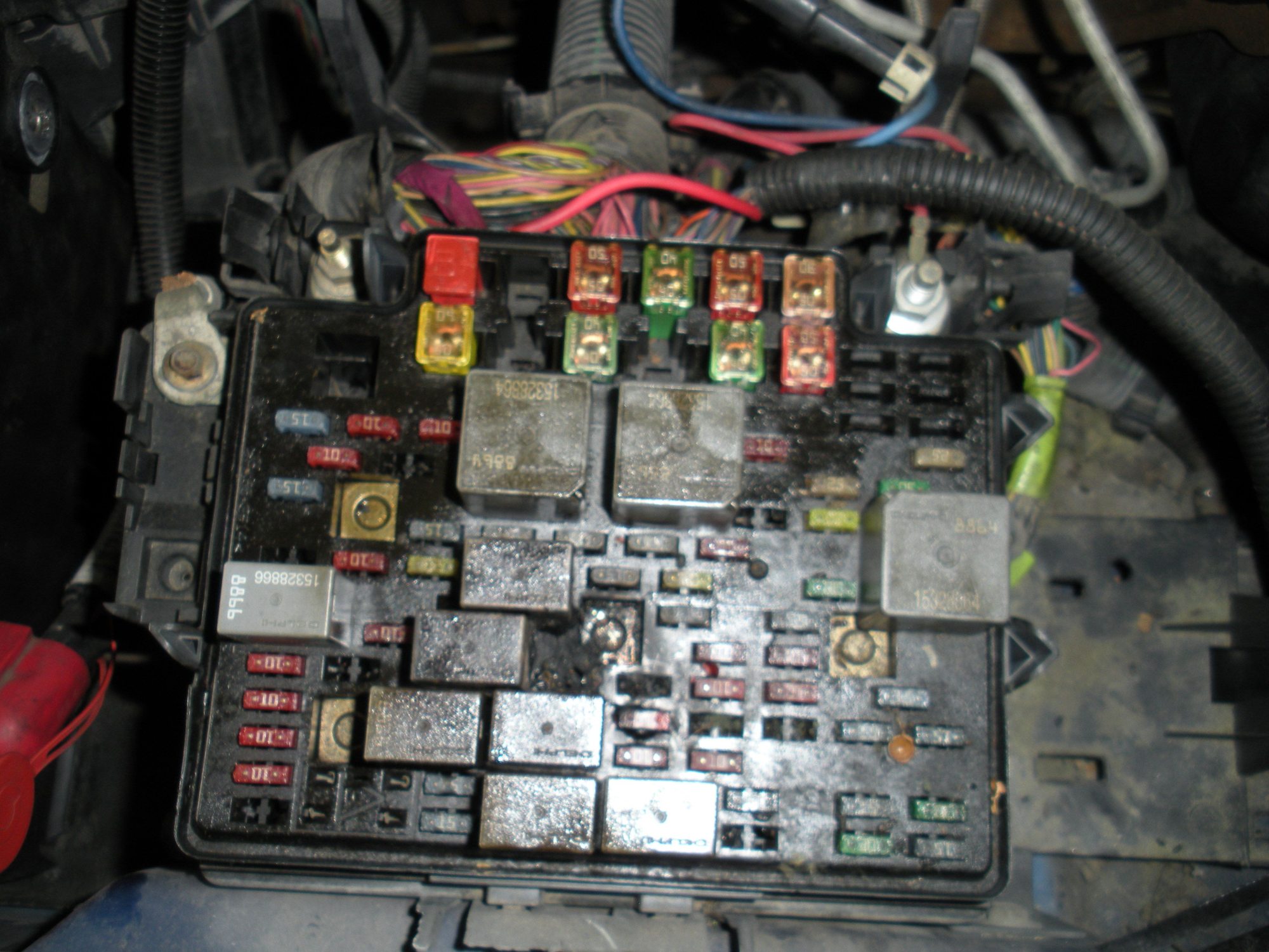

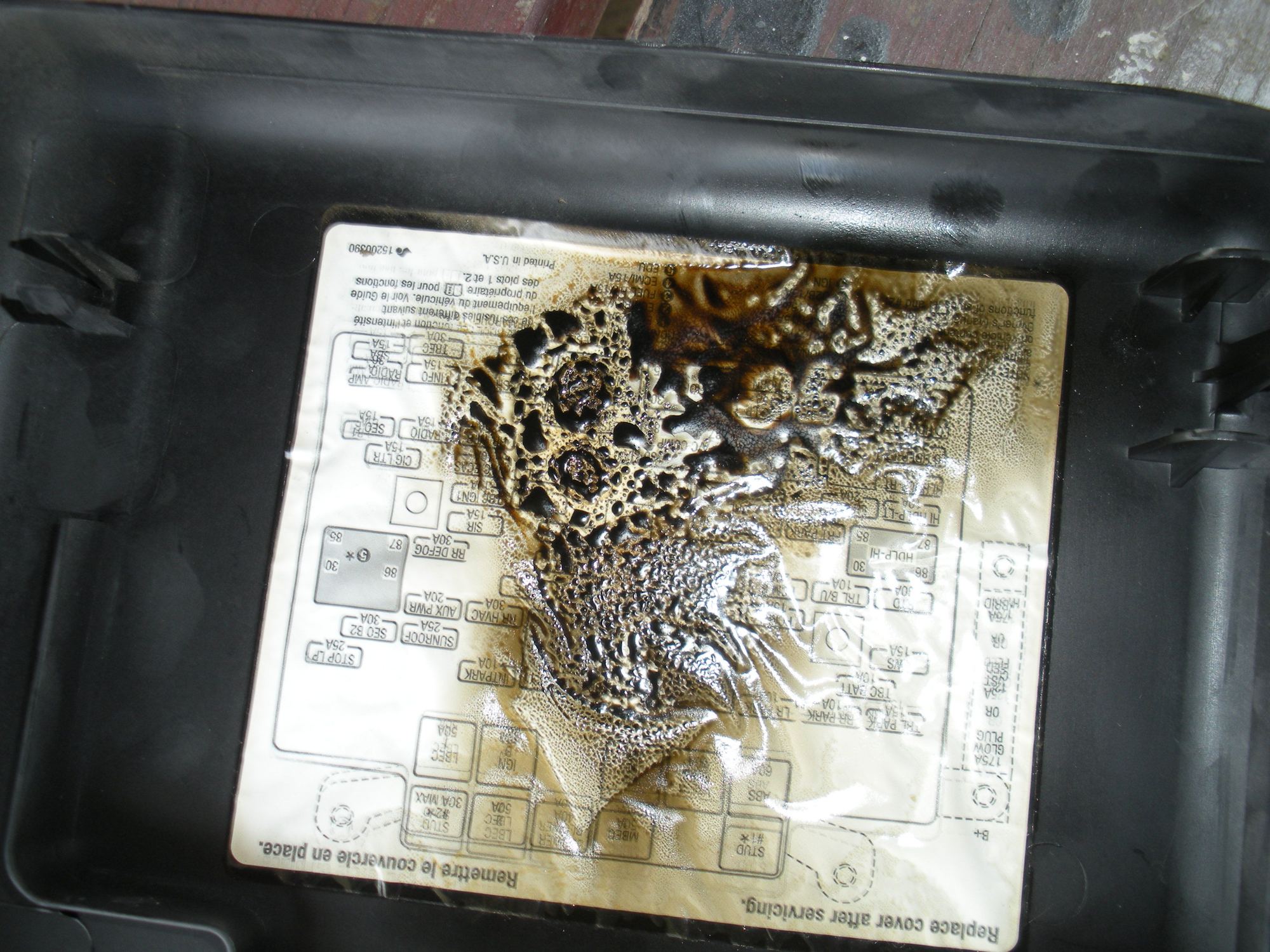

Hello; I have a 2004 Silverado WT with the 4.8 V-8. It is 4x4. About 65,000 miles. Regular cab with 8 foot bed. I have a problem and have identified the problem. Seems a rodent made a nest inside the cover of the fuse block in the engine compartment. It is the main fuse block on the drivers side. The wires are shorted out. Not sure if the wires were chewed but do know there was urine and feces all over the tops of the fuses. I could smell the burned wires/plastic as i approached the truck this morning. My first guess is the urine itself got down into the fuses and shorted them out. Second guess is wires were possibly chewed but the position of the damage makes me think the urine did it. Does not matter too much.at this point.

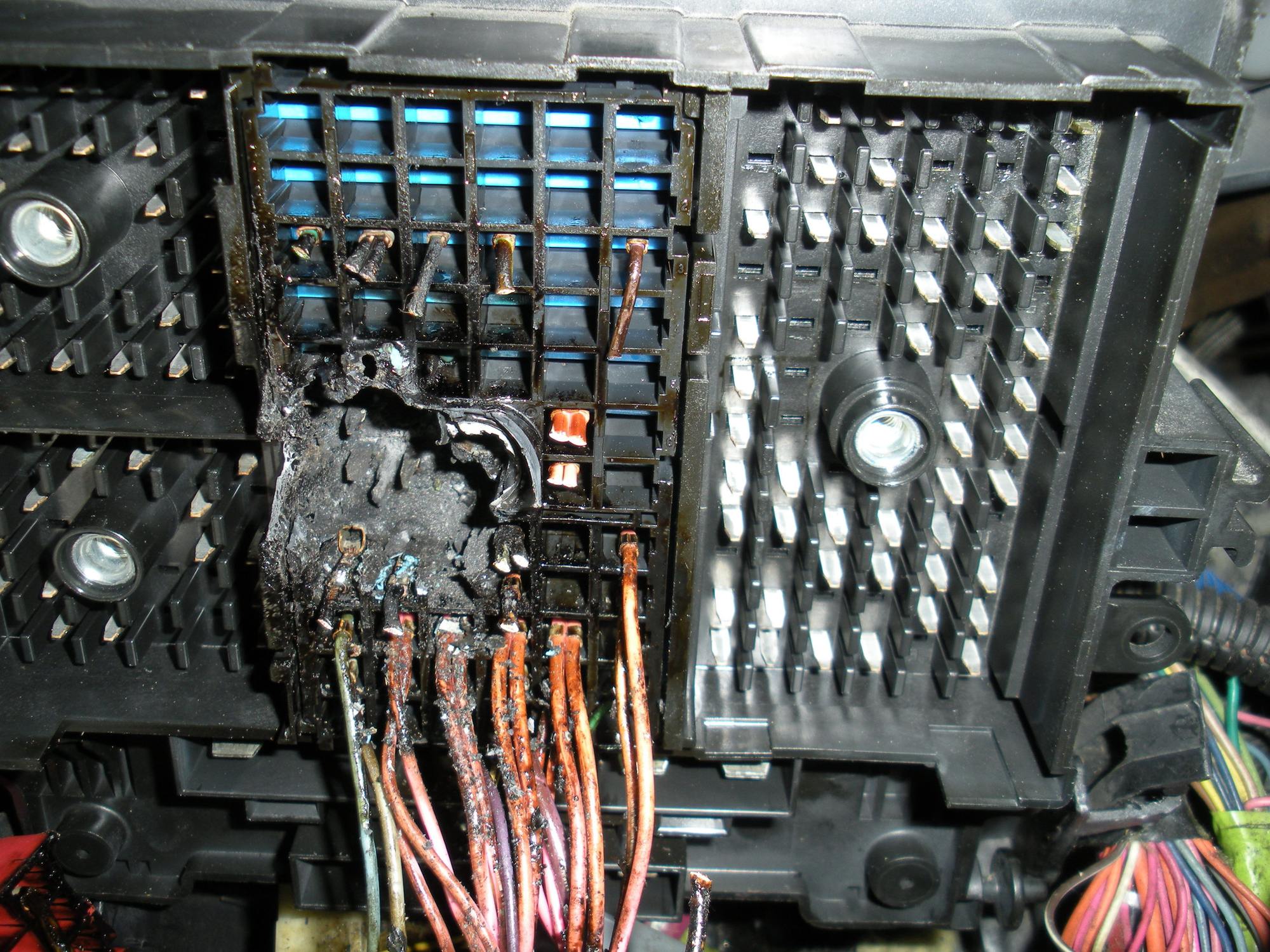

The damage is at the center section of the fuse block. The block itself is melted in one area. Some fuses were also melted. I got the cover and other part off and eventually removed the block itself. Most parts came off as they should but the wire harness plug in section in the middle was melted to the block itself. From underneath i found several damaged wires with the insulation melted away. I will try to load some pictures. There was sign the rodent got under the block as well.
I will need new fuse diagram. I may need a wiring diagram of the engine compartment.
That centrally located plug in was too damaged and i wound up having to cut the wires to remove the block from the truck. I took time and several pictures as I cut the wires. I will have to have the block itself and at least the one plug in part of the wire harness. I do not know if there is a better way to approach the repair. It occurs to me that maybe a partial or complete wire harness may be a way to go. I am open to suggestions. I also am curious if secondary damage may have happened.
underside of cover
all things in place
under before anything removed
with all but melted plug in removed
some wires cut

It's unfortunate you cut the wires at the plug. It is best to remove wires from each plug by using a terminal extractor kit. Then all you need is to buy the new plug plastic assembly and re-insert the terminals in their original locations. If your remaining harness is long enough to reach the new plastic plug housing then you just need to add new terminals to each wire and re-insert them in the plastic plug housing. The majority of electrical plastic and metal plugs used in auto's are indexed with numbers assigned to each terminal. The associated wiring diagrams will show those same numbers usually in a related connector pinout diagram. Those burnt wires in the body of the fuse block are extracted the same way however they will probably require new terminals and soldering in short lengths of replacement wire. Just Google Automotive plug repairs and wiring repairs and download some of the many guides and handbooks.

Hello; Thanks for the response. I see now some of the wires could have been removed the way you describe. Several were already burned and the insulation gone. Where the wires got hot the fuse block and the plug melted and bonded together. I do not have a terminal extractor kit nad plan to get one.
So far today I have found a used fuse block and a complete engine wiring harness at a local salvage yard. After looking at the damaged wires it seemed the better way to go about a repair. I will start swapping out the harness tomorrow.
