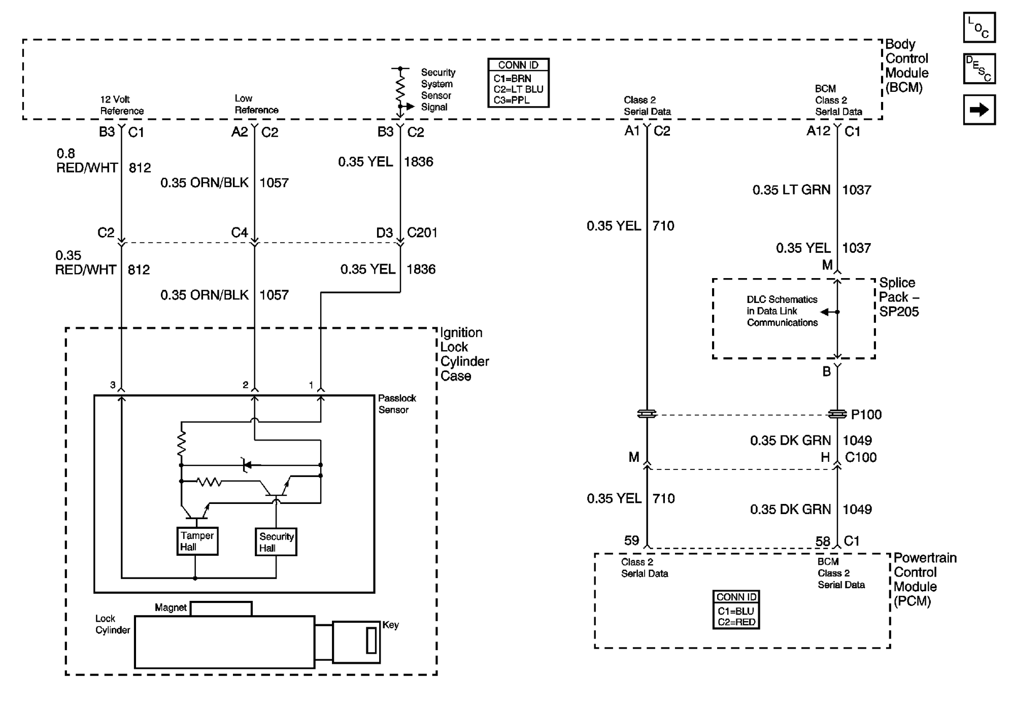

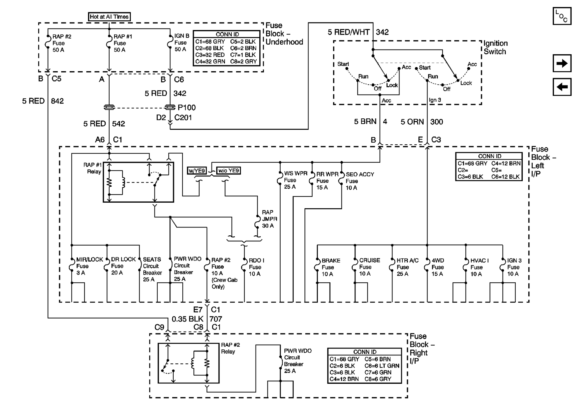

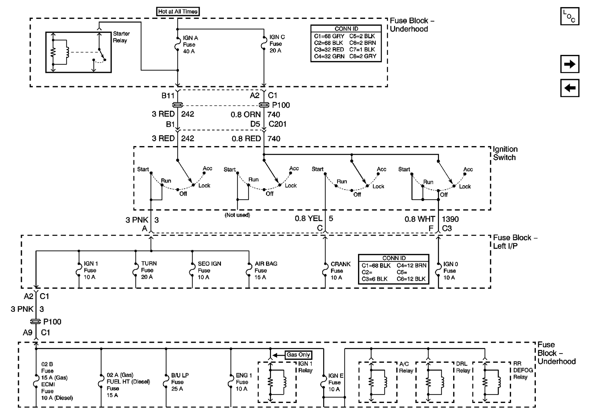

Old Oct 18, 2023 | 1:41 PM
here are your electrical schematics. You should put it back together the way it's supposed to go.
