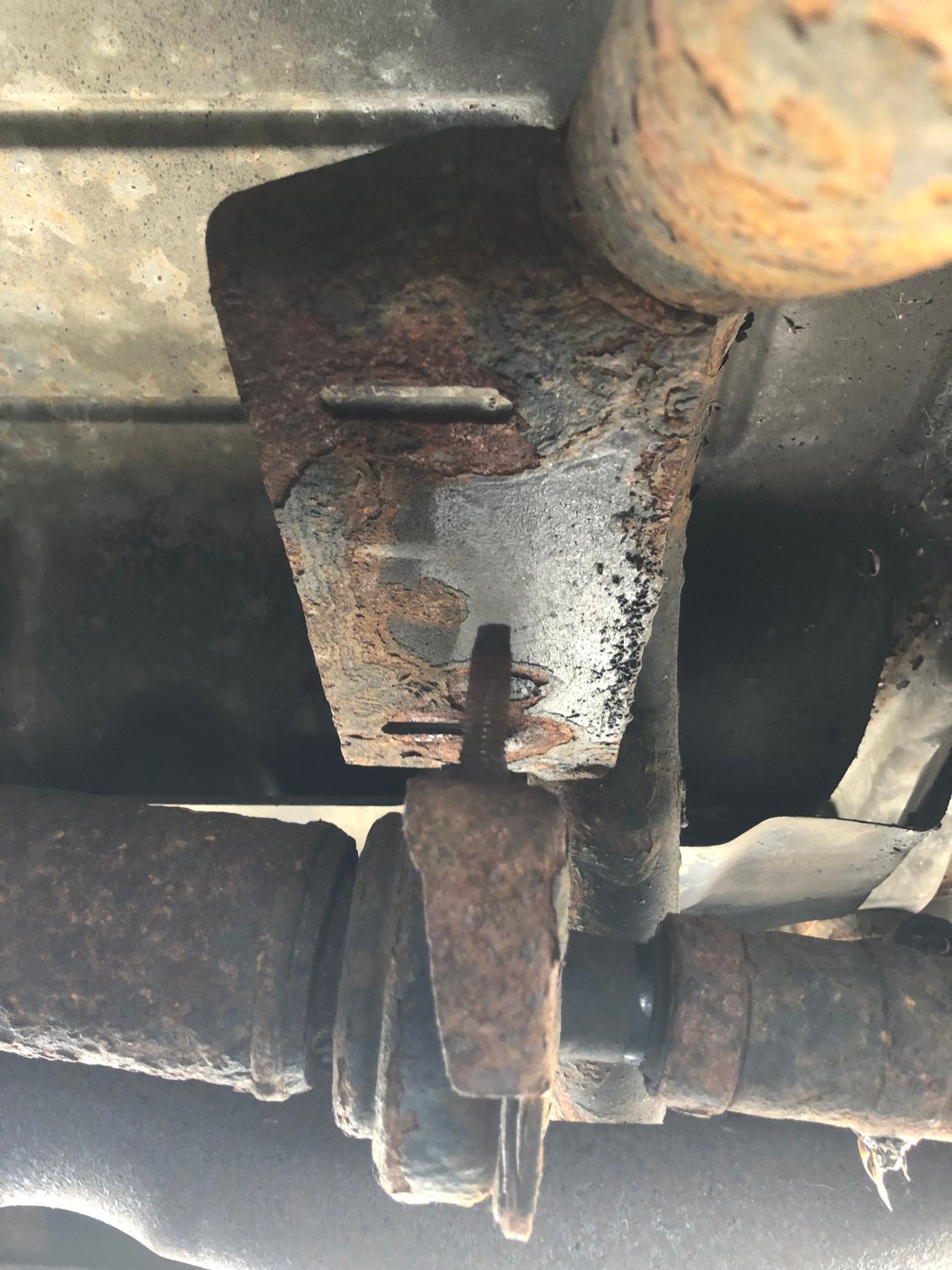

I have a 2007 Silverado Classic with 156k.
I recently had the transmission replaced (4L60e) as it wasn't shifting into 3rd or 4th.
Upon return from the local shop, I noticed a new vibration around 45mph. I called the shop and made an appointment to return it. In the meantime, I decided to investigate the drivetrain and found that the Center Support bearing (2 piece driveshaft since it's an Extended Cab) was handing by one bolt only, and only about three threads on that one bolt were all that was holding it in place. (see photo).
I re-attached the bearing and torqued to spec but the vibration was still there.
I ended up taking it back to the shop, who had it for another month and finally said, that the front yoke of the main driveshaft had bent, which required a new driveshaft as well as support bearing.
Now that I've had it back awhile, there's an intermittent vibration at 45-50mph and sometimes at 60 and above.
Just wondering what other factors might be at play, independent of the damage caused by the shop.
Should I re-balance the tires? (New Michelin's bought in 2019) for example?
Center Support Bearing ready to fall off
