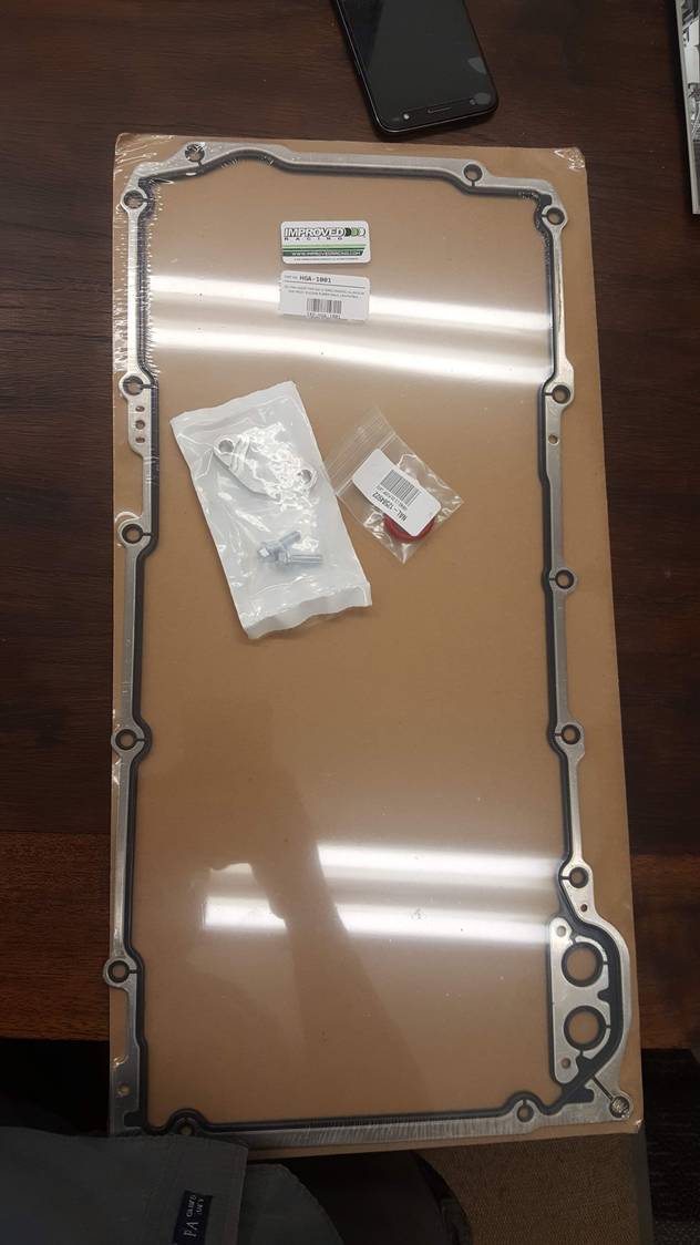

I'm going to go with my first theory and hope the pump is ok and it's just an o-ring problem. My oil pan is leaking anyways and this is giving me a good reason to swap out gaskets.
I'm sure I don't need the racing girdle thing but it makes sense to me to keep any possible vibrations down in the future. I don't see how it could hurt. We'll see what happens when I get these installed.
