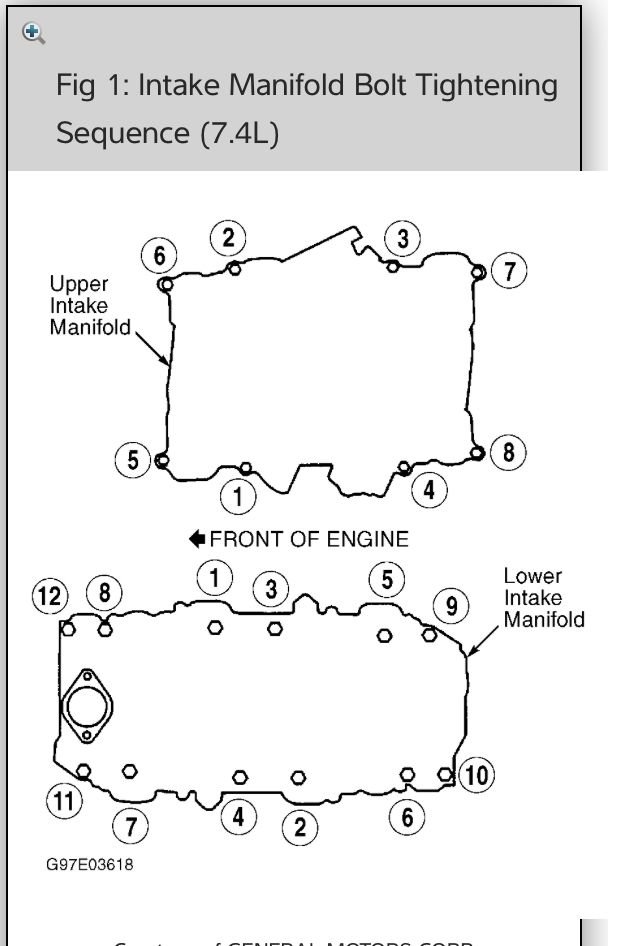

Looking for the plenum torque spec and sequence.

i think intake plenum is 24 ft-lb if i remember correctly that's what i did on mine. about two fingers tight on a mini-wratchet. don't over-tighten ... any kind of rubber seal over-tightened may not seal correctly. it's plastic - over-tightening plastic can warp the plastic. they are easily accessible - no big penalty for not over-tightening if you need to re-tighten later.

Intake Plenum Bolts ... 25 N·m ... 18 lb ft

Lower intake:
Stage 1 - 22 ft-lbs
Stage 2 - 30 ft-lbs
Upper Intake:
Stage 1 - 6 ft-lbs
Stage 2 - 13 ft-lbs
