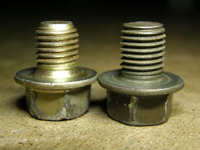

Old Jul 7, 2025 | 5:59 AM
L84sky's Avatar
Joined: Oct 2018
Likes: 157
Just to update this thread: the two flex plate bolts are NOT the same. The type 1 bolt is used to center the flex plate on the torque converter. The type 2 bolts hold the flex plate in position.
Type 1 bolt on the left. Type 2 bolt on the right.
