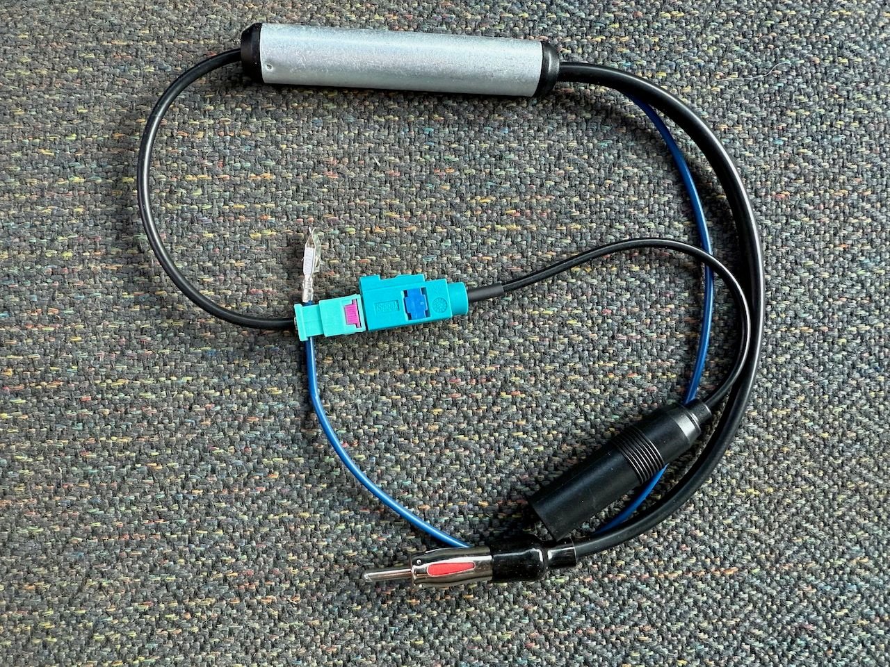

Here is a picture on the seat of the Silverado before I installed behind the radio. I added this between the radio and the Metra 40-GM10 that was already in there from Saturday's install.
I ended up connecting the blue wire on this to an unused red accessory wire in the pre-made wiring harness from Crutchfield, that was for a dangling connector to steering wheel mounted controls my truck doesn't have. Otherwise I would have cut the blue/white wire from the radio and spliced to it. Crutchfield had routed that to the connector for the factory harness, but it was an unused pin. I just skipped it as it was buried in the braid/wrap around the harness they made.
I hope this helps someone else who wonders why their AM radio stops working when they replace the factory unit in their GM truck or car! And I am kinda ticked I had to research this and work on it, and that Crutchfield, Metra and other folks that DEAL with car audio for a living don't know to give us a harness that supplies the 12Vdc to the antenna wire that the factory radio supplied.
