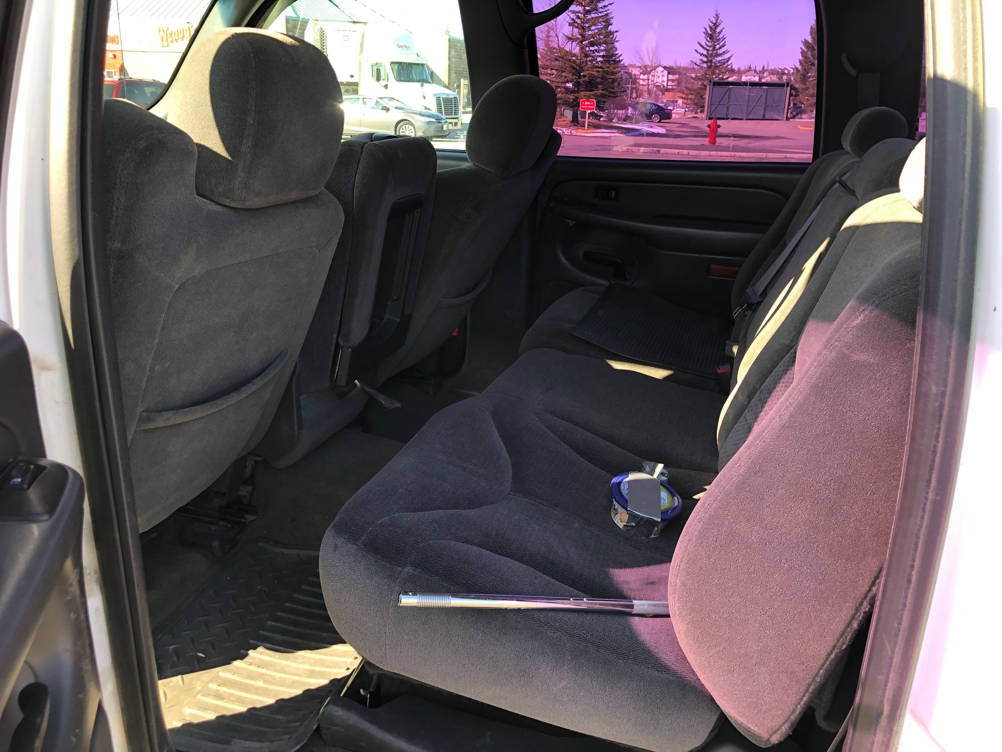

here are pics. she isnt clean but shes got a great foundation.

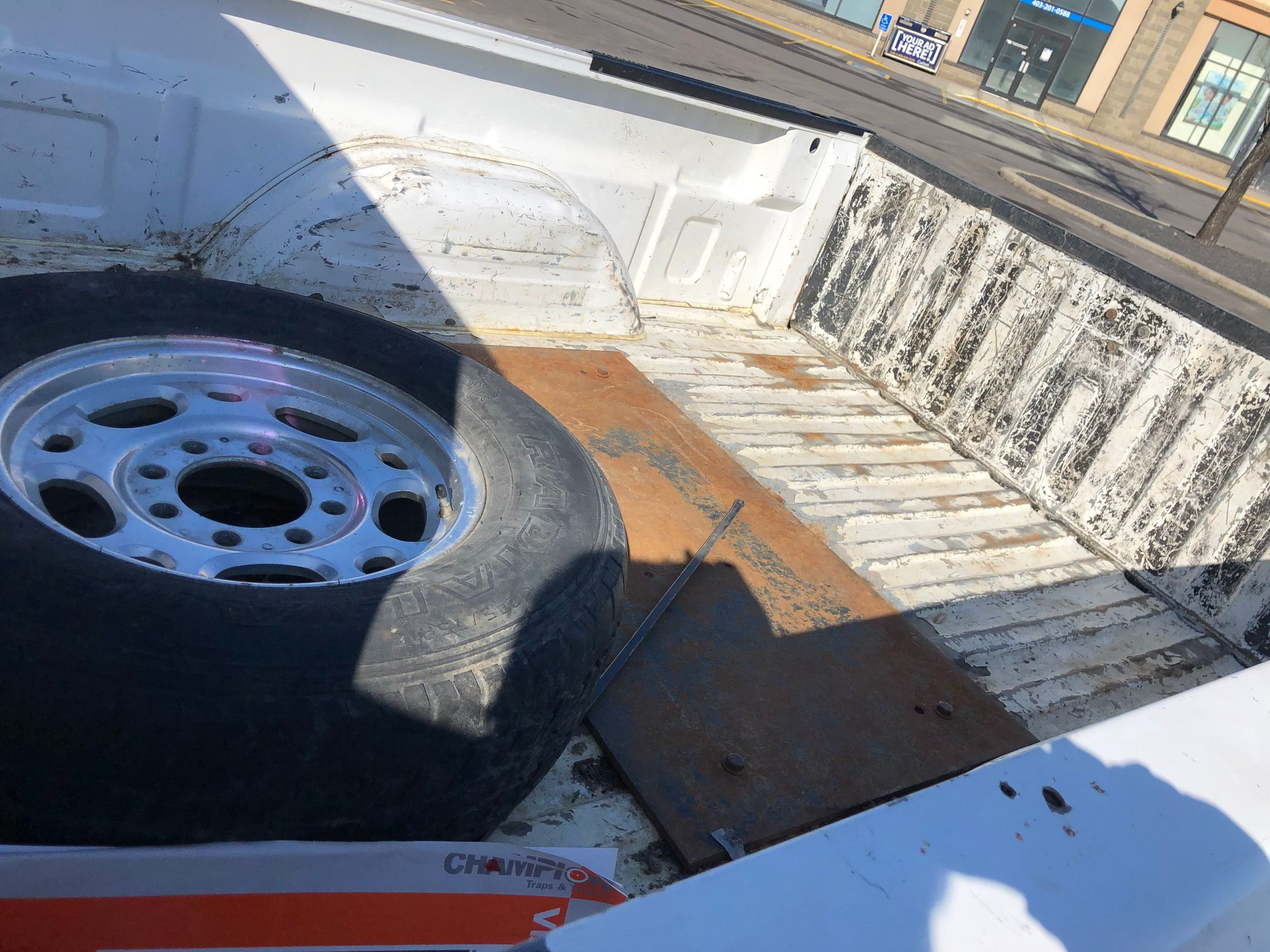

you will see prior owner had a 5th wheel installed on this 3/8 plate. we will be removing that.

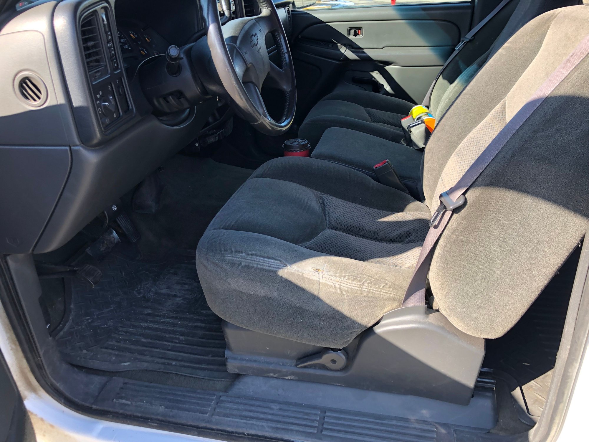

ib5. driver seat cushion and cloth cover replacement. colour is grey with a dotted pattern inset. need new cushion and cover.
I’m not sure what’s available from GM/aftermarket for this, but we’ve had customer seats repaired at local upholstery shops for $100-$200 depending on what needed to be done.

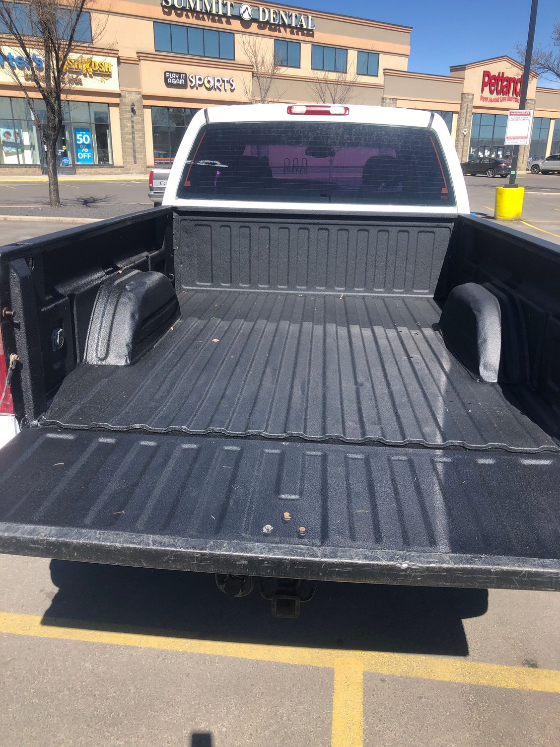

ib7. diy the bed liner. need to find which is best.
Most of our customers use a plastic drop in liner or bed mat. In terms of corrosion protection, both seem to do well. No experience with spray on liners, DIY or professional.

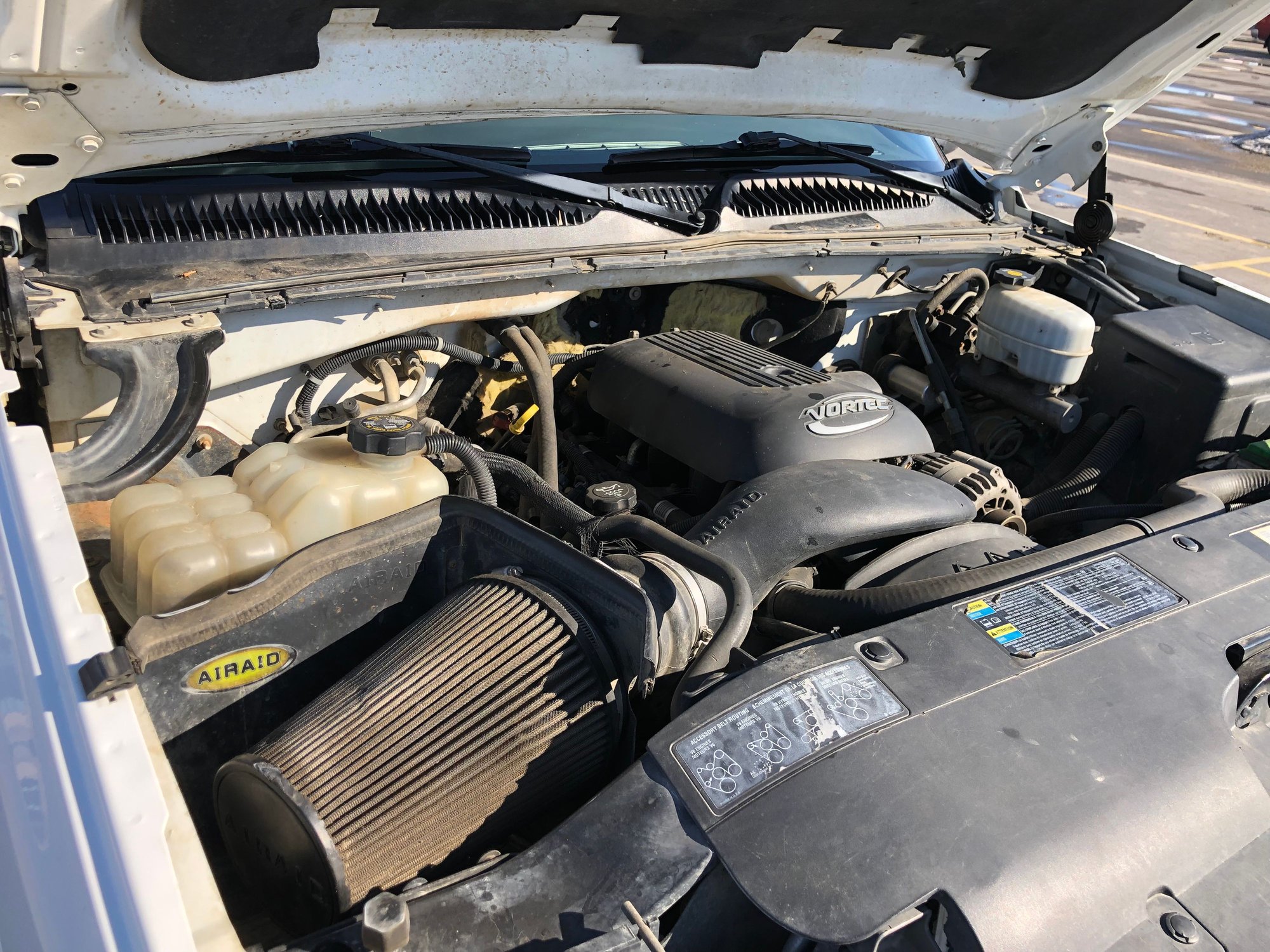

m5. we are on a dusty road off the main highway and id like to see if i can install the injector shrouds/covers like on my denali and escalade.
Not sure what you mean here - your pic of the engine bay shows a cover already on it. But as for living on a dusty road, you’ll want to consider relocating the EVAP canister fresh air filter to the engine bay. The factory mounted them above the filler neck inside the bed panel but dirt collects inside them. For anybody living on paved roads it’s not usually a problem; but living on gravel, it eventually builds up to the point that it can ruin the vent valve and possibly the canister depending on how much dirt gets pulled into it. We just relocate them to the engine bay near the brake booster (I prefer the corner behind the booster) using a length of heater hose to reach back to the vent valve, then zip tie everything in place.
m6. anybody want to trade for airaid intake? id like to go back to stock.
You should be able to easily find a stock air box and tube at a salvage yard.

So we prepped and installed ez liner bed liner. it was a dream. so easy. used an old undercoating gun i had.

Bed liner looks good - hopefully it holds up.
