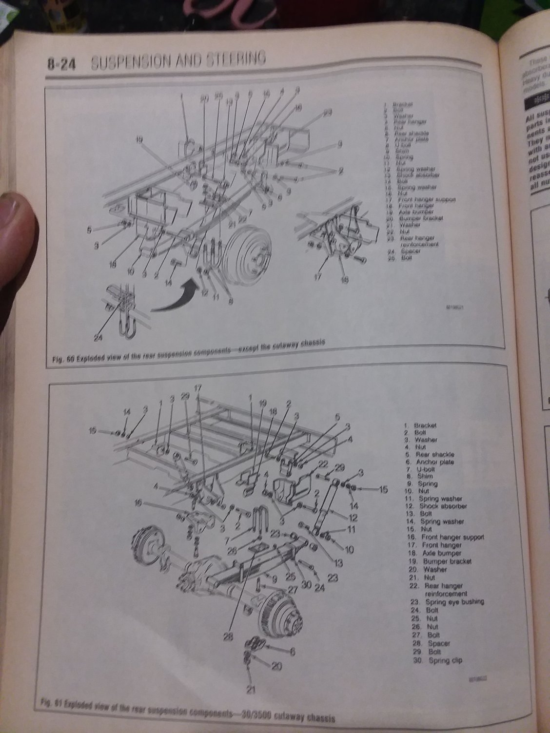

'87-97 models are covered in my chilton. Hope it helps in some way.
Great!! Thanks!!!
