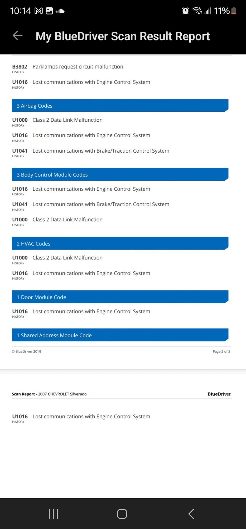

I was unable to hook up an odb2 because it wasnt communicating at all. The PCMb 20amp fuse blew, so i swapped it out, turned the key and it blew again immediately. I then put it a 30 amp fuse to bypass it temporarily, and was able to get this reading.
sounds like there's an overloaded circuit that you need to find. Look for damaged wires/connectors. It won't be easy unfortunately.
There a schematics on charm.li that can help.
