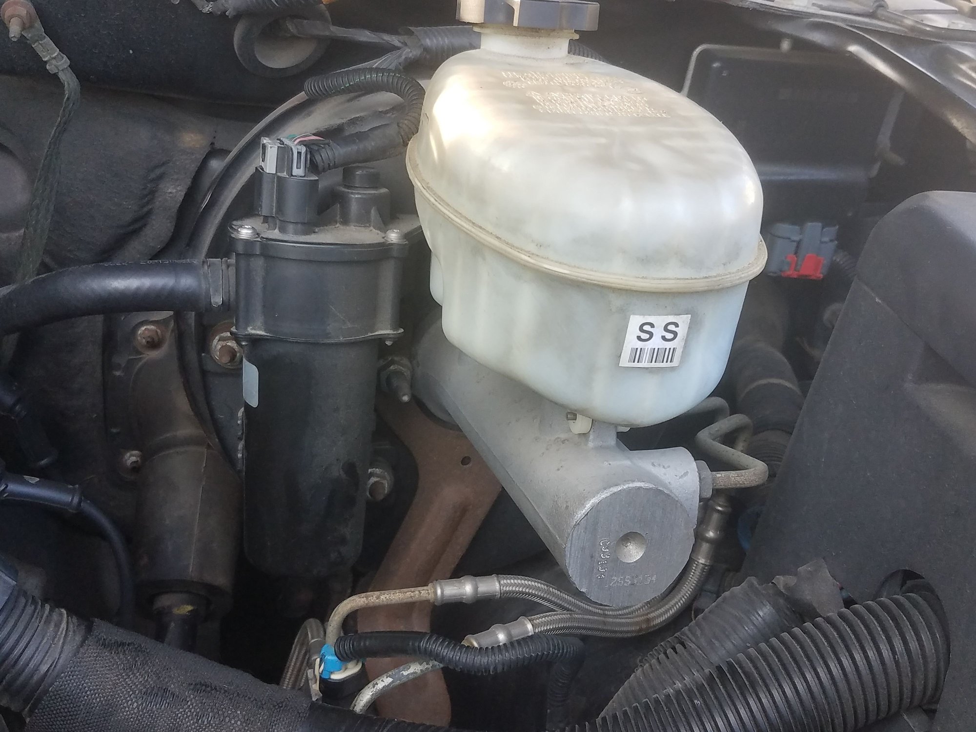

Does anyone know what this is? I have been around, working on, selling parts for Vehicles for the better part of 30+ years and I have yet to come across anything that looks like this. It's on my 03 Silverado 1500 with a 5.3L.

electric vacuum pump. vehicles with low engine vacuum ie diesel cars or gas vvt need help with booster vacuum.
