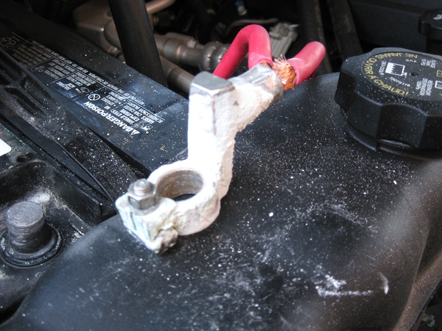

Old Mar 10, 2012 | 6:32 PM
  #45
Tyler.T's Avatar
Joined: Mar 2012
From: LAS VEGAS
Default Replaced Bat and cable end
Thanks Finback. I replaced the battery and the end of my battery cable today. I'm defiantly thinking it was the end if the cable as it was completely covered in corrosion. I did the battery because it was another potential problem, the + terminal was loose plus I didn't have to turn the battery around to hook up the new cables.
My last little note is that in eight hours at the dealership yesterday they did not notice my battery cable. Seriously???
Thanks for the help all, I will fallow up periodically to let you know if the ghost comes back.
Tyler

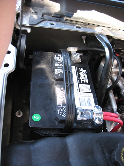

Old Mar 10, 2012 | 6:51 PM
  #46
Tyler.T's Avatar
Joined: Mar 2012
From: LAS VEGAS
Heres a few pics
Attached Thumbnails 2008 silverado 1500 big problems.-post1.jpg   2008 silverado 1500 big problems.-post2.jpg   2008 silverado 1500 big problems.-post3.jpg
