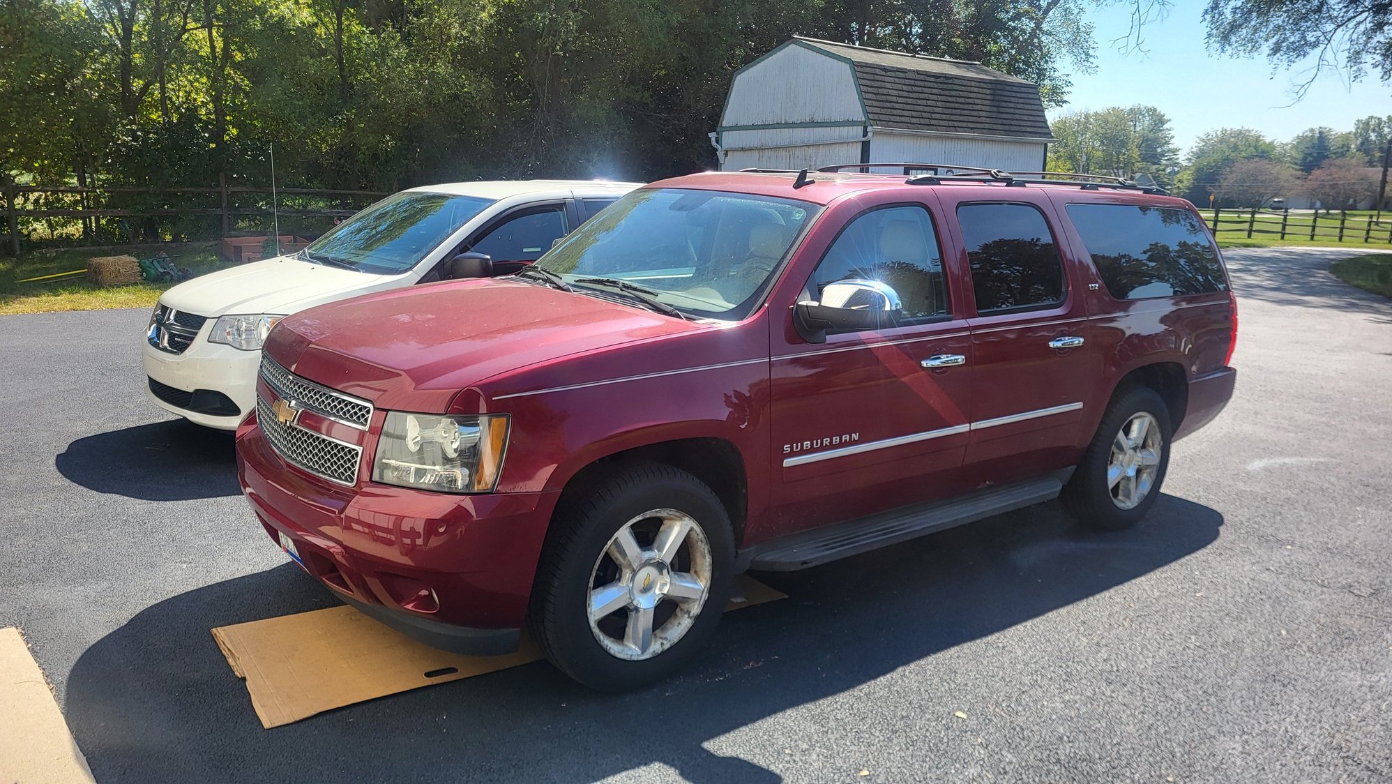

Looking for any insight anyone has, have a 2010 suburban 5.3 and the tachometer doesn't work. I already replaced the crank sensor with an oem unit. Wiring was undamaged. The gauge sweeps at startup so I believe the gauge is fine. Truck also has no acceleration but is fine once youre going and shifts hard out of first. Ive seen a couple threads here where people had the same issue but never saw a fix. Any help would be greatly appreciated!
