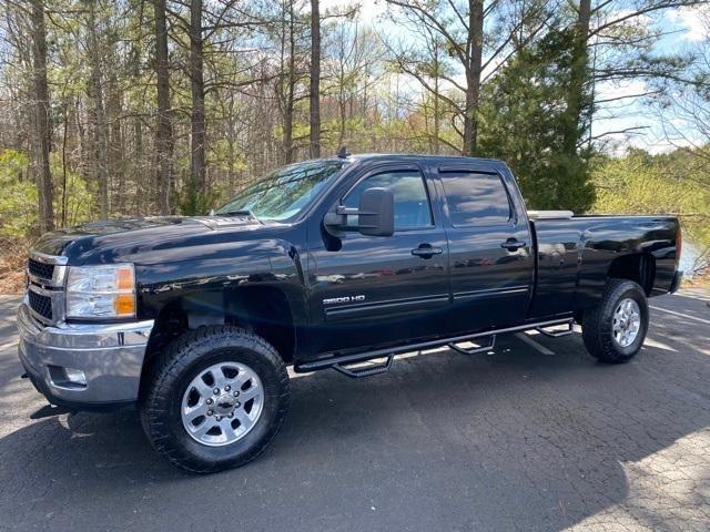

thinking about trading in the gas motor truck for a diesel. i know the afm on the gas motors have issues but i know nothing about the 6.6 diesels, anyone know of what to keep an eye out for? truck has about 150k.

may i wasnt hoping to hear that from someone especially you. truck looks nice but as you can see in the last two pictures some mods have been done. i dont know what theyre but i see an obdII connection in the center console and im not sure what the gauges and switches are for, maybe airbags? then you have the **** with 1,2 and 3 settings. never seen that

DEF systems on light duty diesels started in 2010, so a 2012 SHOULD have the system, but it could’ve been deleted if it’s not in a state that requires emissions testing.
Those pictures - the gauge looks like a boost gauge (I can’t zoom in close enough to see the details) but if those are switches on either side of it, it could also be a gauge for an air suspension system.
The **** on the dash with the 1 2 3 on it is a tuner **** - looks like the controller/monitor is behind the gauge. I don’t know exactly how they work, but you’d select a number depending on what performance you want (may also depend on make - I just don’t know enough about them).
If you get a diesel, stay away from this one - there’s no telling what kind of hack job was done on the wiring to install the tuner or the problems it’s causing.

well thats two that say no, so ill pass. thank you guys
